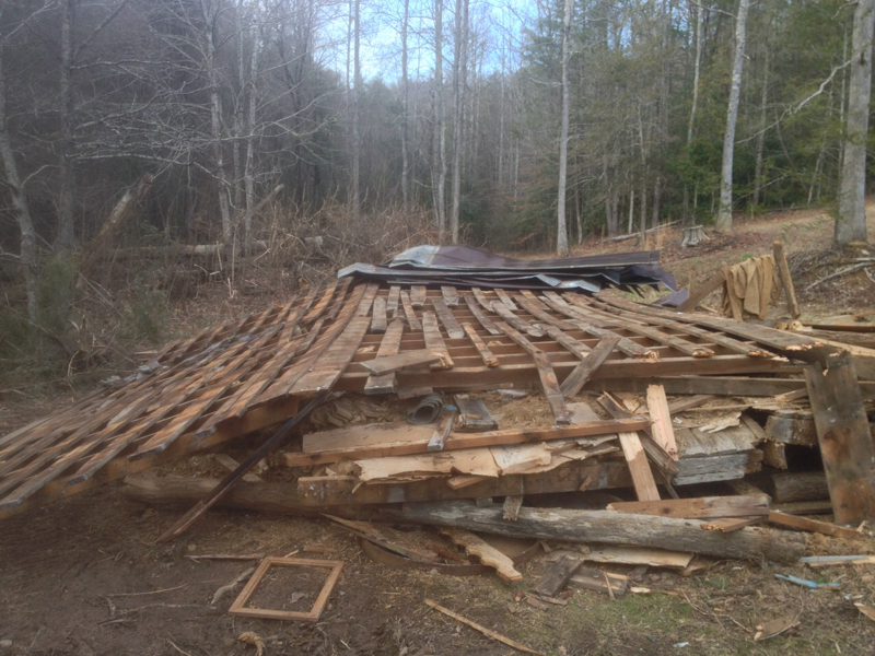

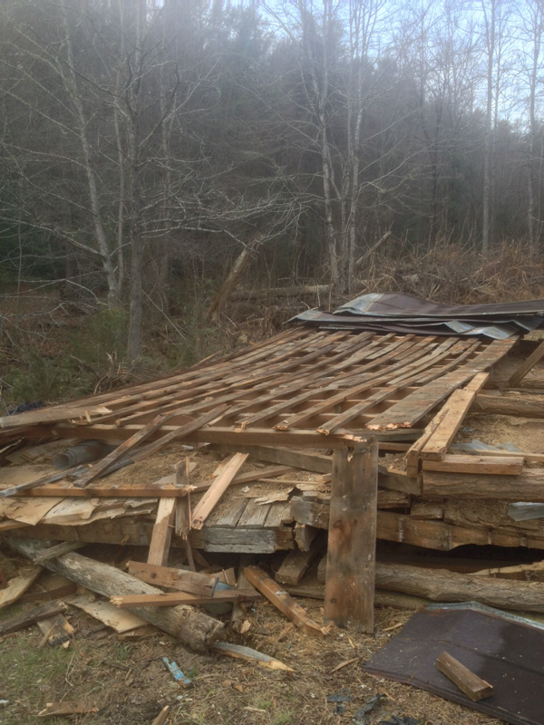

A couple of things I discovered over the last couple of days as I took the tin off of the roof:
1. Apparently it was common building practice in the 1940s to put anywhere from 500-900 nails into each piece of 24" wide tin.
2. R4 "Industrial" tires should not be considered R4 "Indestructible" tires. Reference point #1 above.
Fortunately, it was a front tire that took one for the team and not one of my filled rears. A quick trip to my tire guy and a $10 plug later and we were back in business.
At this point, it is beginning to look like there is little salvageable material left. I had hoped to save a good bit of the loft floor but because of the volume of rat excrement (it's the New Year and I'm trying to be nice) it is just not worth the time and trouble to cut out what little good is there. Some of the roof joists are in good shape and many of the roof purlins are fine as well. I'll grab what I can.
The plan, for now, is to salvage the last bit I want, cut as much of the rest as I can and haul it off, then burn in place the remainder. After it's burned. I'll rake out all the metal I can, then rent a small excavator, dig a small hole, and bury the rest of the debris. I want to take off about 4"-6" of the top layer to make sure I get any escaped nails and such.
Today's work. Now to pick out the good tin.

If you can keep the burn pile small, you can get a strong magnet mounted on a stick, and sweep for nails. I did that with a very old shed, and it did a good job finding the nails. I bought the magnet and stick combo from Grainger for something like $15.

Yesterday I took all of the roof purlins off. Surprisingly, they were in really good shape. However, I don't think a single one was the same size. A good many of them still had bark on the edges and were rounded and barked on the ends. It was interesting to see how the whole tree was used. Solid locust poles were used...still had the bark all the way around on those, true sized 2x4s for the roof joists, 4x4 bracing on the top of the posts with the roof joists bird mouthed on them, then random sized planking for the siding. It's been fun taking this old piece of history apart.

Looks like you are doing great. Be careful when you take off the 4-6" of top soil. I am sure several things got buried over the years. Do you have or know anyone with a metal detector?
