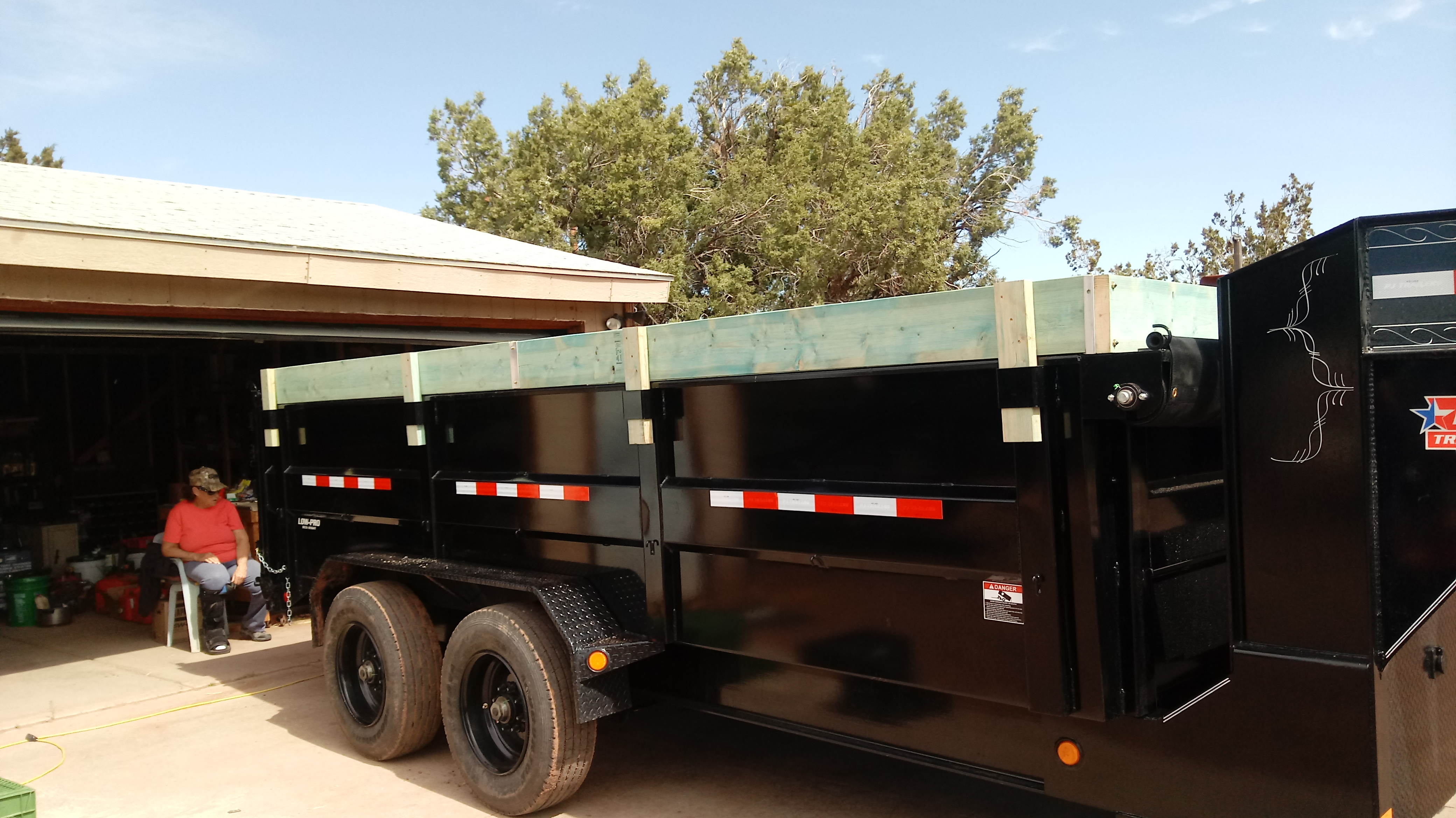

I dont see anyone offering that trailer with 96 in inside width and folding sides
Yes, just Diamond C and they are cost prohibitive on their dumps. Their flatbeds are competitive, kinda weird how high priced the dumps are.

Haydude, I know you really want a triple 8k axle trailer, but from my experience pulling one every day for a few years I wouldn't recommend it if you have an option.
Mine was a 50ft with 3 7k axles on a car hauler, I hated the way it maneuvered and handled. Using a buddy's identical trailer with the dual 10k axles was night and day.
I can imagine the shorter trailer would be even less fun.

Re: Building an 8 to 16 foot gooseneck dump trailer
I need that kind of feedback-thanks.
Researching trailers with 2 heavier axles rather than 3 lighter axles. Just have to figure out how to do it with folding sides and keep a reasonable budget.
One of the biggest problems is the sales people I have spoken to have no idea what theyre talking about and the trailer companies don’t seem to like direct contact from consumers.

Well how's the trailer shopping going are we on hold?.........:confused3:
   / Building an 8遅16 gooseneck dump trailer
#78
Not that great is the short answer.....
I see 3) 8ks around and none seem to have broken front axles hanging from them or unhappy looking owners.
I would like to keep researching 2) 9k or 10k axles with single tires as far as I can.
I have contacted Diamond C, but I doubt its in the budget.
Still cant understand why 2) 8ks only get me a 16k rating (wheres my pin weight)
Appalachian only one I found that has more than 16k with 2) 8k axles, but dont have fold down sides :pullinghair:
The goal here is to build a trailer with ~7 ton load capacity, carry 10 4x5 round bales and fold down sides.

Maybe they just do 2 8ks for 16k for safety reasons and liability.....
#80
I get that, but why do all flat deck trailers get pin weight added to their GVWR?
Makes no sense
