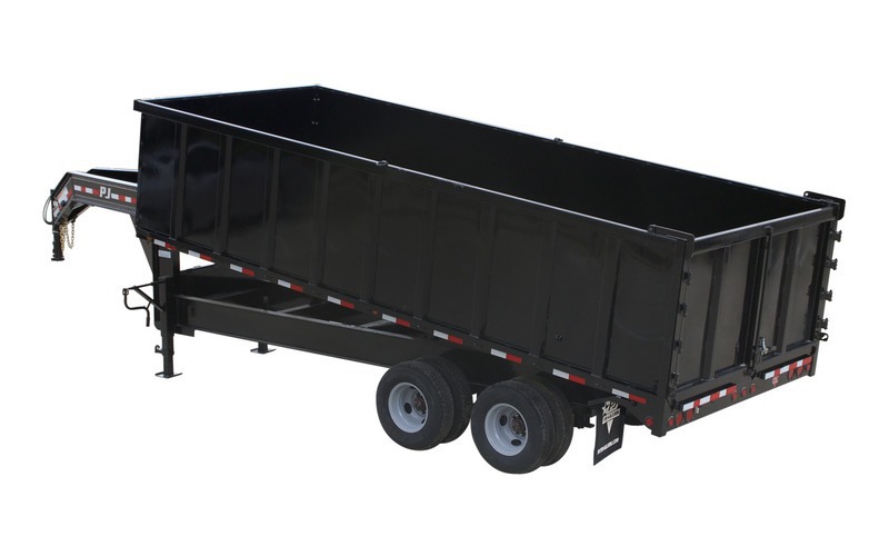

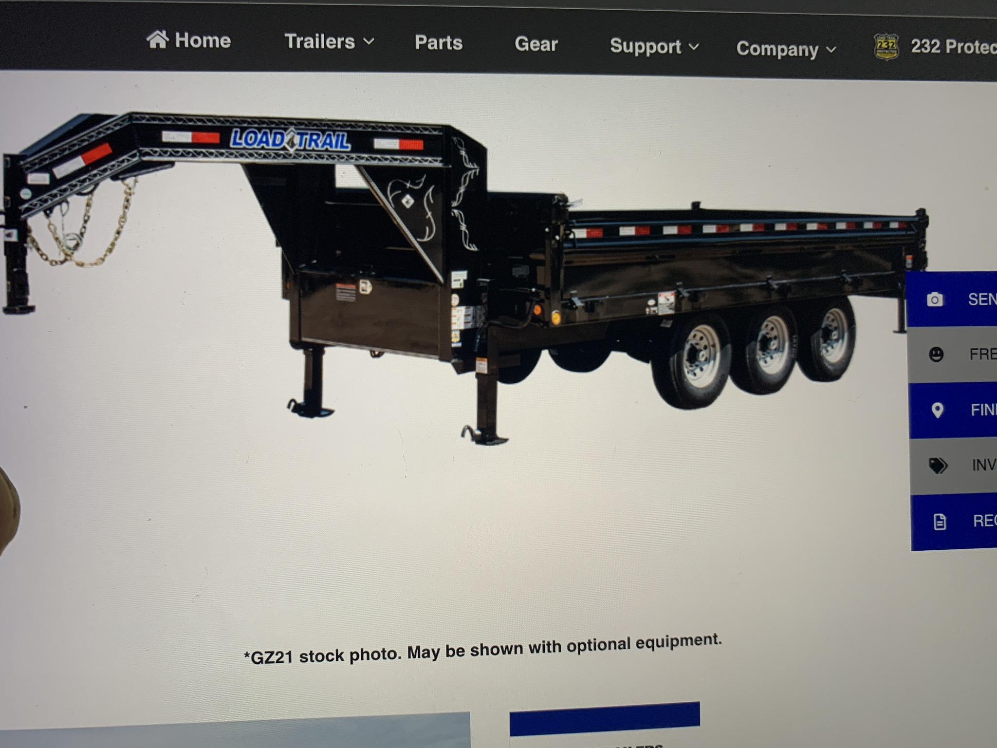

Nah, I really want the fold down sides for bales, pallets, etc.
Like this one with 3)8k axles and 16’ long.
I might see if I can get by with 2) 8k axles.
I dont understand these trailer ratings. My Kaufman has 2) 16k axles, but it’s rated for 38,500lbs. Thats 6500lbs of pin weight.
The dump trailers are all rated by the sum total of the axle weights or even less.
For example, PJ has a dump with 3) 8ks and they rate it at 21,000 not 24,000 or more which is LESS that the axles added together. But they offer a 2) 8k axle version at 16,000lbs. :confused3:
I don’t know what Load Trail will give me with 3) 8k axles.

   / Building an 8遅16 gooseneck dump trailer #58
Triple axles do an excessive amount of tire scrubbing in turns.
And two trailing wheels bend the swing arm of the first axles when pushing around a kerb stone. Tri axle torsion is rubbish, tri axle leaf sprung (straight axles) is ok, but tandem is better.
I think part of the GVW rating considers two or three axles. It might not be reasonable to expect one axle to carry the weight of three, but is okay for one axle to carry the weight of two. This is in a momentary situation where the ground is uneven. Dexter does not recommend a three axle torsion, because of this. With springs and equalizers it can still happen but chances are way less.
