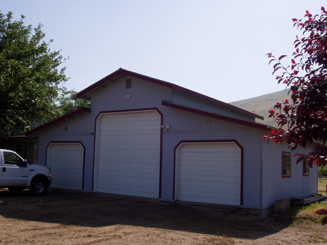

An aesthetic suggestion-while framing the 15'-6" main door opening, in the two upper corners install diagonal members half of a Y brace) at a degree that you're "eye comfortable" with-perhaps on the same angle of your lower roof lines and run the siding over them.

+2 on your beautiful site and handsome design. But also +2 on your needing more bracing where the upper roof meets the sheds. That upper roof will want to push out on the shed roofs at the bottom of the upper rafters. To resist that, you'd need to move the collar ties (short "ceiling" ties) down, or increase the member size of the rafter itself. With a larger rafter, the high ties (bolted well) can hold the rafter and it won't bend.
If you're using 2x10s or better, and your gussets are glued/nailed, you're probably all right. Can't tell from the SketchUp drawings - maybe you've got that covered. Good luck with it, though, and keep the pix coming.

Thanks for the advice on the collarties/roof. Some parts are not on my sketchup drawings, but I had not planned more than 2x6's for the rafters b/c of short span. If the collarties are dropped lower, the loft ceiling will be too low. The posts will be strongly tied together by the loft floor, and the posts only extend 3 ft above the loft. Does that make a difference?
Yes, there will be either wood diagonal bracing or cable cross bracing in the walls. Thanks.

The floor should hold everything together IMO and the collar ties will strengthen the roof. If you don't think the collar ties are enough you can always cut plywood into triangles and nail them from the collar ties up to the peak. Looks great!
