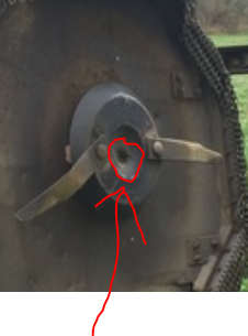

The king Kutter has a center piece that spins causing the blades move out. The nut that holds the center piece in place has a pin to keep the nut from coming off by accident. If this nut has loosened the gear box will turn but the blades are not being forced out because the center plate is not spinning.
If you have the tractor off and in gear with the PTO engaged you should not be able to turn the plate. The nut should be on tight. I have indicated the nut I am talking about.

There is nothing wrong with his cutter
