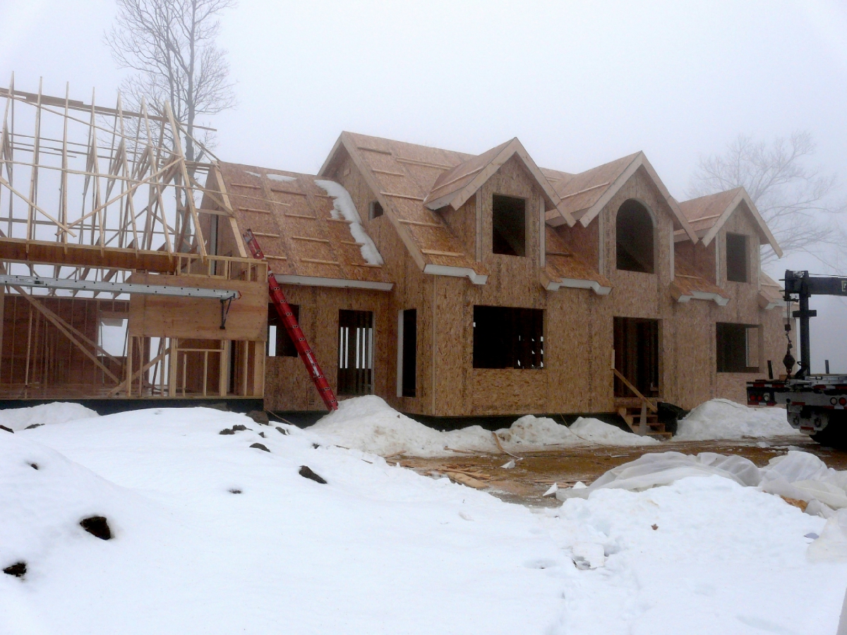

You are building like I did mine 2 years ago. My own design with Superior wall basement they are dry!!!). I also used SIPS but traditional trussed roof with spray foam. I would go with SIPS again.
The SIPS are very stiff/strong, the house is very quiet, and very warm. We use only about 11 BTU/hr/square foot of heated space. Yes that includes my basement and garage...but they are both radiant floor heated...so I think it counts. The SIPs did add about 12K to the price but the payback is immediate. What I mean is that the slight increase that I spend per month on mortgage is more than covered by the decrease on heat and cooling each month. In fact in 2 years we have only turned AC on for about a total of 4-5 days...and then only one of the two small units. Some would say that the payback is 30 years for SIPS but I also look at my $ out per month...the SIPs lesson that total amount.
I have the garage and rooms over the garage as traditional framed with spray foam. I then have 1" polyfoam sheets with foil over those studs...then the drywall. This is NOT as warm as the SIP areas.--just for a comparison. When I retire and move to a small cabin (I hope) I may try ICFs with even higher r-value and greater thermal mass for solar.
I also have about 45 windows (crazy I know) but they are just Anderson 200 series. They are reasonable U/R value with reasonable cost. They are low-e and that helps a lot. When the sun shines the heat never turns on. I have become a big believer in modified building ideas to save energy and cost. We are not yet "there" as a nation but hopefully will be soon.
Sorry about the long post, but I think the SIPs and other technologies have a great benefit...and not just in energy efficiency. They are quiet, use less stick lumber and more OSB (rapid growth and renewable trees). By the way...I am not even a tree-hugging hippie!

I'm a mechanical engineer and have been acting as GC. I did the plans and most of the structural stuff myself. I've been using a construction management firm "Building Alternatives"
Home Builder of Log, Timberframe, Modular, Cedar, SIPS construction in NH, MA, MW, VT
to guide me thru the energy efficient home thing and purchased the SIP panels through them. I also used their recommented contractor to erect the house part of the shell.
Winter Panel
Announcing Structural Insulated Panels for Construction: Winter Panel
was the SIP supplier. "Building Alternatives" shopped 5-6 different SIP suppliers they deal with and recommended Winter Panel as the best value for my project.
I sent Winter Panel my plans, some of which they just copied over to their official blueprints. They verified and tweaked the roof structure, and laid out the panel details. We went thru several cycles of minor changes priopr to final approval before they cut the panels.
I figure the framing with SIPS and timber frame Hybrid construction cost 60-70% more than a stick built shell, but you dont get the insulation or the timber fame look with stick, unless you add it later. The framing is a small part of the total home cost. Heck, I spent much more blasting and hauling out darn NH rock.
