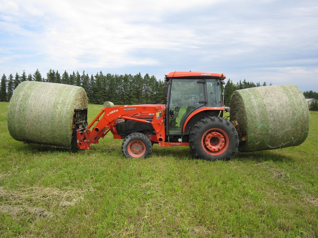

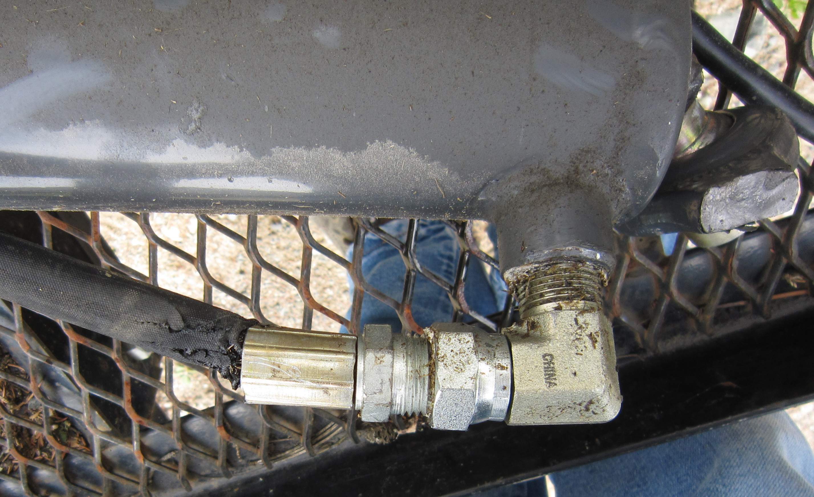

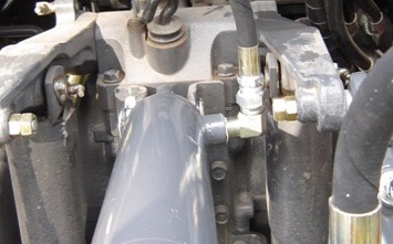

Clarification of the problem I had. One picture shows the clearance between the double nut on the 3 point top link and the fitting. It was recommended I run the hose parallel with the cylinder so I did that. The second picture shows the hose damage but also not on the right end that the twisting action when that top link set of bolts caught the hose was so hard that it twisted the cylinder and broke the pivot eye off the end of the cylinder. The welding was excellent - the failure was not the weld but rather the rod end shaft. The L5740 top link is Cat 1 against the tractor and Cat 2 at the implement end. The new top link they built for me was Cat 2 both ends because there is plenty of room for the larger Cat 2 rod end at the tractor.
When the failure happened I had a 1200 pound round bale on a fork and was on a sidehill where the weight shifted everything right taking up all slop in that direction. I had run throught all movement prior to that time to make sure I had clearance but I didn't account for a 1500 pound bale swinging on the back and the dynamic loads it can create.
Since I got the new top link I have carried hundreds of bales with no problem. My old L3710 didn't have a hydraulic top link and it was a pain. I had to adjust the spear to the right angle so it would spear the bale right, and then I had to raise to full height to get bale clearance. Now I angle the spear to match ground variations as I am backing up, spear the bale, raise it off the ground in the front, then tilt the top link forward giving me lots of clearance at the rear of the bale without raising the CG too high. That gives me enough rear ballast so I can pick up a bale on my front pallet forks. The extra 2400 pounds smooths the ride quite a bit but then again I can't drive very fast with the reduced front and rear visibility.

Thanks for the pictures and explanation MHarryE, now I know what to look for.
