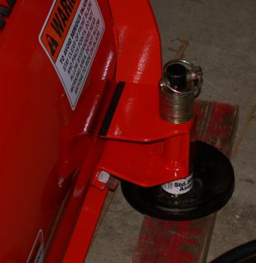

The shoes are from Woods, my Kubota dealer ordered them for me. I think they were around $28. I just finished making shoe mounts for the front blade and I bought a pair of Western shoes for $13 each.
