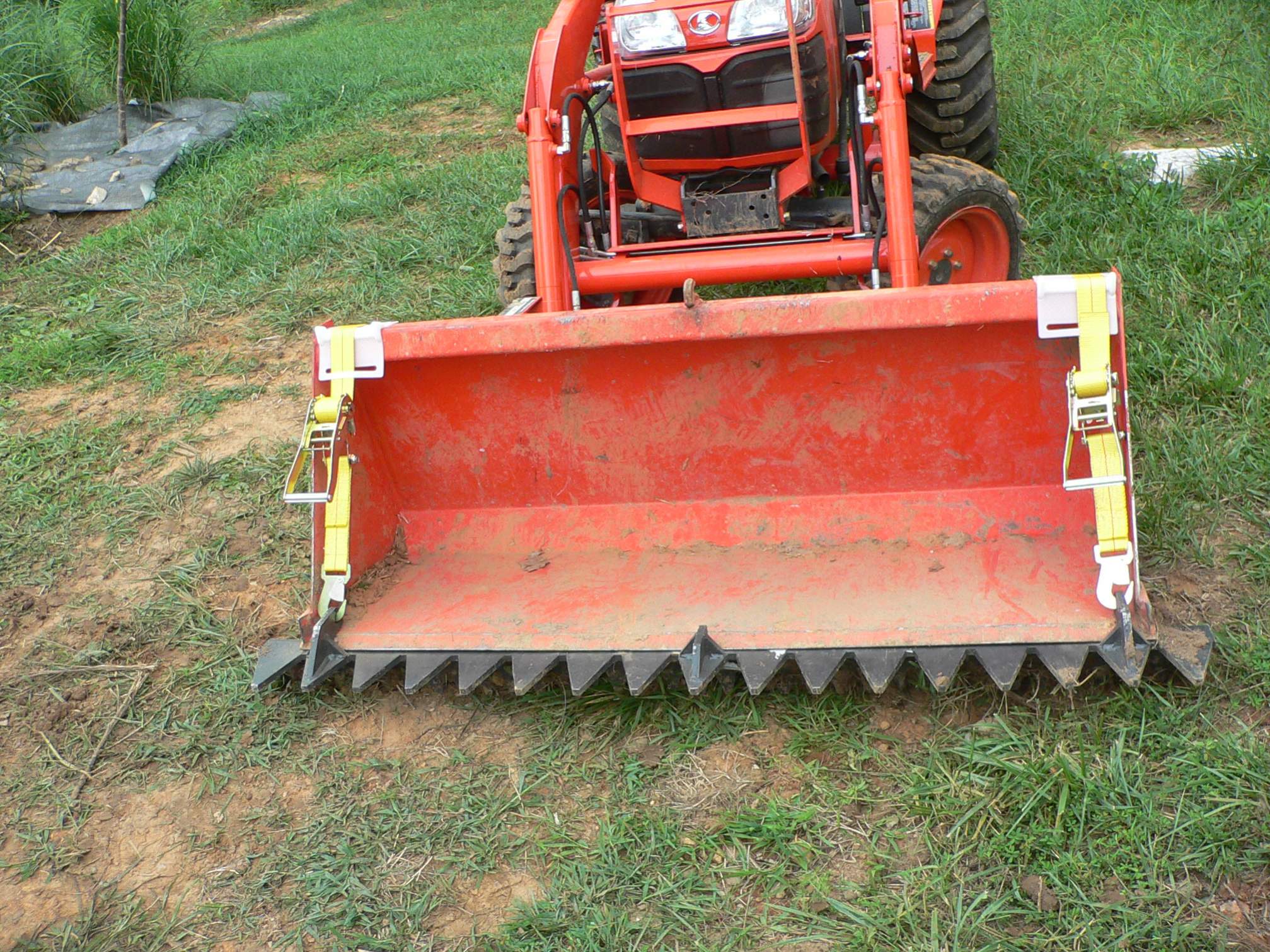

guys,
i just returned from my kubota dealer. he agreed with me about my front bx tire. inside rim side bead leak . . . which he said he had repaired.
with my track record of non luck, i may be revisiting the slime or tube issue shortly.
i must put my bro-tek skid plates on and head into a large brush area that i need to clear out with a ratchet rake . . . yike it's a big project!
any advice on back dragging with the rr?
thanks in advance. D902 BX PILOT

I originally just used my RR by back draging work area of dirt. Lately I've tackled some major growed up areas of small trees, brush and briars. I've been going straight into brush with big teeth forward and small teeth just skimming the ground then tilting bucket till lower small teeth bite into ground and back draging it all out. Then back and forth with lower teeth into ground with final back drag to level it all out. Working great. Pictures of first and second RR.
