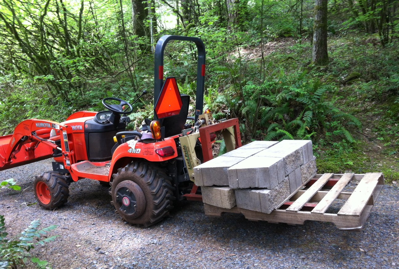

Rear: It lifted 12 blocks (804 lbs), pallet, carryall, and quick hitch to full height. Another block added limited lift to about 8 inches. Total would be somewhere in the low 900 lbs. Blocks were toward the front of the pallet, but stacked evenly, not in only one tall row.

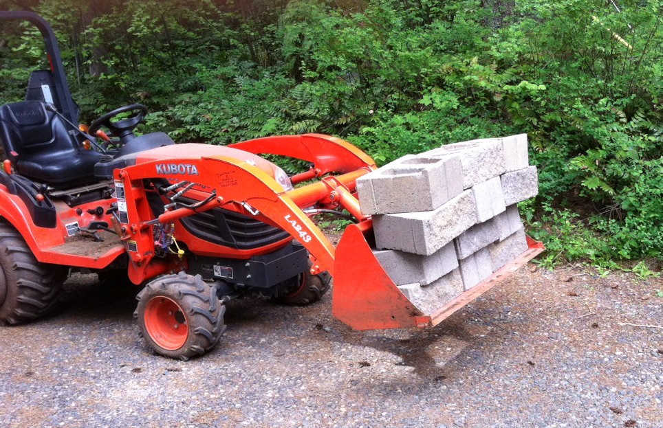

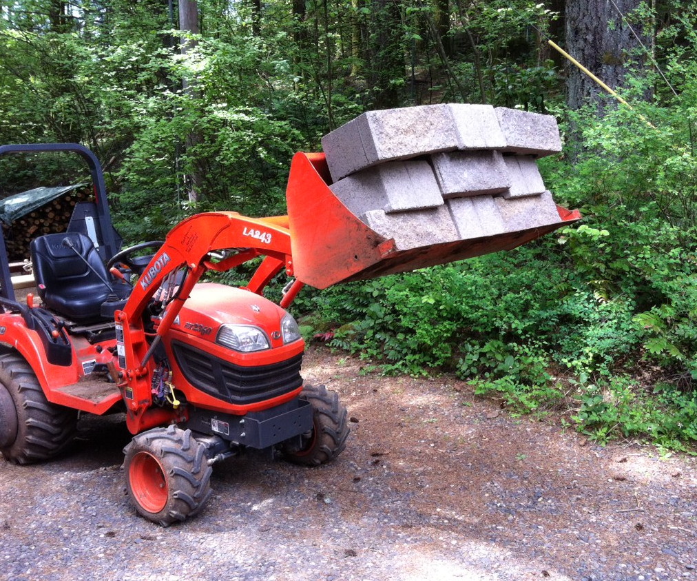

Front: It lifted 12 blocks (804 lbs) to this height:
Each block removed allowed about a foot more lift. Curling the bucket fully back allowed about one more block to be lifted to the same height.
Nine blocks, 603 lbs, allowed a full lift, starting with the bucket level, so it had a partial tilt back when high.

I thought the 3pt did pretty good Especially see there is a QA on the rear - figure that moves the weight out a bit more.

It has the 243 loader. The rear had 110lbs of wheel weights, quick hitch. and carryall when testing the loader. The loader was empty when the rear was tested.

The FEL test had the front tires squatting pretty good. I haven't ever tested the pressure on my loader, but seeing what it does to the R1s when I have a load that is near max before I go into relief I don't think I could get much more lifting capacity.

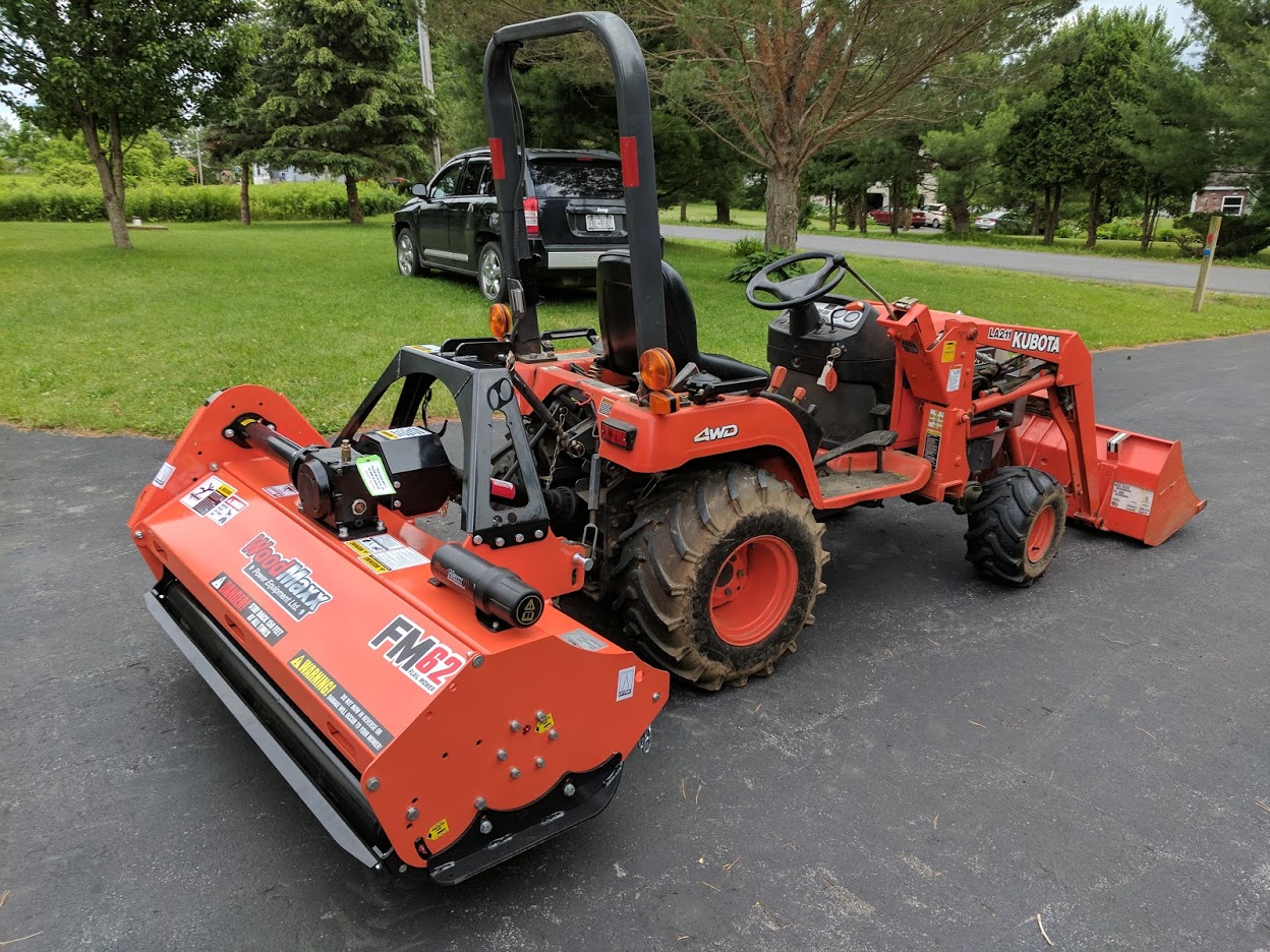

Just in case anyone is wondering... yes a BX will lift a 62" flail mower and it works it just fine. Weighs about 700#.
I use it for mowing my lawn when I feel like switching it up from a rotary.
