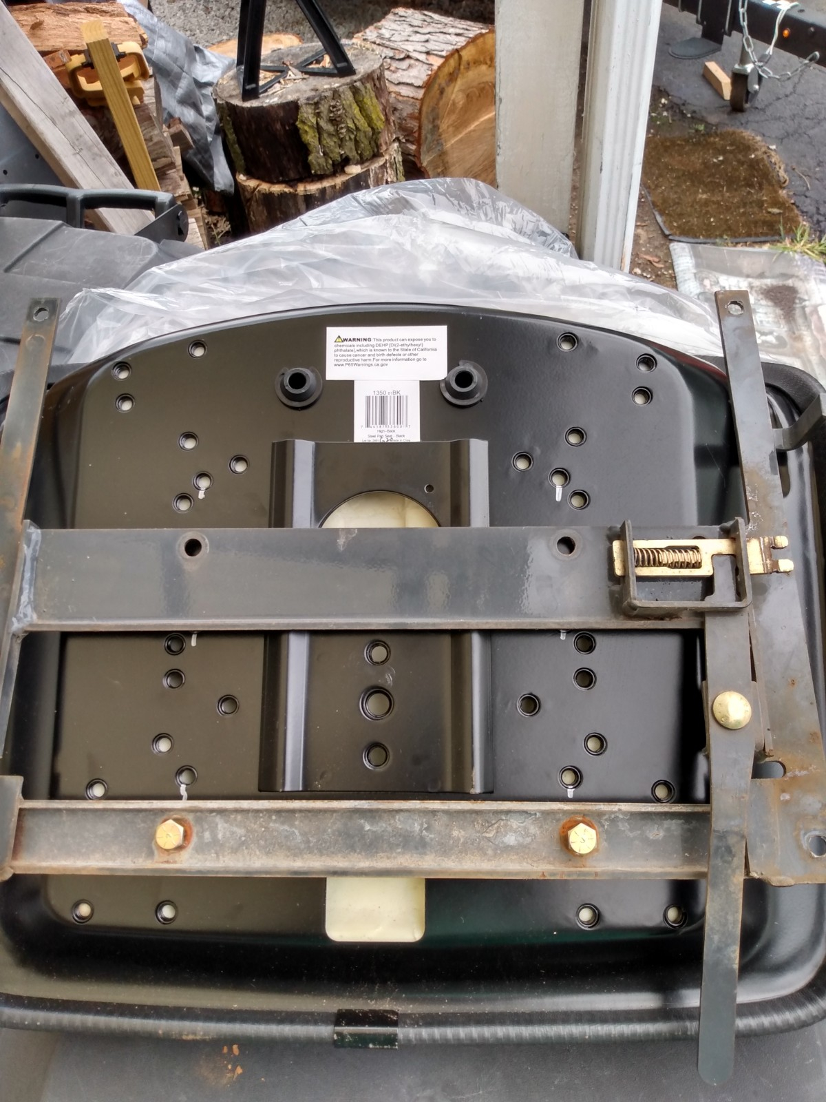

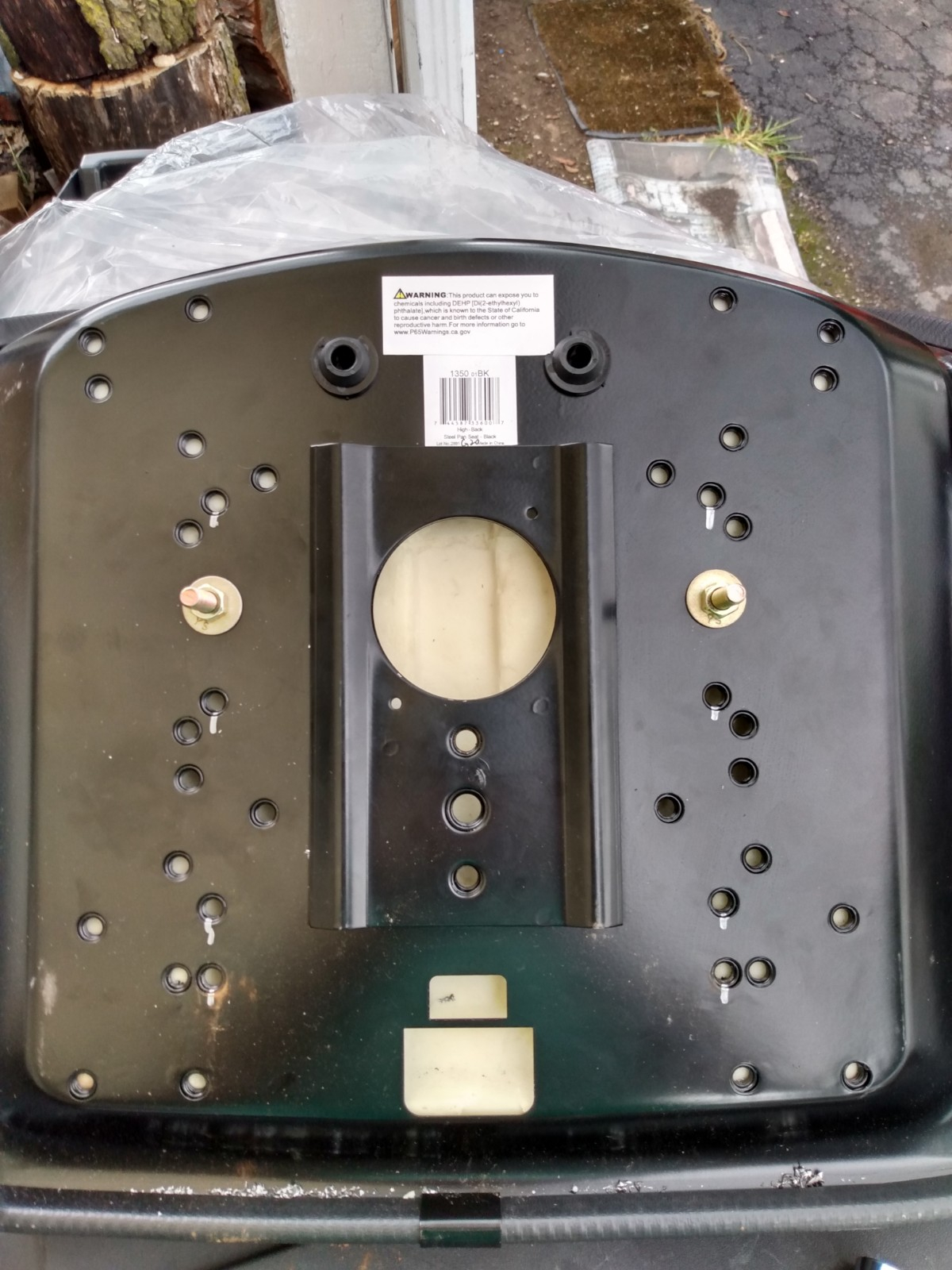

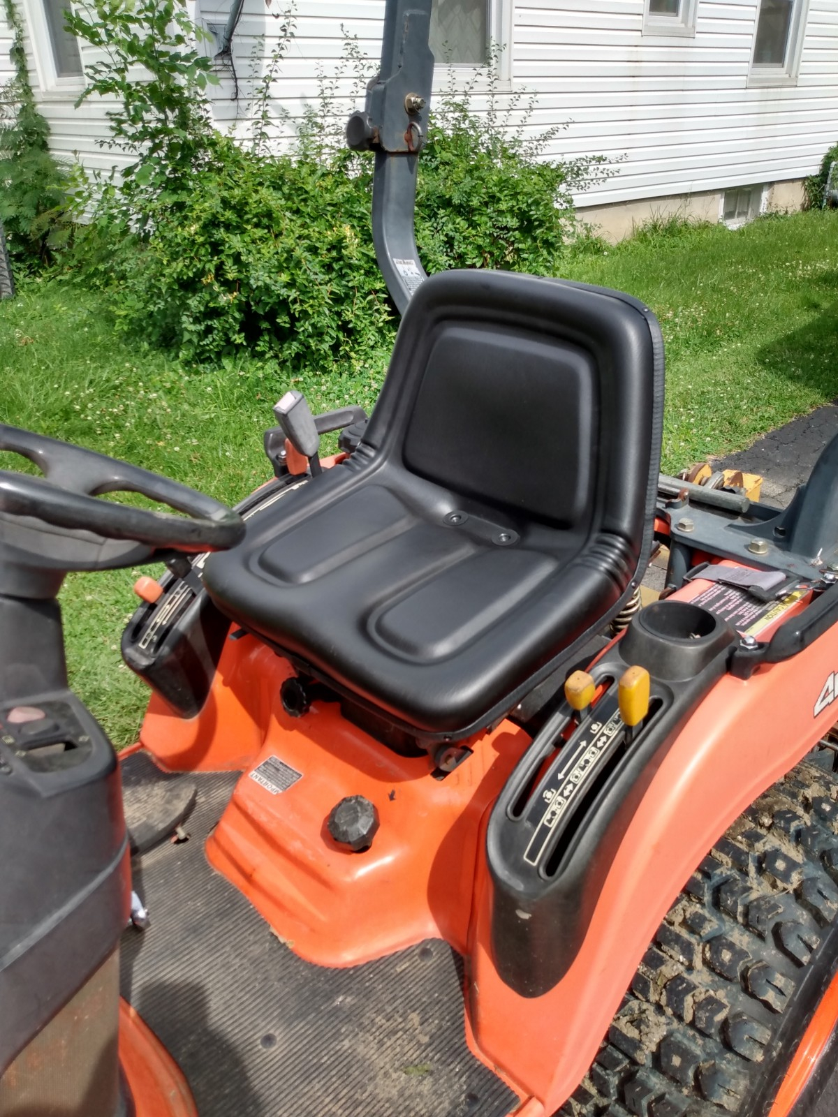

I have been looking for a seat for my "ultimate garden tool", known to the public as a BX22D TLB. One of the dealers I use advertised a seat for about $150 then after I ordered it they notified me it wasn't available, but they had the $400 one in stock and would be happy to send it. Right, a $400 seat on a twenty year old lawn tractor. I don't think so, even if it is orange. I took a shot at an $80 seat from Northern Tool with a 7.5" spread on some of the threaded holes, and it came out really well. I wound up drilling two holes and buying a few dollars worth of grade 8 5/16x18 hardware, but it is all that. It works well with good clearance in both the tractor and backhoe positions. I'm attaching pics if anyone else is thinking about doing anything similar.
