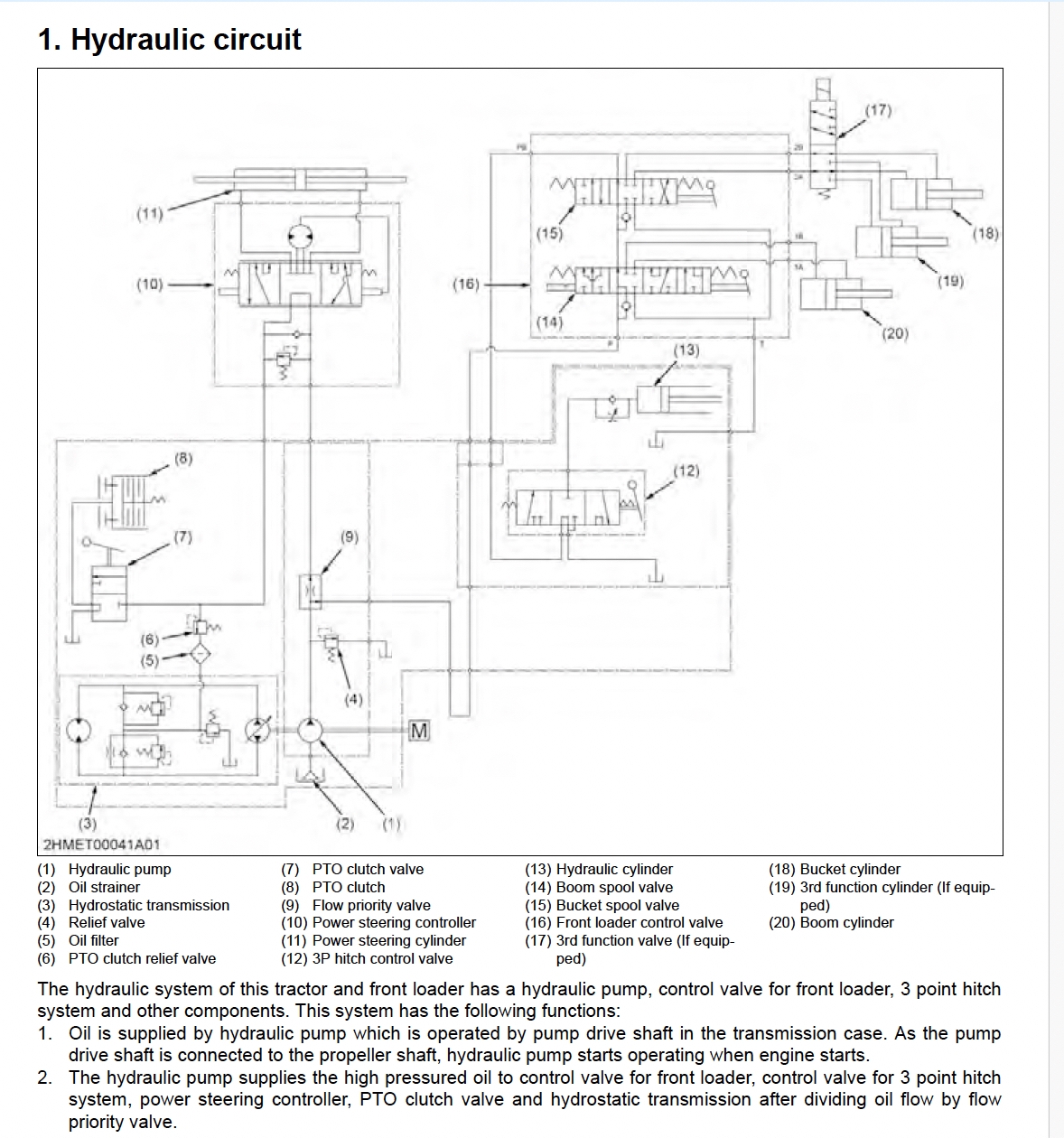

Thanks K
Those diagrams kind of confirm that if flow does not get to or through the charge relief the filter would see excessive pressure.
Jyvas,
Did steering or implements functions stop working or change speed before the filters failed?
I would not try operating the tractor until you feel confident the problem is resolved or you may damage something else from the excess pressure.
Everything seemed fine right up to the point of blowing out the filter. I backed up to a flat surface as it was pissing out and shut it off. it was definatly a sudden problem, not a slow workup.
/ BX24 blowing hydraulic filters #105
If sudden then need to find what passage or flow path is plugged from the filter into the hydrostatic curcuit. I believe the filter flows from outside to inside so path in question would be through the filter mounting stud into the HST.
When you removed the charge relief did oil pour out of that opening? It should connect directly to the transaxle reservoir and I would think below oil level but not 100% certain of that.
Did you try turning the engine over with charge relief removed to verify flow to the charge relief?
Or with filter off and relief removed blow some air through from filter to see if air and oil come relief port. Don’t get crazy with air pressure since this circuit is only supposed to run 70 PSI max.
If air blows out relief possibly try putting relief in without spring and ball. Remove trans fill port cap and gently blow some air into the filter stud. Should just make bubbles in the trans reservoir if path is open with little to back pressure. Again low pressure since don’t want to damage anything further.
Keep everything as close to surgically clean as possibly.
If air seems to flow then try installing the charge relief assembly and see if any air flows past it if you can seal the connection to the filter stud. I have a rubber tipped air nozzle so it might work. Be extra nice if had some way of regulating air pressure into that filter - charge assembly.
I know easier for me type than doing the actual oil in your face testing..
