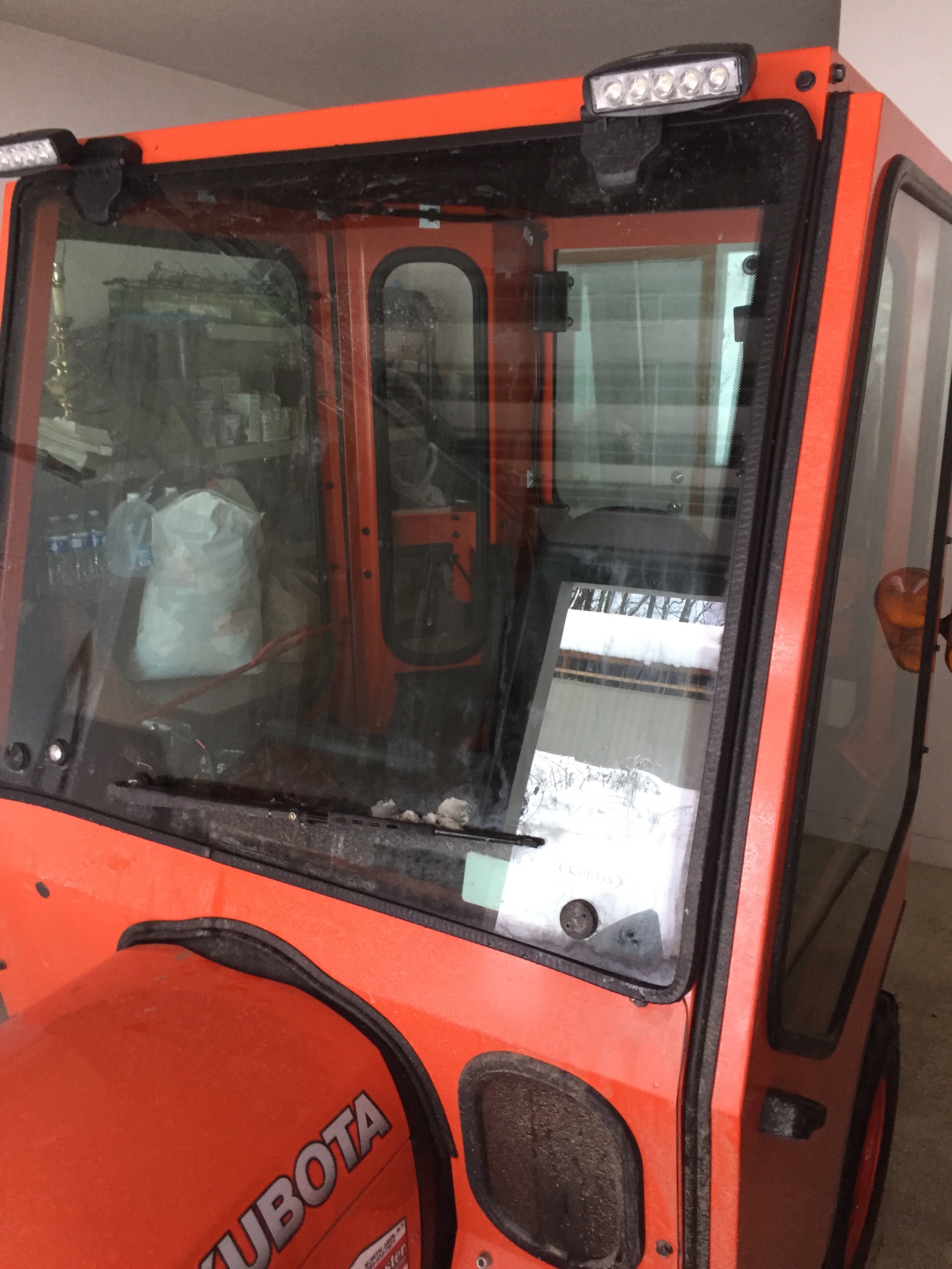

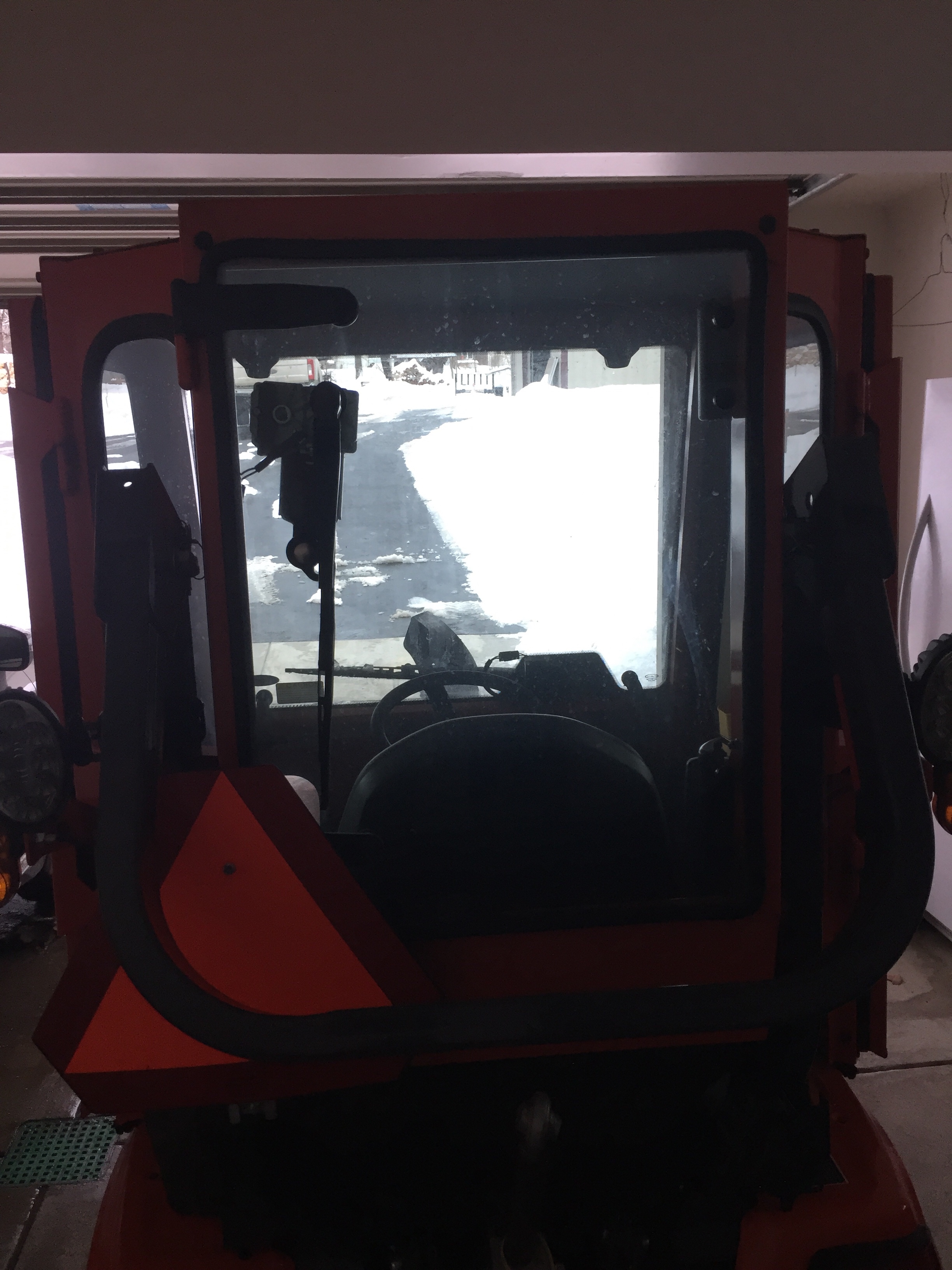

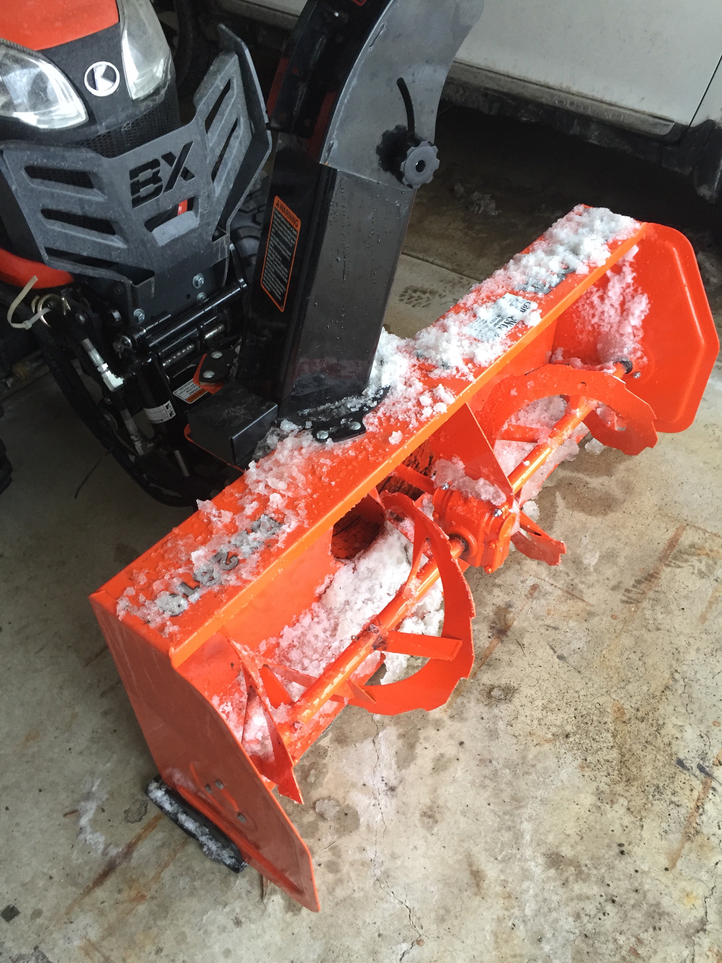

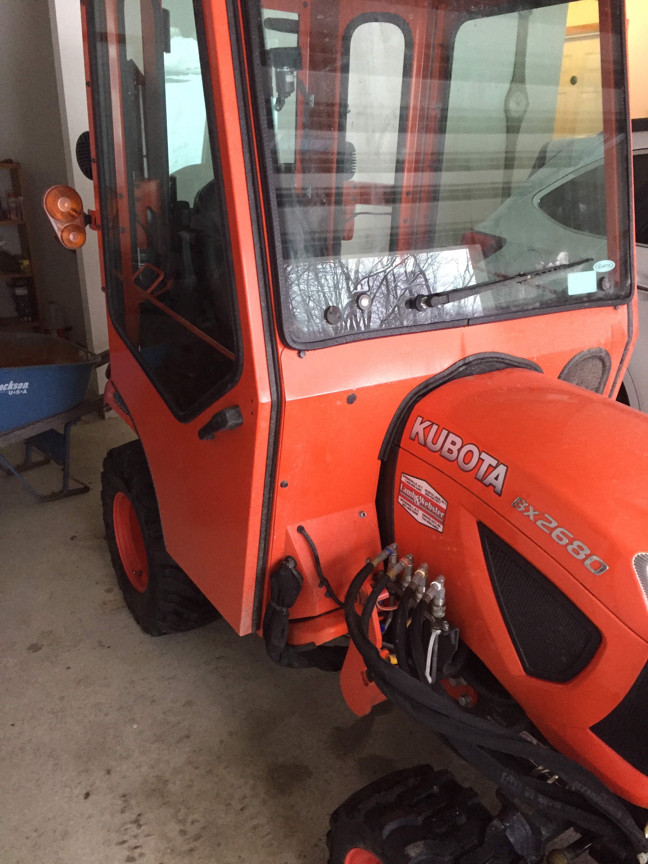

Got her home today removed the fel ,front blower installed .Needs a bath hopefully it warms up tomorrow enough to clean her up.

That’s a beauty. Looks like it’s never been used. Good luck with your new purchase!
