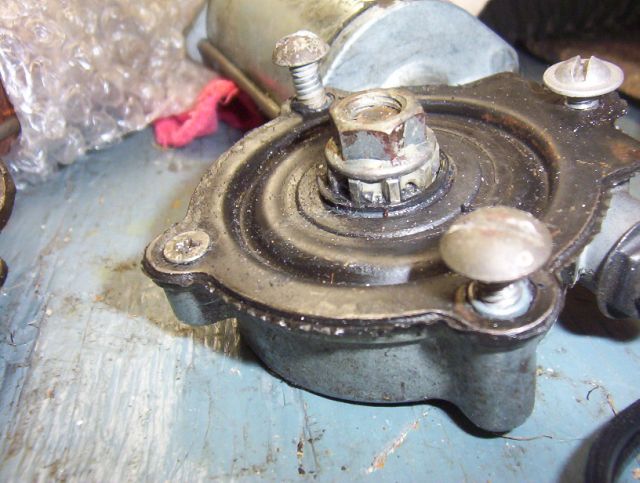

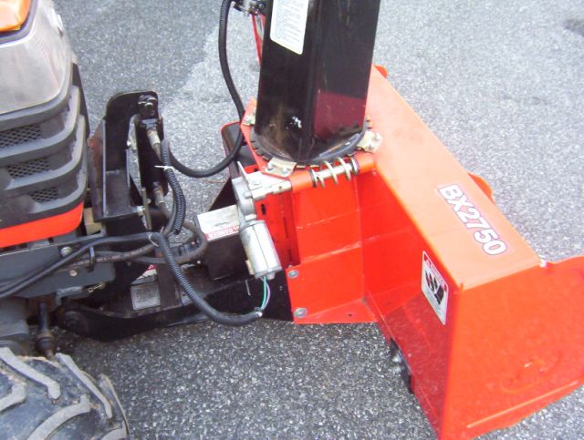

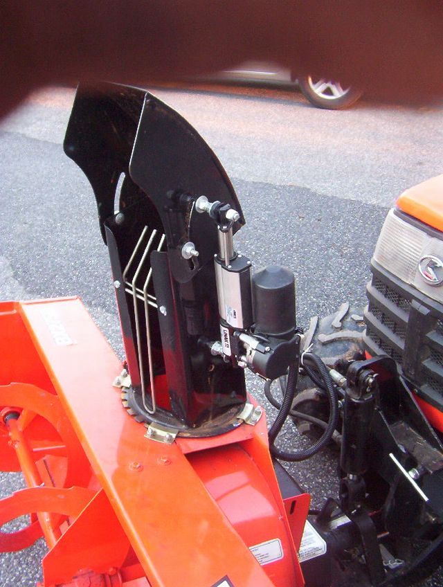

Here is my set up window motor from e-bay $25 for 4 units, I have 3 spares.:D
Bar AL stock from HomeDepot $10, one socket, $3.95, 1 4 way connector $3.95.
Linear actuator from e-bay $75, 2 bolts from spare parts bin.

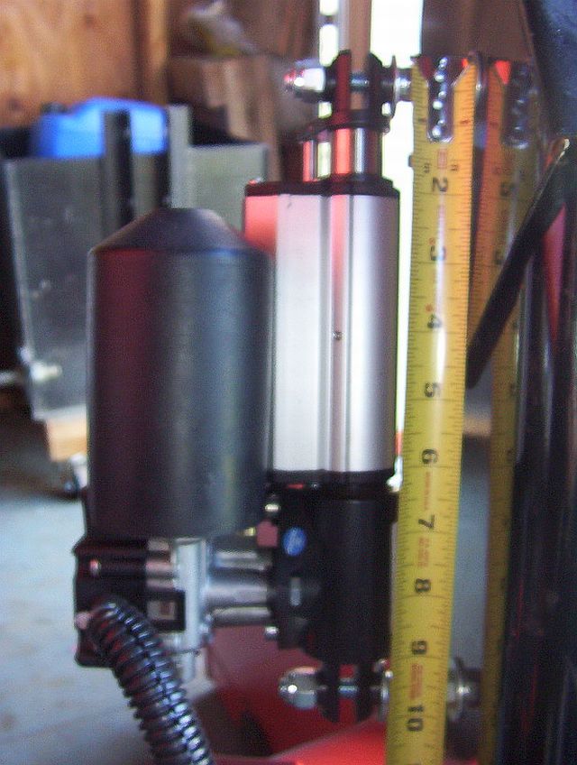

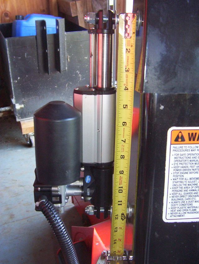

Any chance I could get a close-up of that bracket you made for the window motor? I found another one in the customization forum. Was going to use that but I like the simplicity of yours better.
Also, what's the stroke on your LA? I bought a 6" and I think it might be too long. Probably can get away with it but don't know if it's necessary.

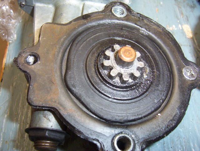

Keith,
Here you go, hope this helps, if not let me know.
The aluminum strip is 2 inches wide I bent it in a vice.
I have added a few pictures from different views
The motor is just a window motor, does not matter from what car as long as it has a gear on the end. I went on e-bay, typed in window motor and got the cheapest I could find, just so happen the 4 were cheaper then one! My first thought was to JB weld a nut onto the gear. Then I gave it more thought and found if I trimmed the points on the gear a bit, I could get a socket to fit. I then used an old socket extension to connect the socket to the wire screw gear.
