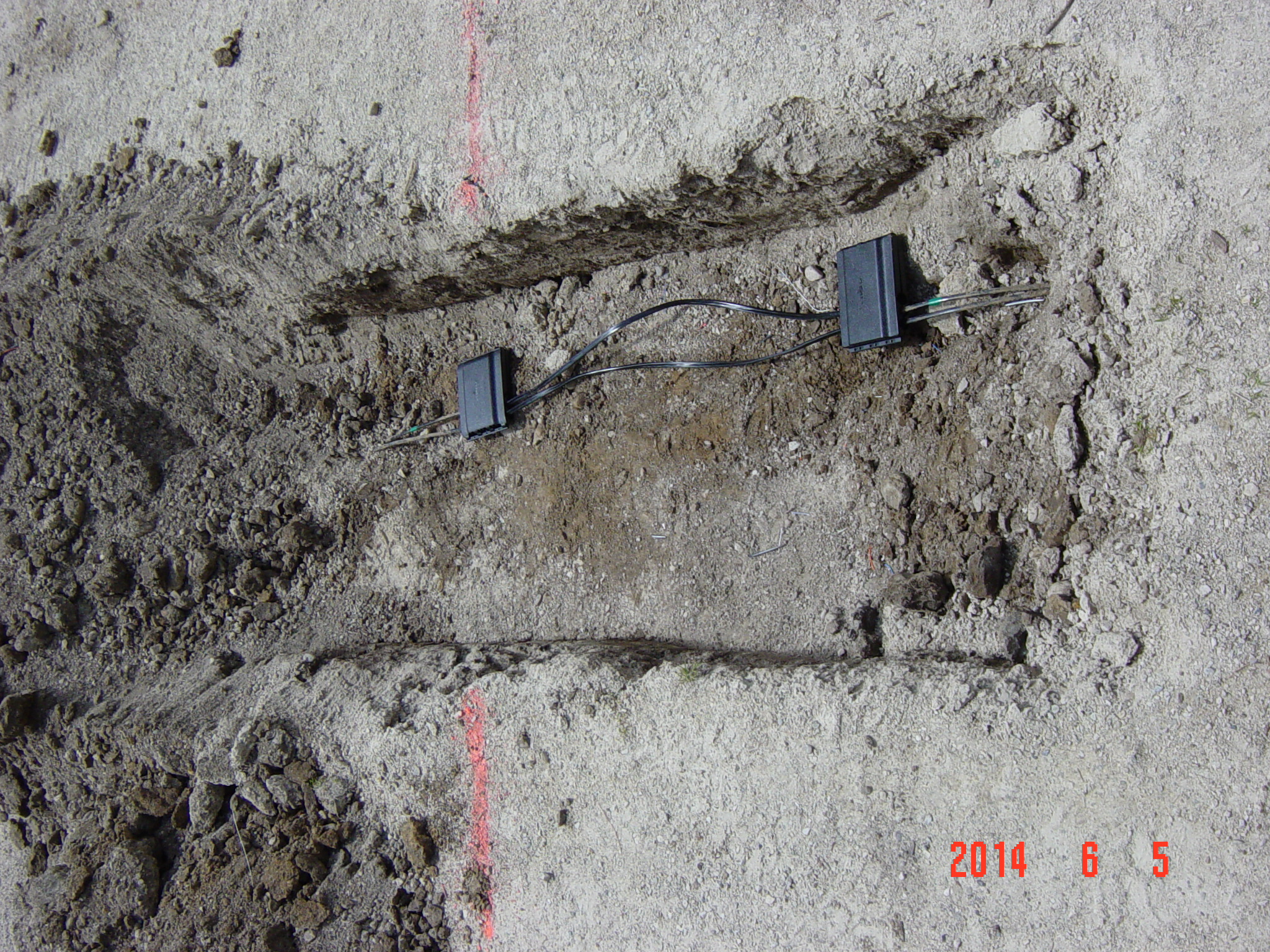

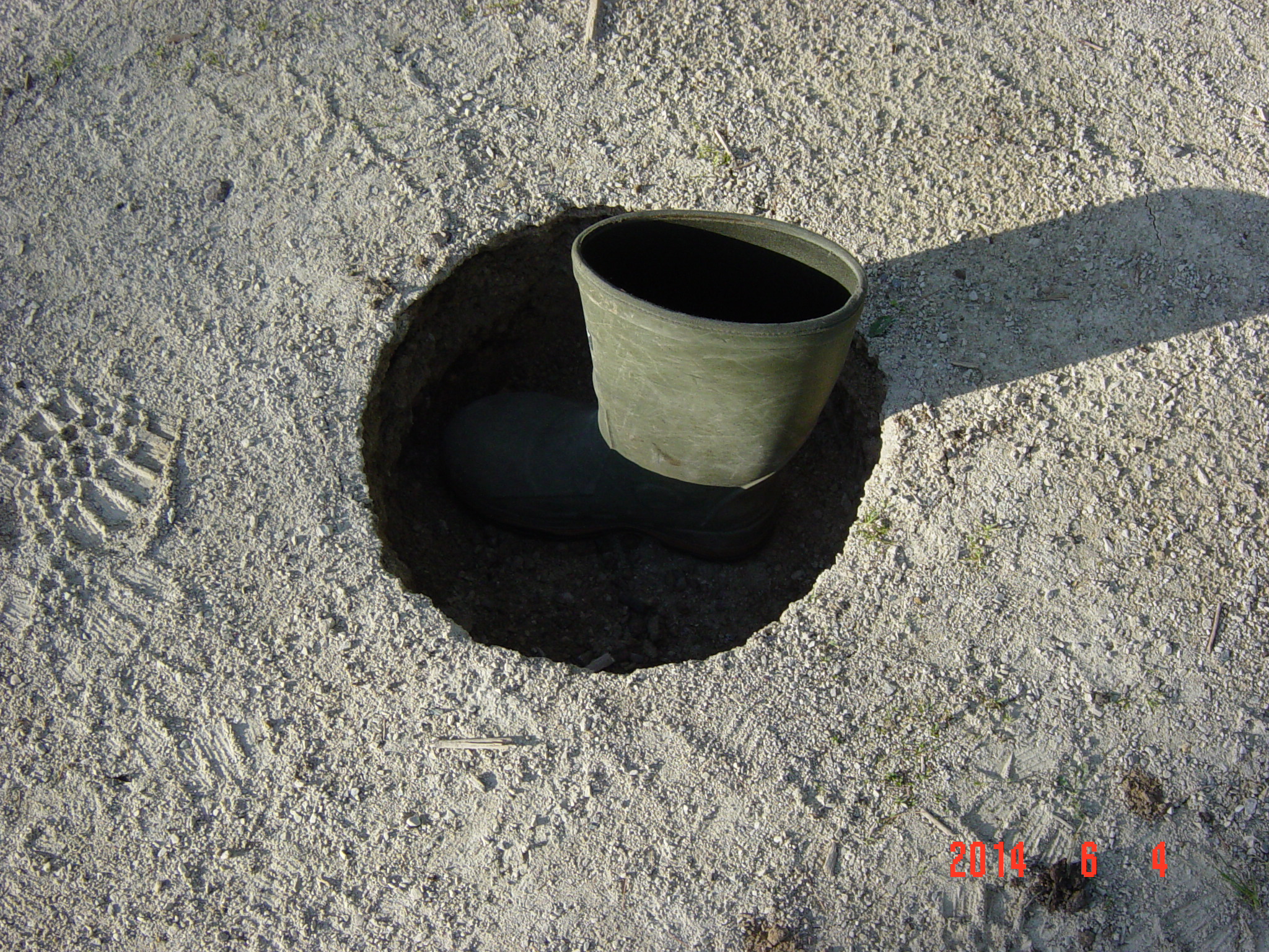

You just never know what will happen. Guy unloads float in my driveway and punches this nice hole through my phone cables.
Boot is for sizing hole.
The Hole was well done and quite elegant. The repair, not so much.
