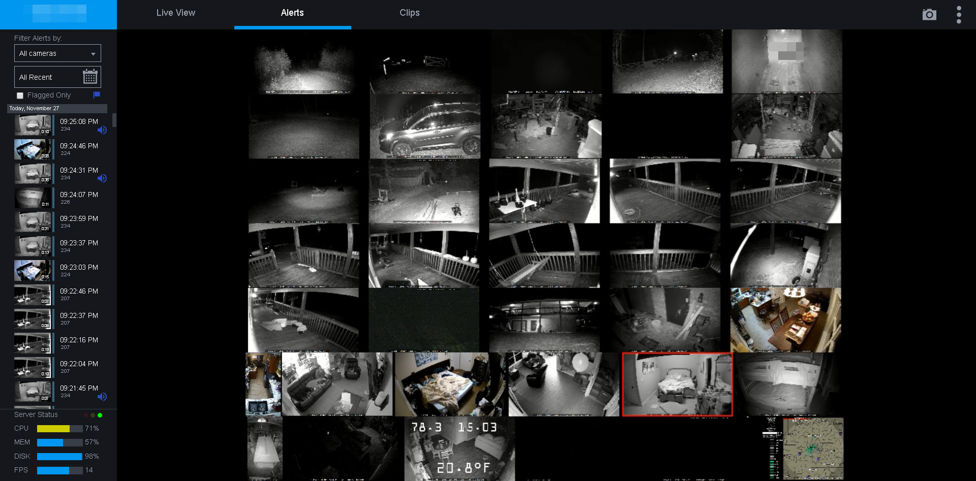

I concur that Blue Iris is the way to go. I've been using it for the last 7+ years. The developer, Ken, is available and responsive. I'd pay 10x the cost just support his genius.
I currently have 35 cameras - mostly Hikvision and Dahua PoE IP cameras. The program is on a dedicated i7-4XXX machine running windows 10. The CPU runs between 60 and 80% (depending on the activity level of the cameras), and I have about half the cameras set to 15 FPS, with the remaining set to 25 and 30 FPS. Most are set to 1080P.
All but about 5 of the cameras are hardwired. And some runs approach 500'. The max distance for cat5/6 cable is about 330', but if you use solid copper (23ga) you can push it to about 450' w/o issue. If you need to go longer, you can get mid-span switches that act as a signal booster.

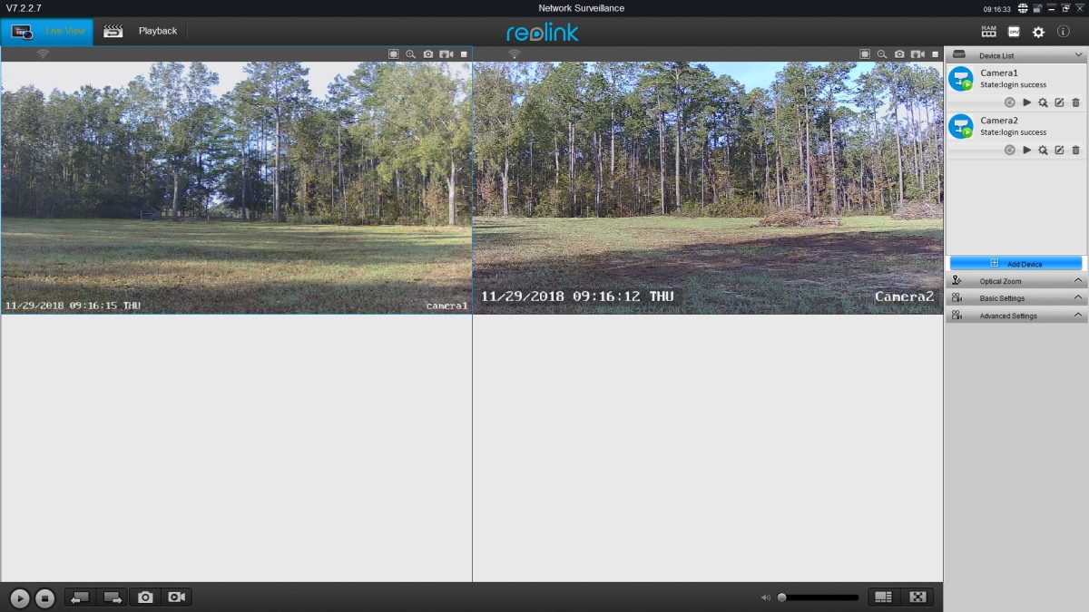

dragoneggs, I don't know anything about Blue Iris but try logging into the camera from your internet browser. Just enter the ip in the address bar and use the default name and password if you haven't changed it.
My Reolink cameras have a built-in interface I can access via web browser. I use the gear symbol at upper right to open the camera settings panel. There you can change all the camera parameters.
The software that was designed for and supplied with the cameras works okay but for some reason the browser interface is a little more stable. Probably because it only sees one camera at a time in it's window. You can open each individual camera in different tabs. The software supplied will see all the cameras on the same page in multiple windows.
Here is a screenshot of the windows software. Not sure how the Mac version looks.

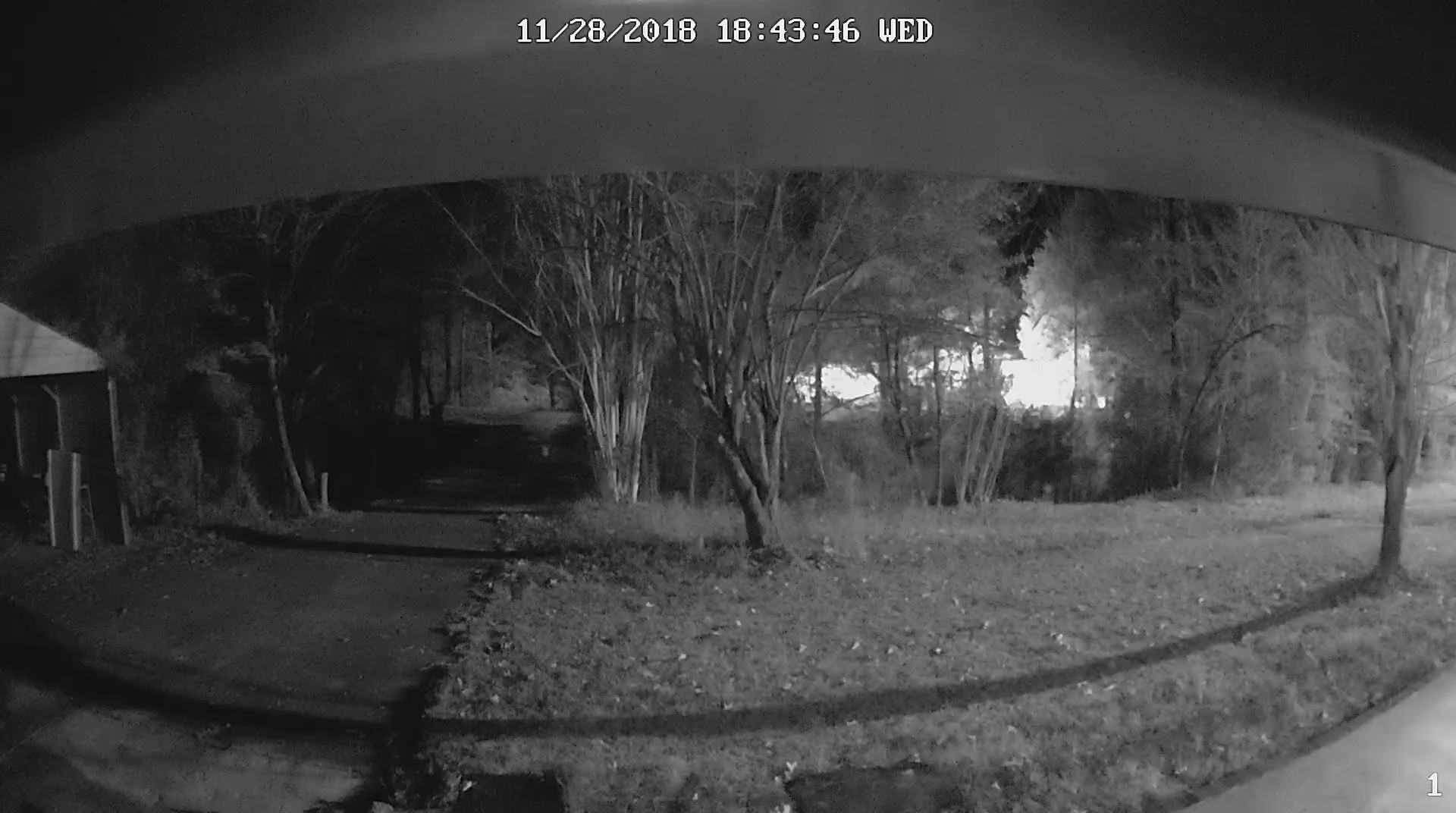

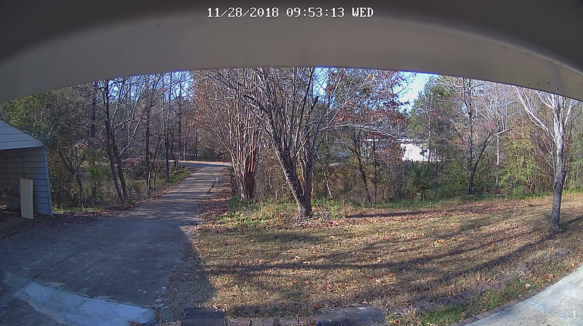

Played around with one a fair bit. I've been using IP cameras off and on since about 2008 so the software with no FM was a discovery process.
Hooking it up to the Mobley and back to my home router was not REAL easy but maybe I was just too impatient. But it worked fine with the Mobley in a test, both inside with the "home" router present and outside with no other router present.
The software is kludgy and reportedly it will NOT work with blue iris because BI requires some feature the camera lacks (edit -battery operated cam only).
It works as well or better than the netgear pre Arlo offering.
It's easy to pick up and move, runs fine off USB battery charging, has a sharp image. I charged up the battery to 100% on 26 Nov and it's now down to 62% after significant fiddling around, recording videos, taking a lot of snapshots, and I've got the alarm on so every time I walk by it talks to me (no more ads though).
I hung it outside (2 screws in the base to my soffit) so I can see when the Amazon deliverers are coming. That was a 3 minute process.
It seems the PIR range is about 25 feet as I've got it set.
Sample pics:
Daylight
Dark
/edit - where the pictures were taken is the same place it dropped signal when I took it out before. Don't know what changed.
