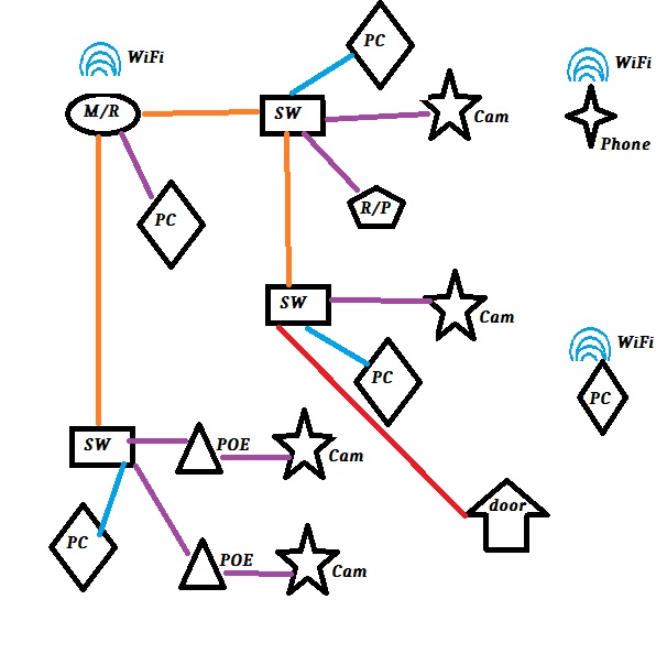

   / Camera Security Systems??? #95
This is roughly what mine looks like, as best I could do in a few minutes with MS Paint:
   / Camera Security Systems??? #96
Looks pretty straightforward .. what is R/P?
   / Camera Security Systems??? #97
You got great advice already, but, yes, that's exactly what you do. And as someone else mentioned, make sure the computer that's running the DVR software has a hardline, cameras generate a lot of traffic and it can overwhelm a wifi link if you have 5-10 cameras all trying to record at once to a DVR that's connected WiFi. Gigabit to the computer running the DVR and you'll be fine.
The way I've done it, I have 2 switches in my house, one is a 48 port gigabit for all my computers, the other is a 16 port POE switch for the cameras and APs. It's cheaper that way, a 48 port non POE and a 16 port POE is cheaper (or was for me) than a single 48 port POE and gives me 64 ports instead of 48. Then, over in my barn, I have another 16 port POE switch for all the cameras out there; that also powers the remote side of the wireless link. With any modern enterprise grade gear, you can just connect 2 switches together with a short cable run, no problem, and extend the capacity (note, there are implications of this that I won't get into because you won't run into them in a home network, but there are reasons that huge switches exist, connecting 2 switches together does have limitations, it's just that you almost certainly will never see them in practice in any home network).
