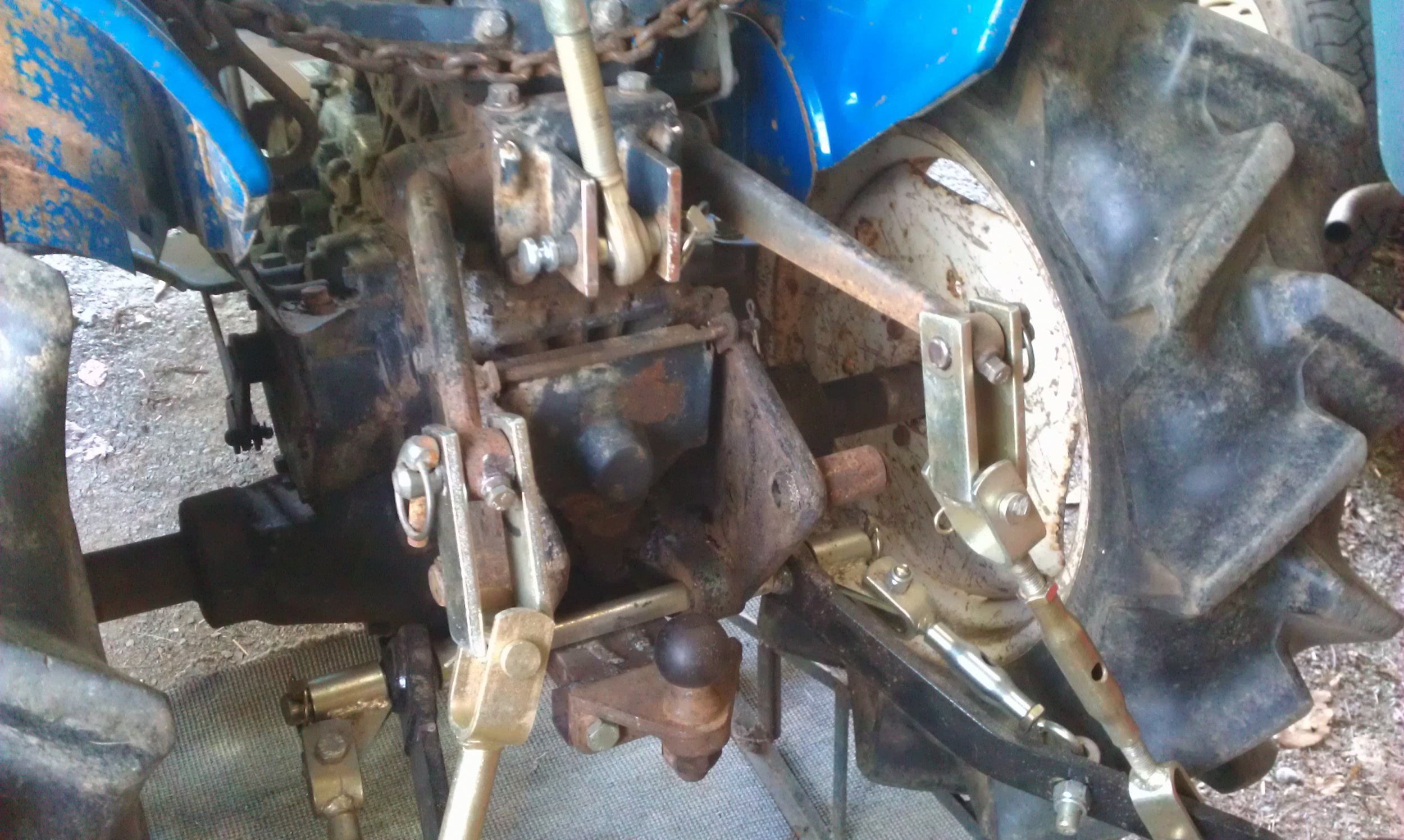

1- twinwheels really help,
2- realise counter weights on the front compensate for instability when lifting stuff on the rear and moving about on slopes,
3- most importantly when towing : attachementpoint should horizontally lay below the rear axel !
