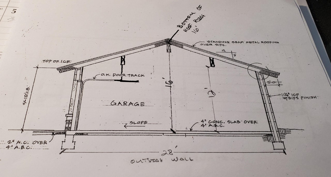

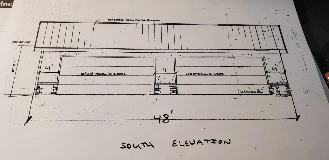

Attached is the lift I was looking at. Attached is my future garage build (48w x 28d). The overall car lift height is around 12' max. I was planning on placing the lift dead center underneath the glulam ridge beam. The ridge glulam beam is around 2' in height so that leaves me around 2' of clearance (16-2=14' 14-12=2') between the lift and the glulam beam.
With the roof slope and the other 2 glulam roof support beams, the height restriction drops to 12' but at that point it's still below the max of the lift so I don't see any issues with even a SUV or truck causing clearances issues with those lower beams. Only issue I can see is the garage door, when open, would interfere with a car on the lift. So I won't be able to open that bay door when there is a car in the air on the lift.
Any thoughts or input?
Get your door tracks following the under side of the roof. That way you would still be able to open door with vehicle on hoist. Sometimes called a high lift door track. Just a thought.

Or just install roll up doors. I put 3 - 12 x 12 foot roll ups in my shop with electric openers.
   / Car lift in garage #45
Rollups seal poorly and the insulated ones don't have much insulation. If you plan to condition the space sectional doors will work better.
The door rails can be as close as 6" from the ceiling.
I recommend drawing the building in sketchup or similar, adding a lift and putting your vehicles on it to see how they will fit. The design for my shop (in the permitting process, sigh) will have the inside walls at about 12' 4" which I think will give me enough clearance for a full size truck on a 2 post lift.
   / Car lift in garage #46
Mine seal well enough to heat and cool my shop. I actually thought they sealed really well until you told me they don't. I wouldn't put anything else up. They take up almost no overhead room and the best part is the operators.
12'4" may be enough. My Bishmon lift takes almost 13' but it has a top crossbar. I use a photo eye to protect the tops of vehicles.
