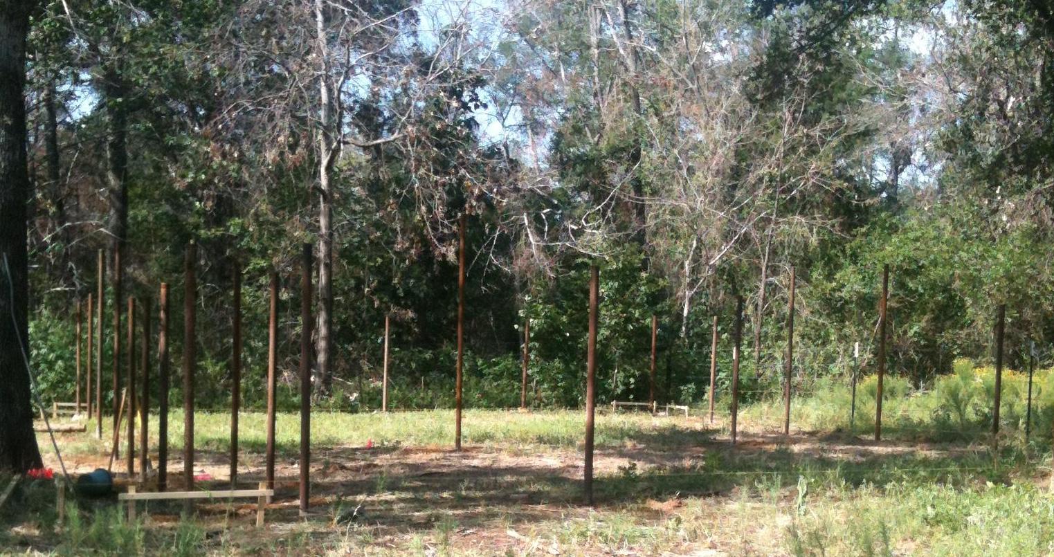

#13
Pretty much settled on foreman etex's suggesion regarding pen design. Got 26 eight foot 2-3/8" steel poles set in 2-1/2' concrete laid out 32' x 48' .... 2 - 12' gates(one for the inside 190 degree sweep). I have 2 10' poles on the west side to expand later with a gate if necessary. Now comes the hard part, headgate, escape gate and overall finishing of the chute area. I'll be catching up on the welding topics now. I'd love to finish it off with lag bolts and 2x6s but I need to learn to weld anyway. Penpoles.jpg
   / Cattle handling pen on a budget #14
Pretty much settled on foreman etex's suggesion regarding pen design. Got 26 eight foot 2-3/8" steel poles set in 2-1/2' concrete laid out 32' x 48' .... 2 - 12' gates(one for the inside 190 degree sweep). I have 2 10' poles on the west side to expand later with a gate if necessary. Now comes the hard part, headgate, escape gate and overall finishing of the chute area. I'll be catching up on the welding topics now. I'd love to finish it off with lag bolts and 2x6s but I need to learn to weld anyway.View attachment 272534
We picked up some 4in.channel for .86ft,saddled it out to channel, three high and welded the cattle panel to the 4in.side of channel. Another option is to use 1/2 in.sucker rod spaced around a foot apart all the way up. Ours is set up around a foot off the ground,(1st)channel,(2nd)2.5ft to center another channel,(3rd)another 2.5ft center channel, skip a foot top rail 2-3/8 pipe,so total height around 7ft.
Everyone is going to say weld with a 7018,just learning go p5+/6011 or you will stay pissed off sticking your rod:laughing: Auto hood and c-clamps if you dont have a helper...Tac all up then go back and weld out,looks/feels like getting more progress that way:D
