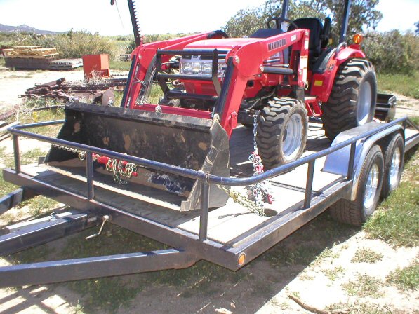

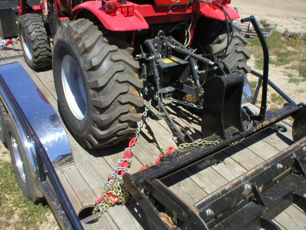

Nope, you're not doing it right.
Anything that isn't held in place mechanically (a pin for instance) must be chained to the floor of the trailer. A FEL or a backhoe is the perfect example.
Hydraulics alone isn't enough.
It must be held in place horizontally and vertically.
I agree, it's stupid, but that's the rule.
Typically you can get one over the bucket than thru the frame of the tractor in one chain piece. Not always, but sometimes. (works real well with SS's)
That is my understanding, there is no weight range for restraining a FEL or BH. As long as the machine has them they are to be restrained mechanically.
I don't agree that the idea is stupid because I'm sure there are valid reasons based on catastrophes that have ocurred due to lack of restraints.

< 393.128393.132 > Subpart I猶rotection against shifting and falling cargo *Question 1: If an item of construction equipment which weighs less than 4,536 kg (10,000 lb.) is transported on a flatbed or drop-deck trailer, must the accessory equipment be lowered to the deck of the trailer?
Guidance: No. However, the accessory equipment must be properly secured using locking pins or similar devices in order to prevent either the accessory equipment or the item of construction equipment itself from shifting during transport.
*Question 2: How should I secure the accessories for an item of construction equipment which weighs 4,536 kg (10,000 lb.) or more, if the accessory devices would extend beyond the width of the trailer if they are lowered to the deck for transport?
Guidance: The accessory devices (plows, trencher bars, and the like) may be transported in a raised position, provided they are designed to be transported in that manner. However, the accessory equipment must be locked in place for transport to ensure that neither the accessories nor the equipment itself shifts during transport.
*Question 3: A tractor loader-backhoe weighing over 10,000 pounds is being transported on a trailer. The loader and backhoe accessories are each equipped with locking devices or mechanisms that prevent them from moving up and down and from side-to-side while the construction equipment is being transported on the trailer. Must these accessories also be secured to the trailer with chains?
Guidance: No. However, if the construction equipment does not have a means of preventing the loader bucket, backhoe, or similar accessories from moving while it is being transported on the trailer, then a chain would be required to secure those accessories to the trailer.

guess its all up to the guy who pulls you over, glad ive got his number, way to much grey area.

While it may seem needless to secure the FEL bucket or a firmly attached implement it easier not to confer with a cop. These both seem like good uses for the ratchet straps I already own.
My friend got stopped by a Trooper because he saw the safety chains for the trailer were not crossed (wasn't aware that was a requirement). And got the ticket.
And...arguing with a cop is a sure way to get his back up and ensure you get a ticket instead of a lecture.
