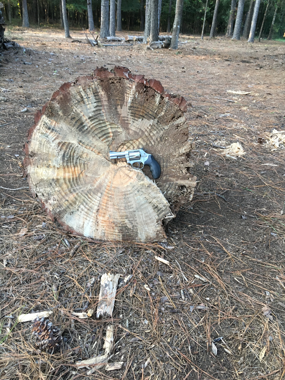

Wow, I wish I could find a revolver in a tree stump? Did you damage it much when you cut it? Or is that why your saws are dull?
Kidding aside, if indeed you have alot of 30" stumps, I'd be looking for more saw than you are considering. A 70cc class pro saw. Lot better cutting machines, lighter, and hold their value alot better
