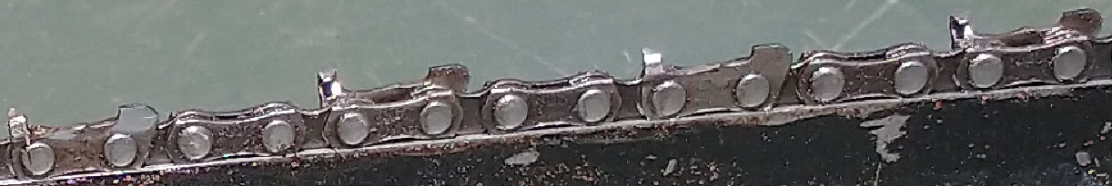

I know that chain was on it's last gasp. That's my trail cutting saw, so I'm often cutting stumps off on the ground. Here's what I use to sharepen my chains in between dealer sharpenings. It keeps my cutters and rakers in fighting trim
