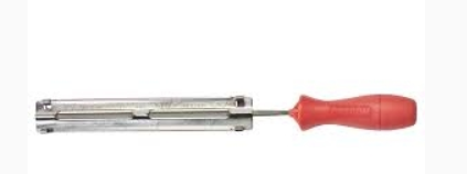

I really like the Stihl two in one files because the hit the tooth and the raker at the same time. They are a bit pricey but the files are replaceable.
Tomato / Tomaaato
They keep your file at the right height in the cutter, and trim your rakers at the same time,

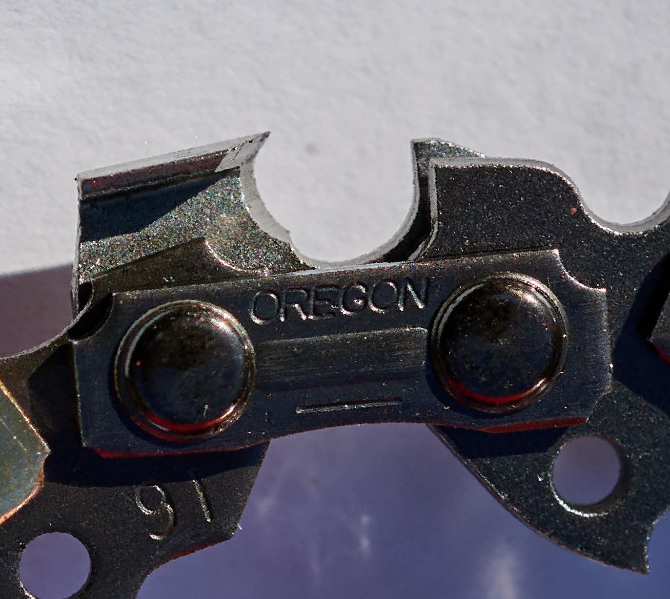

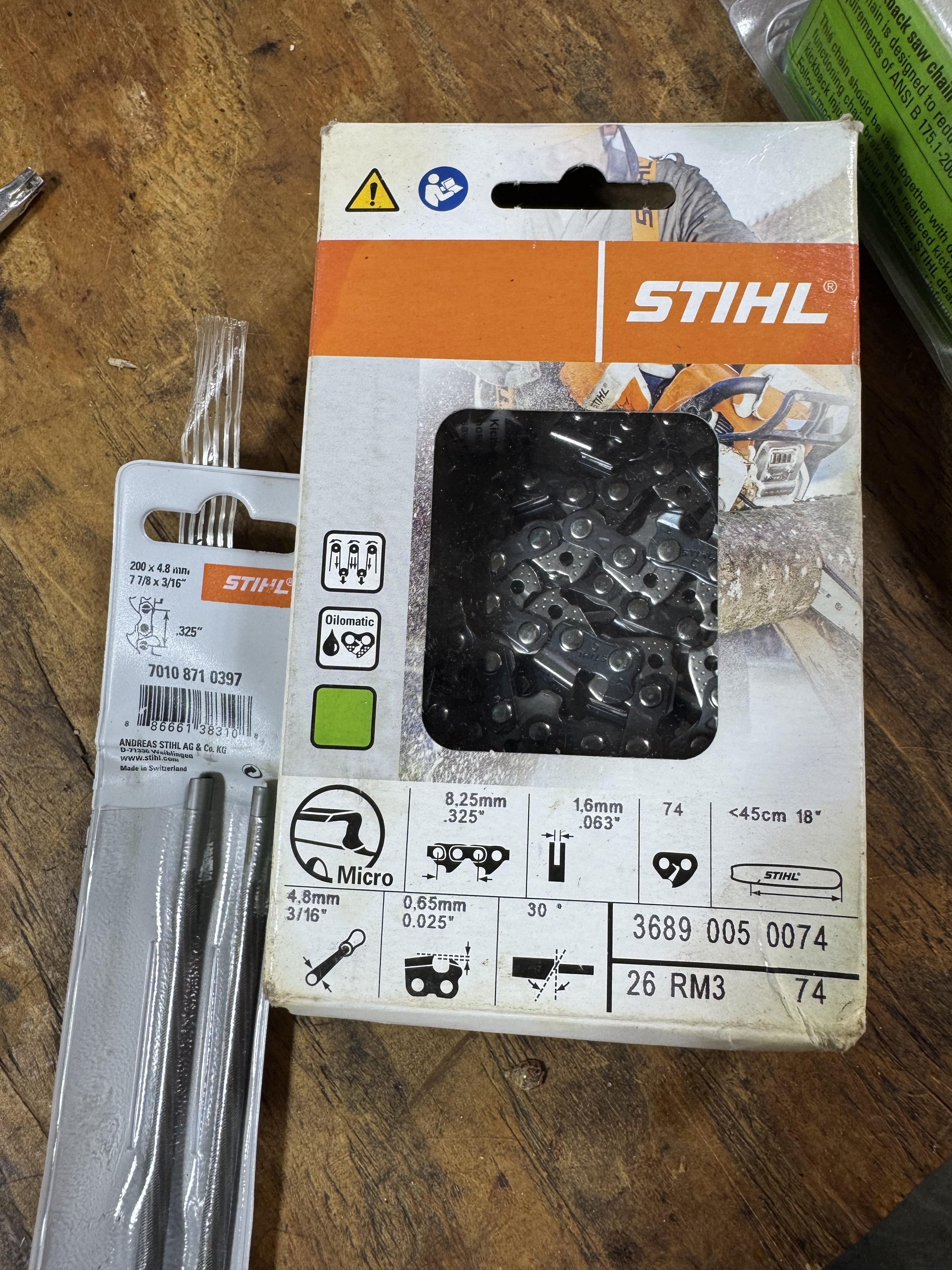

This a new factory gullet profile out of the package for my echo. The package says to use a 5/32 file to sharpen. I don't know what chain you have.
I was resistant to buying the 2 in 1 file, but it has helped me.

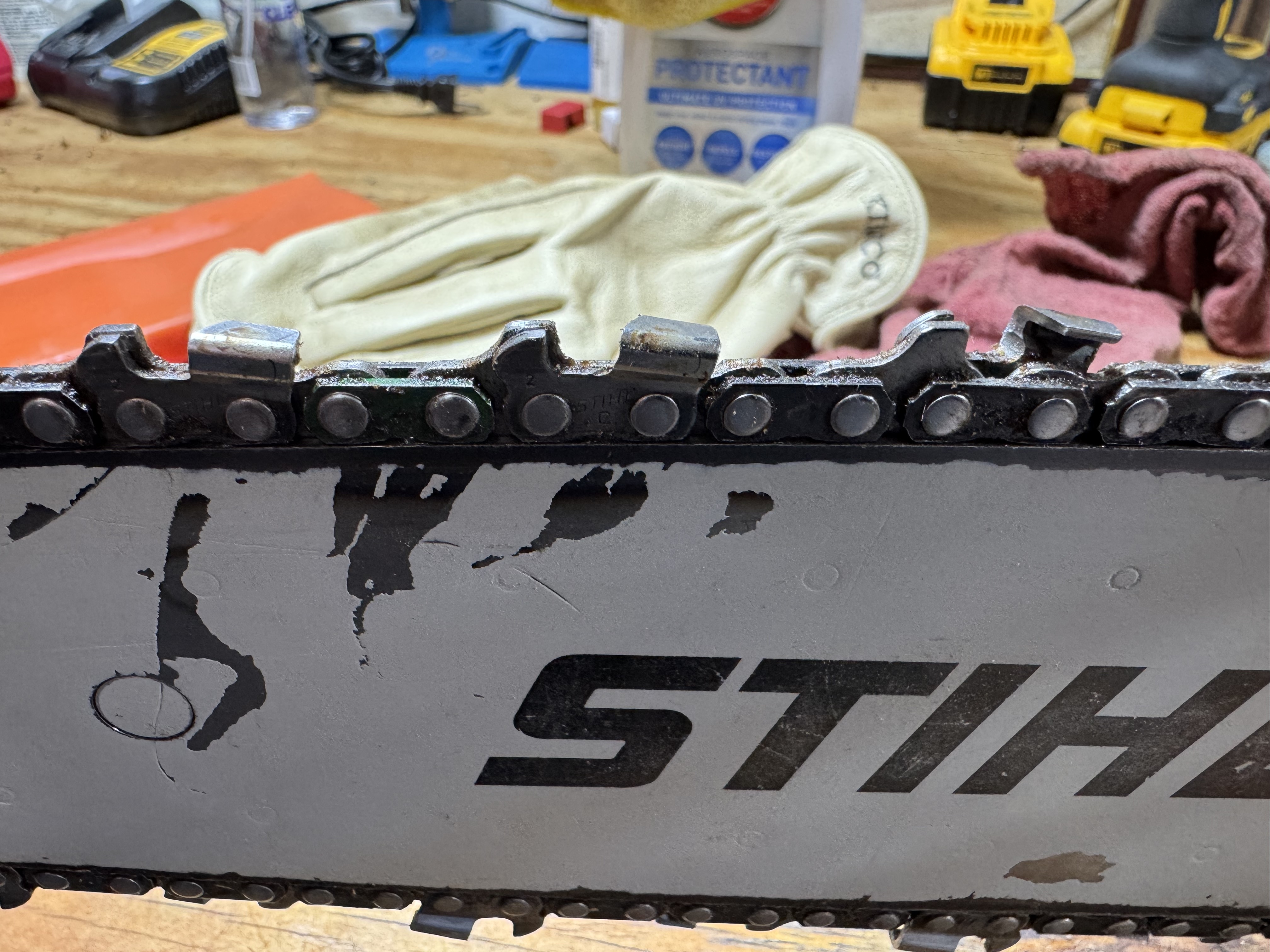

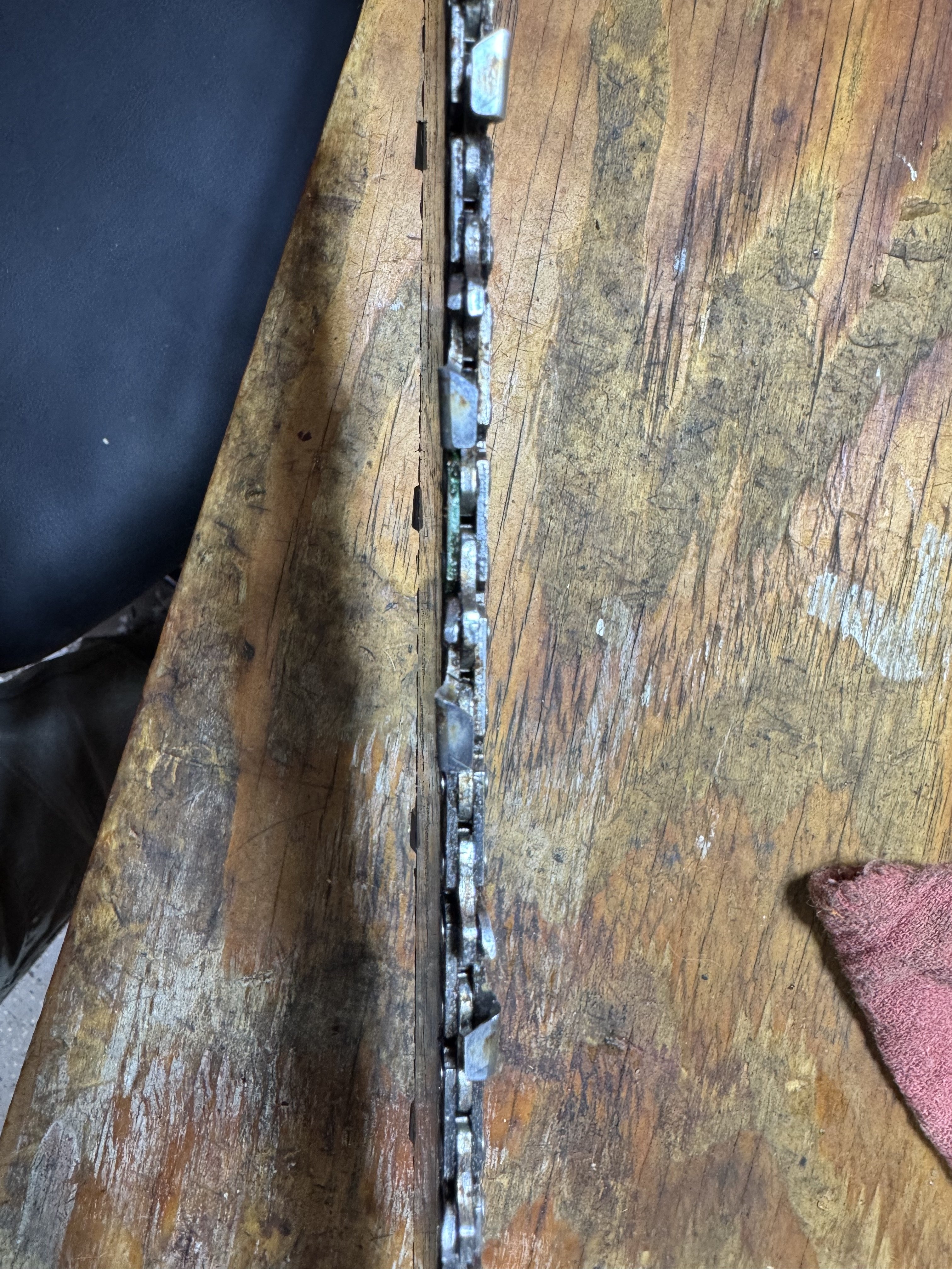

I’m using the correct file, here is a picture of a new chain on the tag on the files I bought.

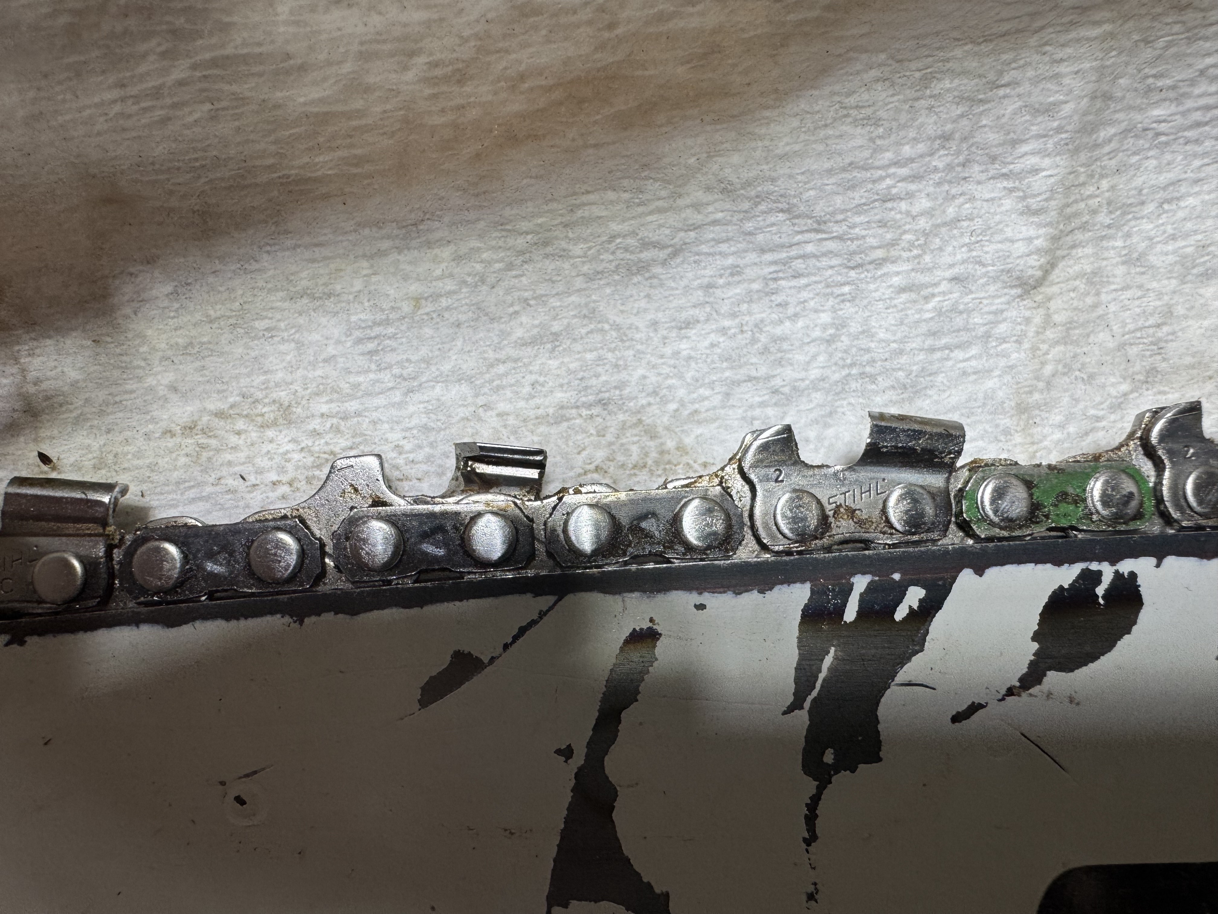

A couple of pictures of teeth. I compared to my new chain. I feel the first picture I’m close on the sharpening, the second one the tooth seems straight up and down with no curve.
/ Chain sharpening difference? #84
Are you sharpening only using a file by eye? I think what has happened is the correct profile got lost while sharpening previously. In my situation, I'd cheat and use the electric grinder to get back a uniform profile.
I suspect the guys who successfully sharpen only using a file have done it so much that they've trained their muscle memory to be almost machine like in their sharpening technique.
Tempted to say cut with it if it cuts okay, but try to get the C back next sharpening?

Without seeing you file, I can't tell if the following might be your problem. However, I have seen a number of people hand-filing with this problem, so I thought I'd share:
One common error when hand-filing is not keeping the file in the same plane throughout the stroke. Some people tend to push down on the handle as they stroke, tipping the file like a see-saw. Even with that guide trying to set the correct depth for you, if you push down on the handle end, the other end rises up. This can wipe out the point that should be on the tooth, leading to the flat looking side plate shown in some of the teeth in your picture. In addition, If you are more prone to do this when filling left-handed vs right-handed, you'll file the teeth on one side differently than the others, causing the chain to cut on a curve.
When filing, be conscious of moving the file in a straight line. You can help yourself learn the muscle memory for this by putting the saw in a vise to hold it while sharpening. (I use a stump vise, or you can clamp the bar in a bench vise, as long as it leaves the chin free to move). This frees up both hands to hold the file. One hand on the file handle, the other on the fr end of your file/guide. Instead of providing all the power for the strike with the hand pushing on the handle, think about providing half the power by pulling with the hand on the other end. (While learning the feel, you may even want most of the power to come from the pulling hand.) That two-handed method helps assure that you have a smooth, level stroke.
This problem can happen whether you are freehand filing with a round file, using the clip-on guide or using the Pferd Chains Sharp CSX/Stihl 2-in-1 (which are the same thing). The roller guide does help avoid this, since if your file is not held in the appropriate plane, it will lift up off one of the rollers.

I’ve been sharpening my own chains for 25 years. I was thinking I was getting good results but I was probably just getting adequate results. What brought this thread up was I noticed my smaller saw was cutting better than my bigger saw.
@John_Mc I think has hit the nail on the head. I’m just not paying careful attention to it. Part of its laziness. I have a vise, I just don’t bother with it. I’ve been cutting up a lot of hardwoods lately, some of it 24 inches in diameter or bigger and it’s has some dirt on it. I think this has brought my mediocre sharpening techniques more noticeable.
Your never to old to learn. It’s easy to say I’ve been doing it this way for years I’m good. I’m going to try John_Mc techniques.
Thanks everyone for the helpful answers.

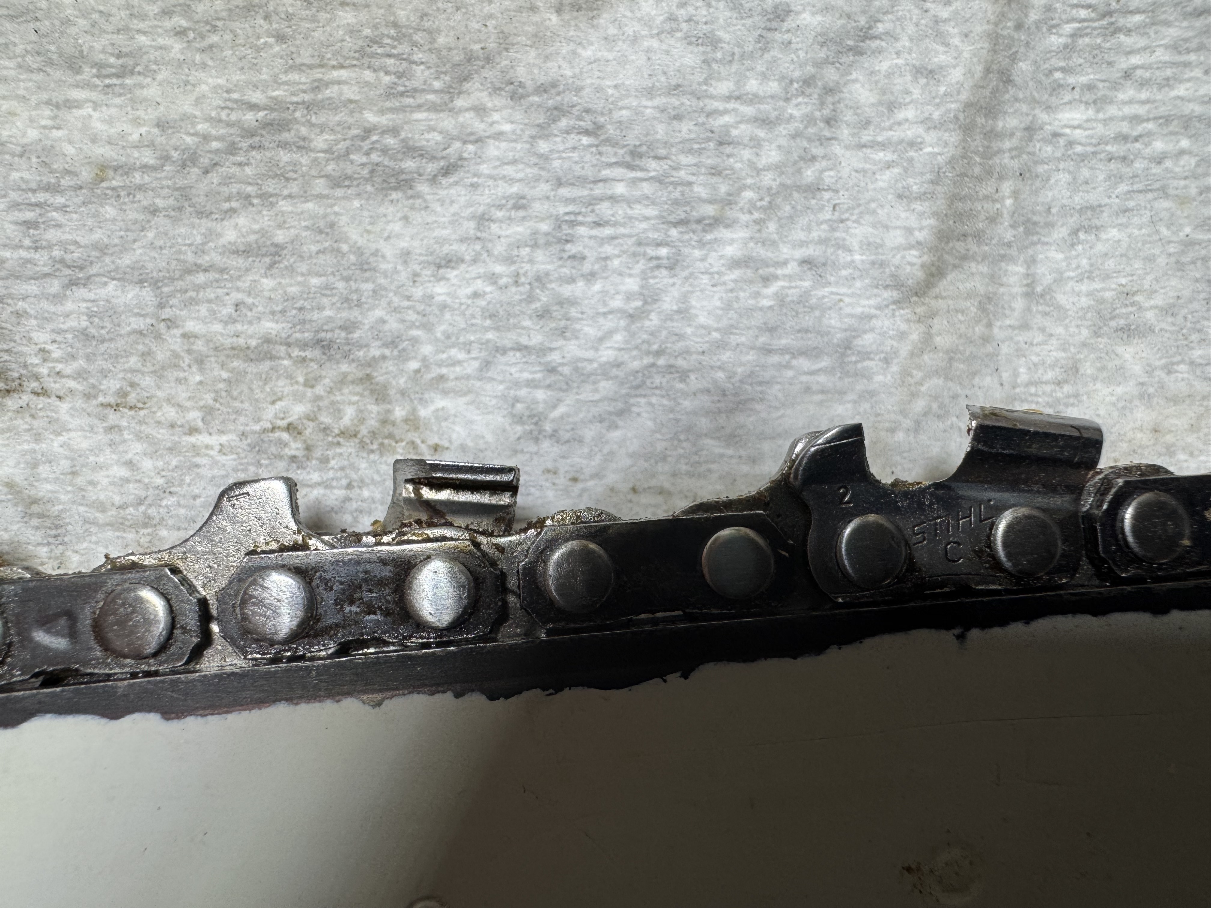

Here are a couple of pictures. I sharpened it a few days ago before I put it away.
View attachment 2907774View attachment 2907776
Looking at the top picture it looks like the top tooth shows signs of file wobble. The next tooth down doesn't look bad, and the bottom 2 teeth need another stroke or 2 because they are still showing damaged metal. The bottom picture shows not enough hook created by the file. Either riding too high with the file, or wrong size file will cause that.
