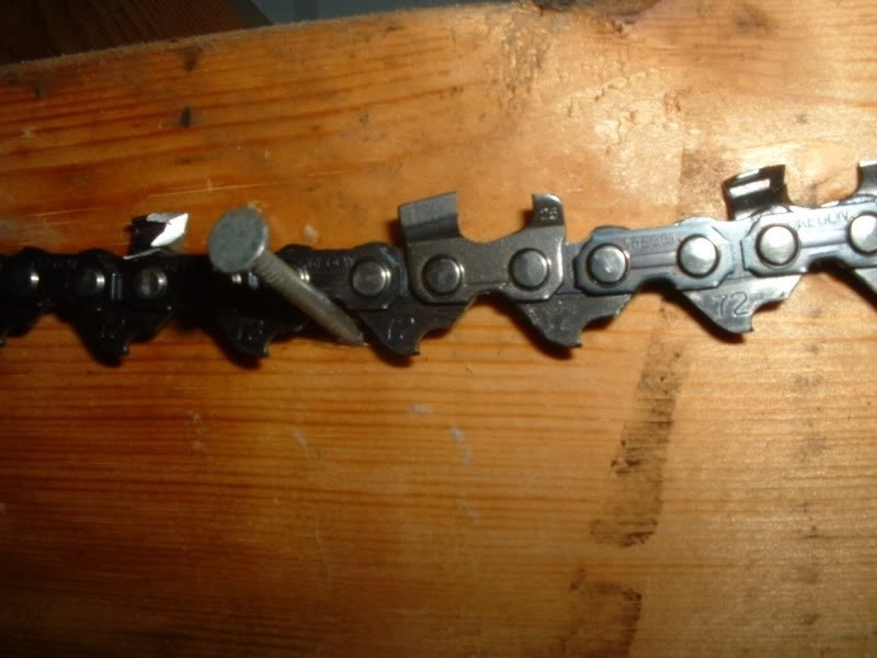

Got a picture of the cutters?
I’ll get one. I appreciate everyone’s answers. Self criticism can be tough. My initial reaction I’m sharpening the chain correctly but I wouldn’t be posting here if that was 100% true.

Here are a couple of pictures. I sharpened it a few days ago before I put it away.

Those gullets don't look to have the right profile and rakers seem a bit tall to my eye.
/ Chain sharpening difference? #73
I don't like these round edges tooth chain, I much rather the square tooth chain... round tooth are good when working in dirty stuff and are easier to sharpen but doesn't bite nearly as much.

I see what you mean about the gullets, I’m letting the file ride to low. I can actually see things better in the photo than I can with my eyes.
I actually think if I took the saw out with the chain like it shows in the pictures it would cut well but that doesn’t make it right either.

It looks to me as though you are letting the file ride too highand/or might not be using the correct file size. Your side plate should have a bit more of a "C" shape than is apparent in those pictures. It could just be the angle from which your picture was taken. I'd suggest comparing the profile of your chain to a new one.

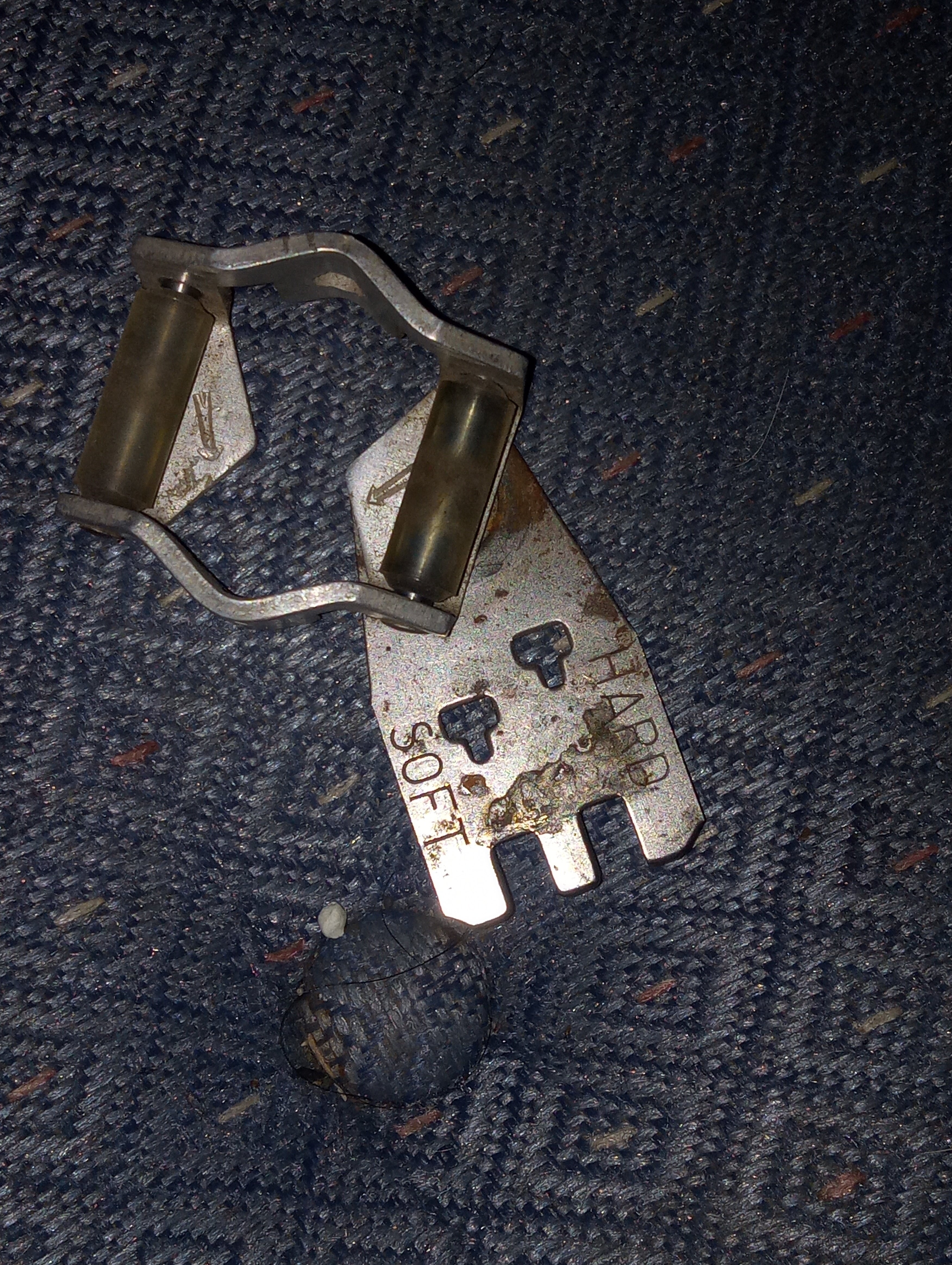

What pitch chain are you using, and what size file? Are you using any sort of guide when sharpening or setting the depth gauges?
@dodge man - you mentioned that your normal practice is 2 passes per tooth. When sharpening, it's important to go until the tooth is actually sharp, not just a set number of strokes of the file.

I’m pretty sure I’m using the correct file size. I can check though. I’ve got a brand new chain I can look at. I get decent results after I sharpen but I suspect I’m not doing it a 100% correct, I can do better. A picture of what I use to sharpen with.
/ Chain sharpening difference? #79
I also wonder if you need a larger file to sharpen the full gullet? I like the two in one files.
