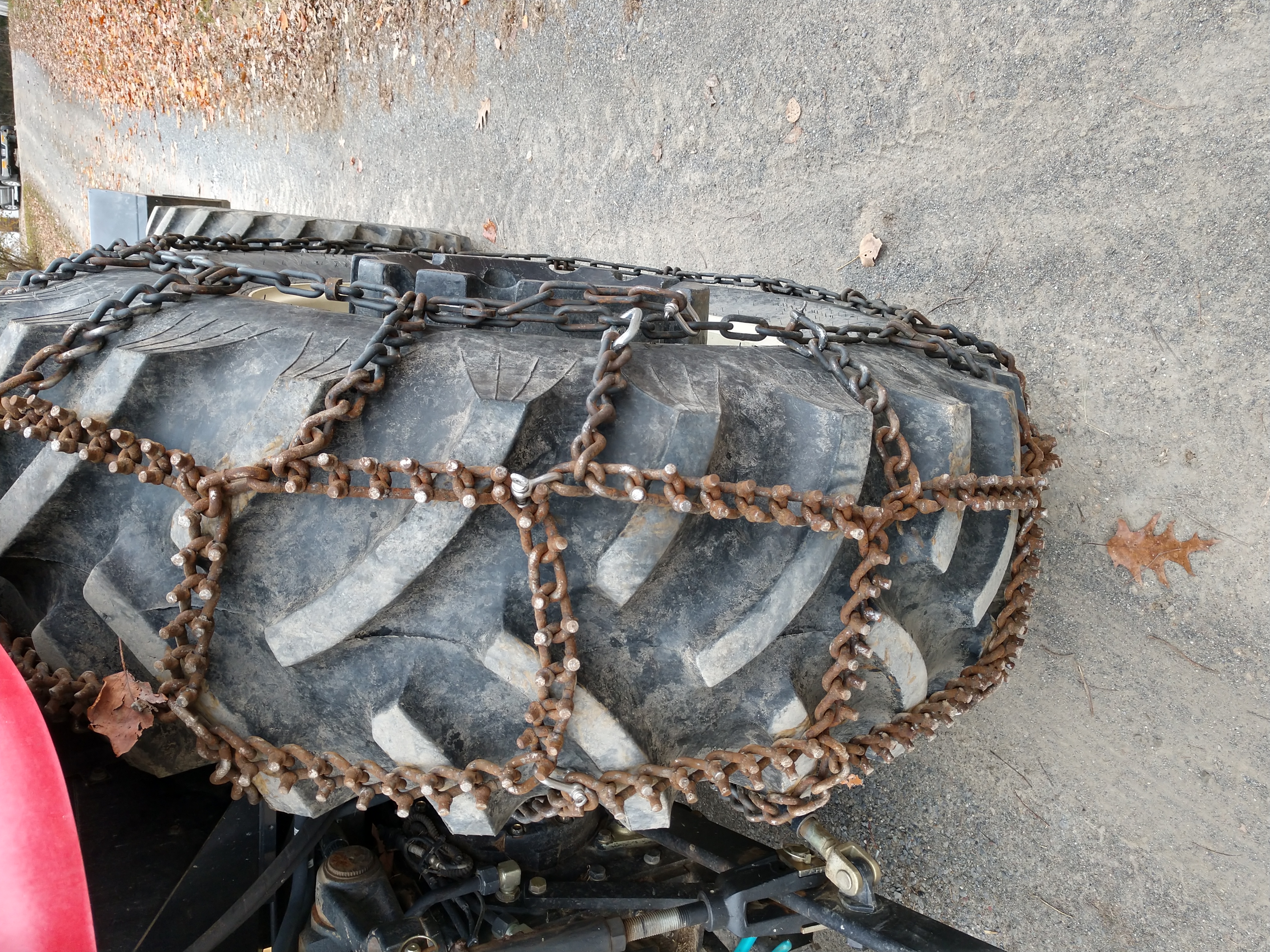

I started off with 4-link V-bar, ladder-style chains on my rear tires (R4). It worked fine for going up and down my driveway, but lateral traction left a good bit to be desired. Because of that, they were not good to use on rough terrain or in the woods: I found myself sliding sideways, always at the worst times.
I switched to duo-grip chains with V-bars. These greatly improved the traction on side-hills and worked well both clearing snow from my driveway and working on rough terrain in the woods. However, the ride at even moderate speeds on hard ground felt like it was going to shake me (and the tractor) to pieces. Since I regularly need to drive the tractor some distance over the roads, the Duo-grip chains were just not an option for me. (I have filed rear tires. I've often wondered if it might have been acceptable with an air-filled tires, particularly air-filled Turf tires, which are more flexible than R4s.)
I ended up with the "euro-style" studded chains (OFA EKO 8, there are similar chains made by other manufacturers). Good forward and lateral traction, and great both off road and over the road. They nly downside is that they are more expensive than the other styles.
The last paragraph up there is what you need;
excellent traction, side grip, and a quality ride.
They will ride almost as smooth as not having chains on.
I have used 2 link and 4 link space v-bar and street chains and even old double ring chains the Euro style will beat all of the others hands down.
