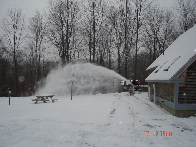

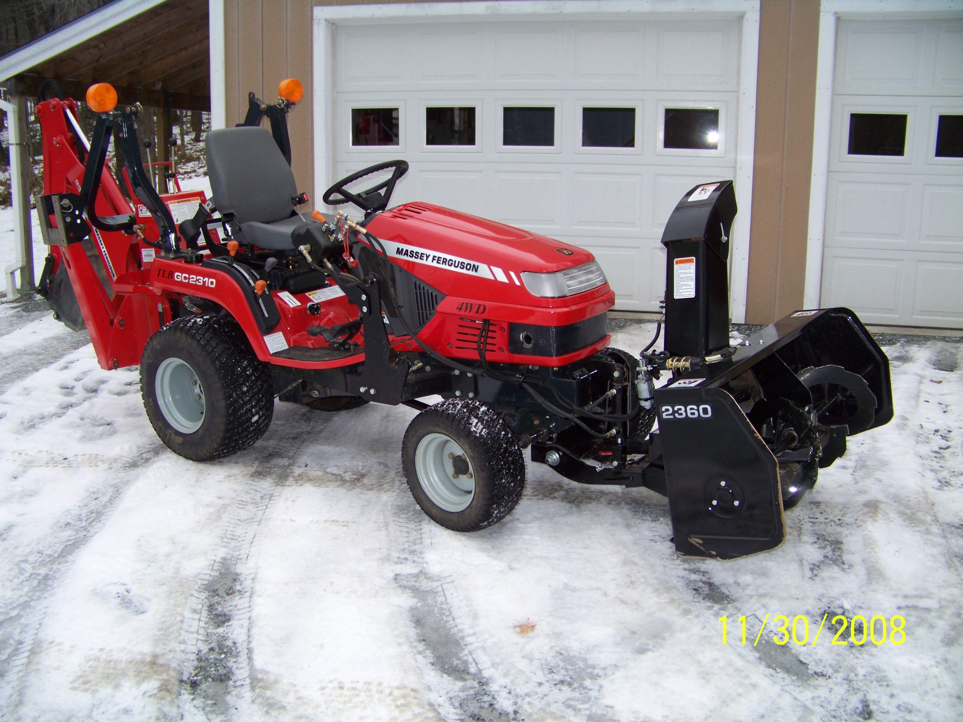

My 3-1/2 cents.... I firmly believe a snowblower is much more efficient than a bucket- I bought my tractor specifically for that purpose, and have been very pleased. I take the FEL off in late fall, put the blower on, and seldom need the loader after that-- think I've put it on in the winter a couple of times only. (I'm assuming you've been using a walk-behind blower like I used to; there's really no comparison between that and a tractor-powered blower!!)
Concerning chains... I use my backhoe for rear ballast, and have not needed to use (yet) the chains I purchased for the rear when I bought the tractor. It has 4WD and turf tires.
With Ag tires, if you need/want chains, you need to have the type that will not simply sink in between the ribs- do a search on this forum and you'll find some great info concerning chains.
