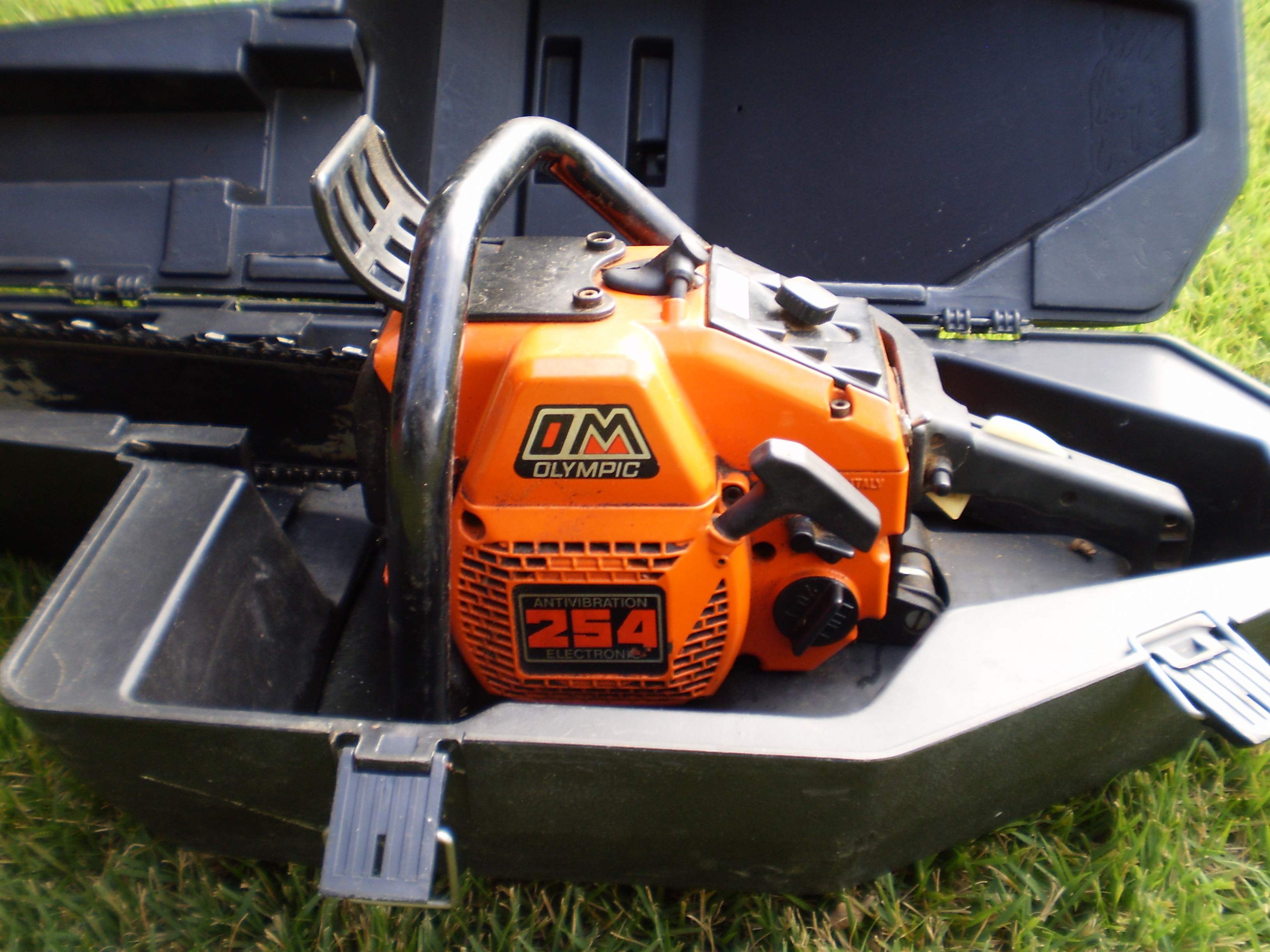

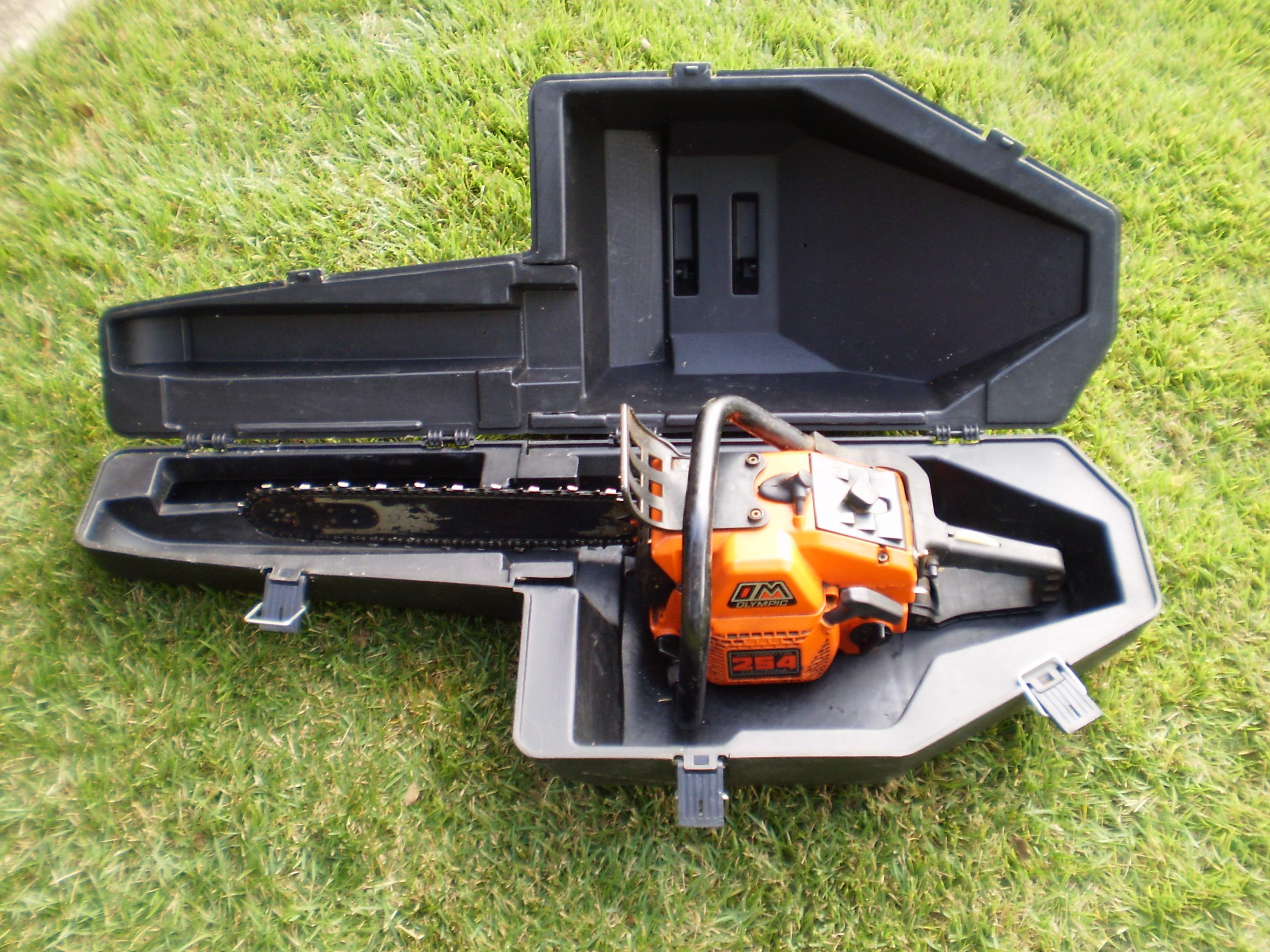

I also have an old chainsaw that was given to me 20+ years ago. The story behind it is that the guy who gave it to me had been given it by a coworker of his but my friend was too scared of it to use it. His story was that the guy who gave it to him got it from his dad. His dad had a contract with the US Coast Guard to clear brush on a base somewhere (New England, IIRC) and the USCG gave him a new saw every couple of years. I did a little searching on the net and it's an Italian made saw...it's in the shed, it's dark and not worth going out with a flashlight to look at it. I'm guessing the saw is ~25 years old. I used it to take down a wild cherry tree right after I got it and put it away. Obviously, it won't start now and I don't know if it's worth the work (if I can do it) or expense (if I have to pay someone) to get it running.
The saw came with a nice blow-molded case, a couple of hand tools, chainsaw file, a nice pencil-tip grease gun and 3 used chains. One of the chains was obviously never used after sharpening and the other two are in need of sharpening before use - if they were to be used again. Once I got the sharpener tuned up, I put one of the chains in to try the sharpener.
The chain was all gunked up but with not much, if any, pitch/sap on it. I sprayed it down really well with WD-40, wiped it down with a couple of those blue paper shop towels and blew it 'dry' with compressed air. On closer inspection I'm not sure the chain is in very good shape. Some of the rakers are bent sideways a bit and a couple appear to have been filed down. I figure it's a good candidate for fine tuning the sharpener and practicing.
Would the old chainsaw be worth time/money to get it running? Do you clean your chain before sharpening? If so, how clean?

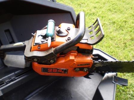

If you post the make and model of the chainsaw, it's likely we can tell you something about it. Also, we loooove pictures. :)
Here it is. The pencil-tip grease gun is sitting on it in one of the pics.
Make is Olympic and it appears the model is 254. It says "Made in Italy" on it.

Here is some info about that saw.
Model Profile: 254
As far as weather its worth it to fix....depends on what it needs. If it ran when put away, odds are the cylinder, piston, and ring are just fine. See if it turns over. Pull easy on the rope. If there is any resistance, put a little wd40 down the spark plug hole and let it sit.
But odds are it just needs a carb cleaning or carb kit. which is $7 with free shipping on ebay Carburetor Rebuild Kit for Tillotson RK 23HS for Tillotson HS Carburetors | eBay
And might need a few bucks of fuel line and a fuel filter. But if the motor turns over freely and has compression, I'd say its worth investing ~$20 to see if she will live again:thumbsup:

Thanks for all the info, LD1. I've printed out the info in your link. Interesting that it's 32-35 years old. Yep, it ran fine when put away and turns over easily now. I need to clear a couple of other projects off the bench so I can tear it down and see what it looks like. For the amount of use I expect to have for a chainsaw, it's definitely worth $20 to get it running again.
