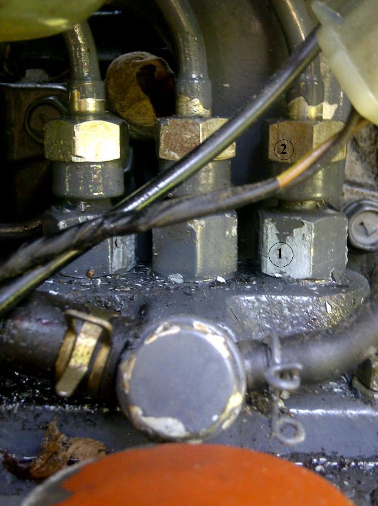

.. No luck. I just can't get a good flow. No pressure. Really not much coming out only little spurts now and then. ....
econ: Please understand that an IP never delivers any substantial "flow" of fuel. This precision "pump" is designed to deliver a very small. precisely measured, amount of fuel to each injector just before the associated piston reaches top dead center on the compression stroke (once every 2 revs). However a healthy IP will produce thousands of PSI (if needed) to push that small amount of fuel through the injector. We're talking drops here. "Little spurts now and then" could well be a description of a healthy IP. But you should see essentially the same behavior from each of the three feeds at the top of the IP or at the injectors. When this thread started, I understood that the fuel feed from the IP was zero, not spurts.
The injectors are designed so they only open after the fuel pressure reaches about 2200 psi. The IP must be able to push out that tiny measured amount under this extreme pressure but it pushes the same tiny amount at zero pressure too.

If you get a good fuel flow when you crack B-nut #1 and crank the engine but nothing when you crack B-nut #2 and crank the engine then either the SS is jammed or the IP is bad. But I emphasize, proper "flow" from nut #2 should only be a little "spit" every other turn of the engine. If you get an actual flow from nut #2, the associated delivery valve (probably a broken spring) isn't working right.
It's a shame you can't just replace a $2 spring vs buying an entire $800 IP but that seems to be the way it is unless we find a parts source and/or Diesel shop that will work on these things.

Well I am finally convinced it's the IP. I bought a specialized adapter so I could crack open the middle line at the cylinder head. Nothing.
