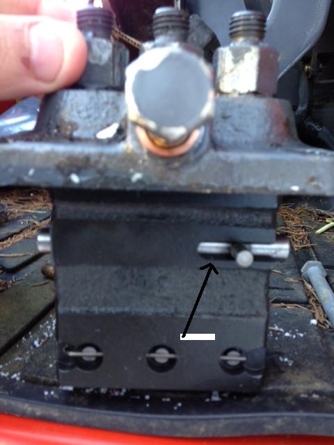

First item: The lift pump pushes fuel into the IP's fuel chamber under, maybe, 20 PSI. When the feed hole aligns with the vertical slot (shutoff condition) this fuel flows through the feed hole, up the slot, and into the delivery chamber (space above the plunger). See #1 and #2 in the photo in post 36. Now, if you crack the nut at the bottom of the delivery valve, that breaks the seal between the IP and delivery valve allowing fuel to flow out (under the 20 PSI of the lift pump). But it takes a lot more than 20 psi to open the delivery valve so nothing will come out if you crack the nut on the top of the delivery valve (which connects the delivery valve to the pipe). And the IP plunger cannot develop higher pressure (like 2000 PSI) because the slot provides an open passage between the delivery chamber and the fuel chamber.

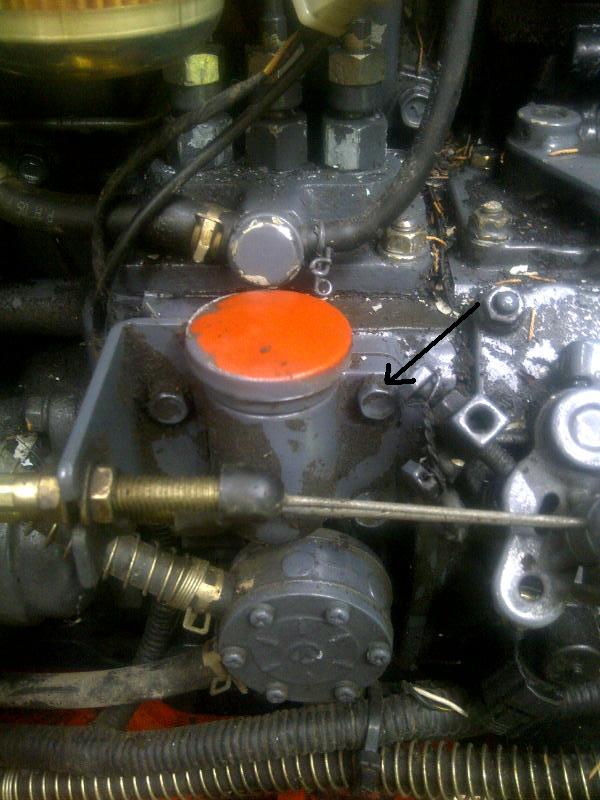

Econ, The fact you get fuel at location #1 but not at #2 (referring to your photo) while cranking means a) fuel is getting to the injection pump (IP) and b) the IP is not pumping. This means either c) the shutoff solenoid is holding the IP rack in the off position or d) the IP rack is jammed internally in the off position. I believe you said you checked the shutoff solenoid and it is OK. So you need to check to see if the IP rack is stuck. There are a couple different configurations but look a cover on the block plate just below the IP. On the newer models the oil fill cap is on this plate. On older models the shaft for the manual and electrical (stop solenoid) engine shutoff runs through this plate. Remove the plate and you should see the fuel control rack pin. Try to move this pin (left and right) using light to moderate force from one or two fingers. If it's working normally, the rack should move smoothly against spring pressure trying to push the rack on the full on (right) position. Possibly, something is jamming the rack and you'll be able to shake it lose. But if the rack stays jammed (you can't move it) the next step will be to remove the IP to see what's causing the jam.
I recommend you use a service manual if you need to remove the IP and also a digital camera to document the exact position of the various levers and springs during each step of IP removal. IP parts are not separately available and a new IP costs over $1000, sorry bout that. However, if the damage is limited to the gear(s) that rotate the plungers and the teeth on the rack are 100% OK, it is possible (someone reported) to disassemble the IP and rotate the damaged gear(s) 180 degrees (so undamaged teeth engage the rack) and reassemble. One caution, the plungers and the cylinders are matched sets so always keep each plunger in the original cylinder.

To make sure I have this correct. Remove the 4 bolts (highlighted 1 bolt in picture) that surround the oil fill (orange cap). Find the lever and try to manually move it. Try not to get frustrated and rip it out :) .
