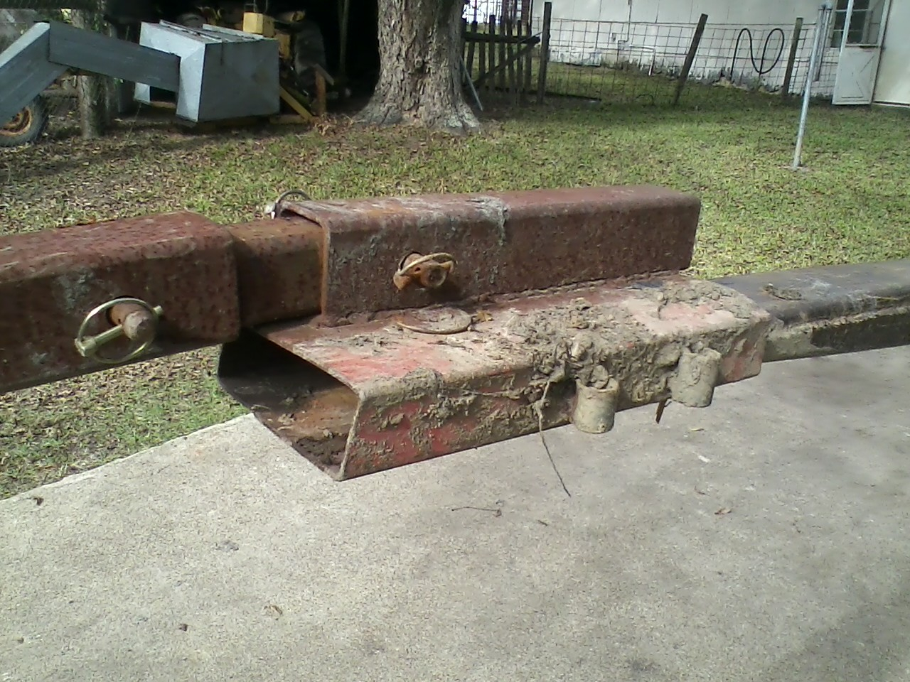

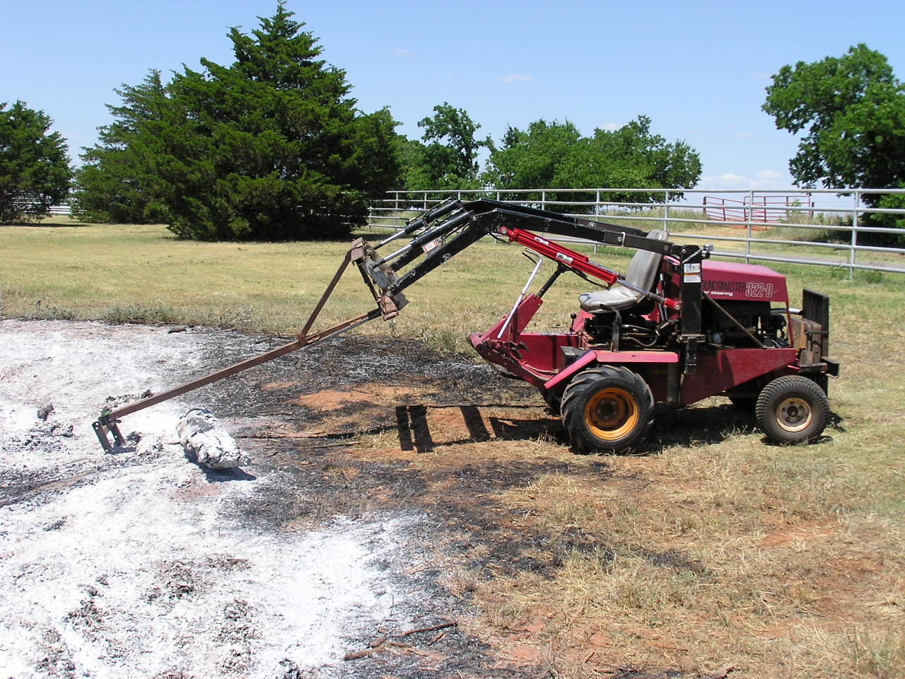

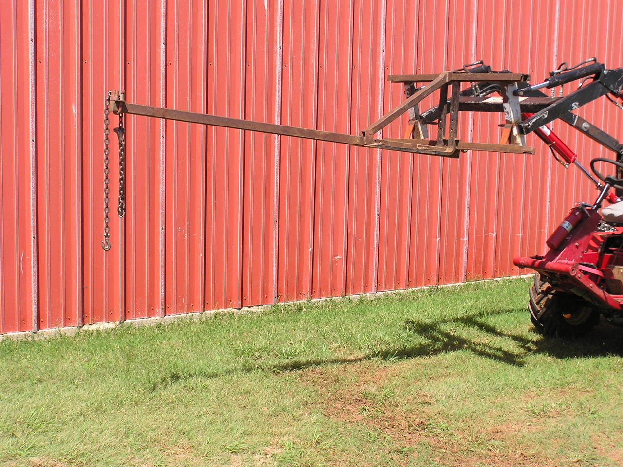

I’m thinking that there may be a method to use the front loader with some sort of rake attachment to pull that debris out

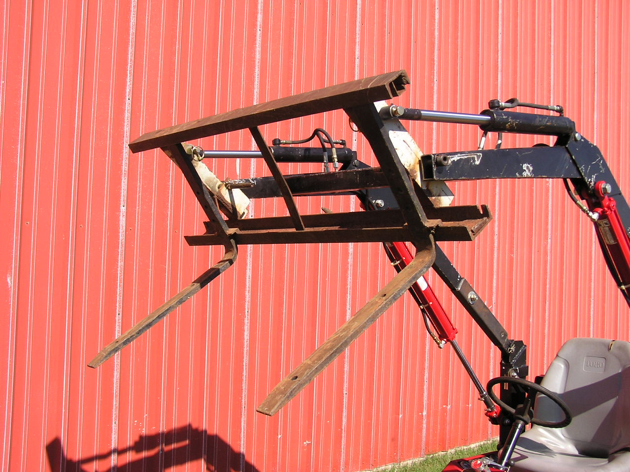

The short forks:
The long piece of square tubing that attaches to the forks:
This is one thing that I used it for:
/ Clear a logjam
Thanks for the reply. This is a novel approach to use on the forks.
/ Clear a logjam #4
Forks are a good idea, I would be very careful if extending a boom off the FEL and trying to lift with it.

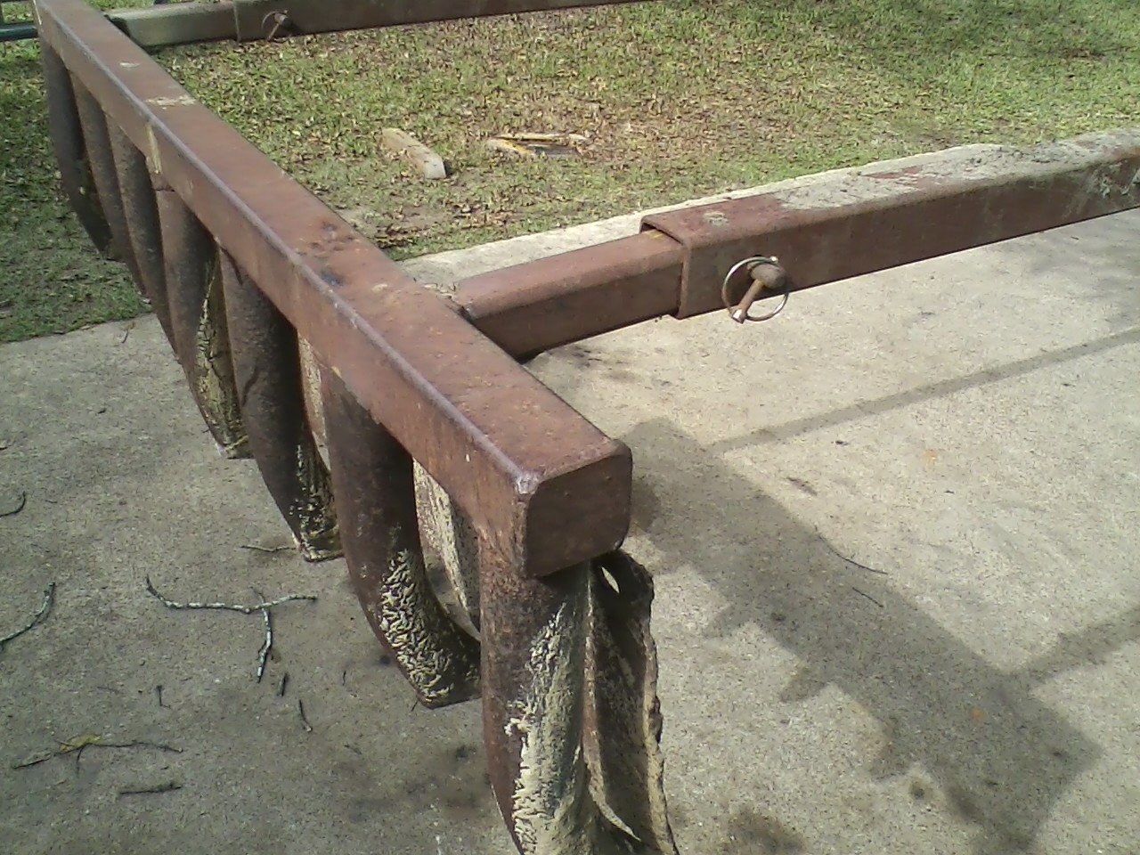

We have a creek that runs through our property. To access the backside we had to build a bridge about 30 foot long to get across. Recent rains have caused a log jam at the bridge support pilings. Has anyone built an attachment that either will go on your bucket or if you’ve taken the bucket off and built some thing to fit where the bucket would attach to the front loader. I’ve used a winch to pull out some of the debris but I’m thinking that there may be a method to use the front loader with some sort of rake attachment to pull that debris out discussion and pictures would be appreciated. I have a Kabota MX 5400. thank you
We built, what we call a beaver rake, to clean out the creeks or ponds
with. Can be mounted on the end of forks, 5' extensions, 10' extensions, or both is 15' extensions. Will reach over 20' from front wheels.
