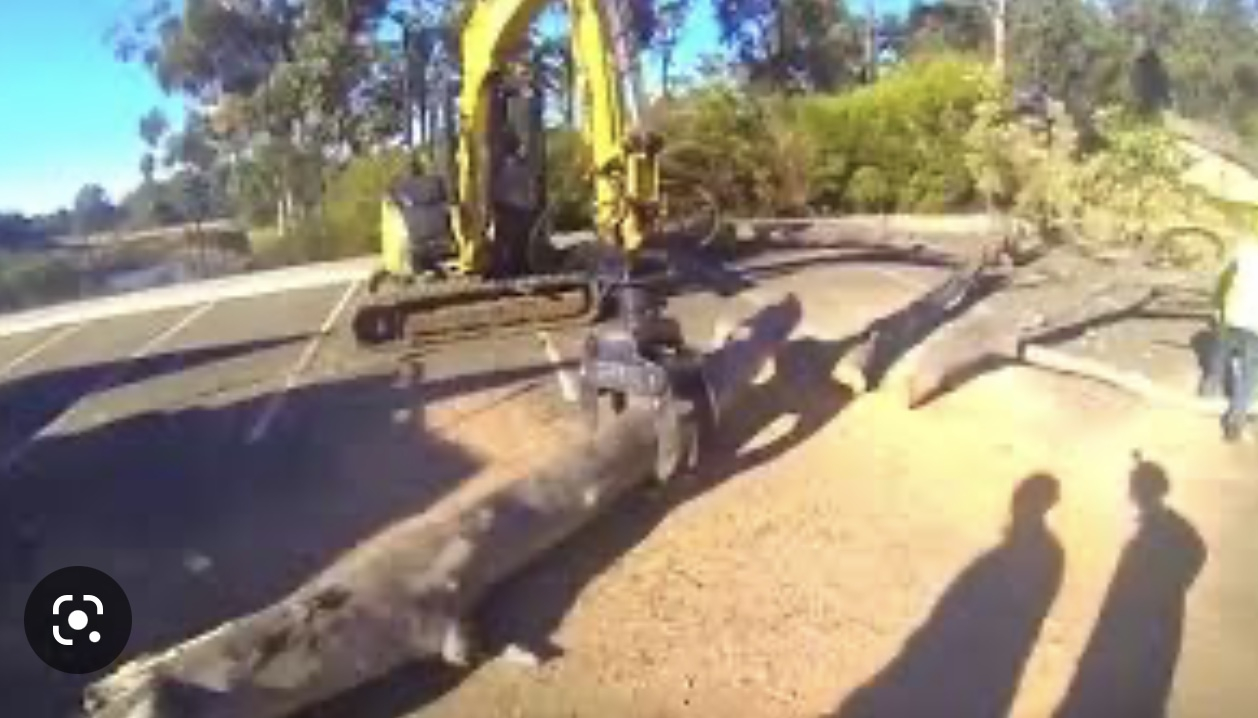

Use a digger with a thumb. The size of the logs will dictate the digger size. What weight is the bridge rated for? Maybe hire a "Long Reach" (16 metre) digger.
Rent a Mini-X with a grapple and rotator for handling logs. Thumb only works well when logs are perpendicular to the boom.
