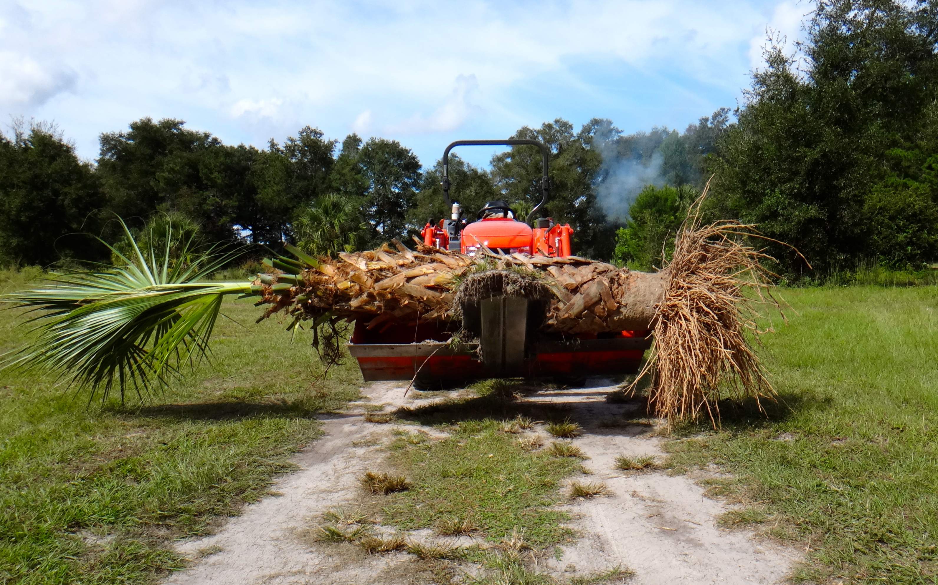

Hi, I have several small fields I need to plow and disc to prepare seed bed. About 4 years ago it was Forresty mulched. It had previously been tree farm and had 15 years or so of no maintenance so was full of overgrowth. Mostly bay trees and various scrubs. All those small stumps and roots are still in the ground. I thought they would be rotted enough by now that it could be turn plowed but my TC33D with a MF 66 2 bottom is really struggling. The plow keeps getting fowled with roots etc. I’m in central florida so also a lot of palmetto roots. Any ideas?

The 'right' answer is probably to root rake everything, and then disc. If the area us pretty small; maybe remove one of the plow bottoms, to reduce fowling and help it pull?

Palmettos I know. Often grows in layers, 1-2-3-4 plants deep.
In my opinion your tractor is just too light. Plow fouls because tractor/plow combination lacks inertia/weight/power to pull through. My 3,700 pound bare weight 4-WD Kubota L3560 would stall moldboard plowing in your conditions.
I suggest finding someone with a 5,000 pound, 6,000 pound or heavier bare weight, 4-WD tractor to contract plow, then root rake your fields (secondary tillage) with a Field Cultivator. A Field Cultivator will rake 14" deep.
A FEL bucket spade is effective digging out Palmettos but requires at least a 3,700 pound bare weight tractor, preferably with a thick, heavy duty bucket. Even teamed with my Kubota RTV500 utility vehicle + dump trailer, clearing Palmettos is a slow, one-at-a-time process. I burn excavated Palmettos.
I have never seen a heavy, primary tillage Chisel plow in Florida but that does not mean none are here. A primary tillage Chisel Plow behind a 8,000+ pound bare weight Utility category tractor might penetrate 14" in sandy-loam and pull most of that unwanted stuff mostly to the surface.

I was thinking about that. Right now I’m making multiple passes with the depth starting shallow and the getting deeper each additional pass. I’m walking the field and picking up the roots etc that are being turned up. I have 5 fields that are all 5 acres give it take each. About 30 acres total.

4 wheel No super steer. I have the 7308 FEL mounted and am loading the bucket with the debri so it might have an additional 150 lbs or so. Tires are not loaded - no other weight except the plow. It’s heavy - maybe 400lbs

Yes sir - a lot of work. I’ve used the rippers on the box blade with some success. Out in the fields there aren’t any really big palmettos. I’ve kept it mowed down regularly so far the biggest clump of root was about as big around as a gallon paint bucket but only a foot or two long
You might want to seriously think about getting a field cultivator with spring loaded tines (not a row cultivator with fixed tines). Hopefully the springs give before you break a tine or damage your tractor.

Both around 5,000 pounds bare tractor weight. Both 2-WD.
Depending on what tires are on the 5,000 pound tractor you acquire you will likely need a 16" wide plow to make furrows sufficiently wide to accommodate approximately 15" wide rear tires. A 16" wide plow will turn soil 7" to 9" deep in primary tillage, so a relatively light Field Cultivator will not be overstressed raking an additional 6" deep (to 14" total depth) in secondary cultivation, following the plow.
A Field Cultivator is one of several types of conservation plow. The Field Cultivator and its heavier relation, the Chisel Plow, are both used for conservation tillage.
The chisel plow is a implement used to get deep tillage (prepared land) with limited soil disruption. The main function of this plow is to loosen and aerate the soils while leaving crop residue on top of soil. This plow can be used to reduce the effects of compaction and to help break up plowpan and hardpan. Unlike many other plows the chisel will not invert or turn the soil. This characteristic has made it a useful addition to no-till and low-till farming practices that attempt to maximize the erosion-prevention benefits of keeping organic matter and farming residues present on the soil surface through the year. Because of these attributes, a chisel plow is considered to be more sustainable than other types of plow, such as the mouldboard plow.

I would not plow/disc this at all. With the history of the pines and other vegetation and Florida typically having very sandy soil. You are most likely to take your best soil and bury it and have a pile of roots to have to deal with.
If it were me. I would manage it by running a flail mower with hammers to keep the vegetative overgrowth managed. When it re-sprouts (and it certainly will) go and spray the field with a vegetative herbicide like Crossbow. After you get that under control then it comes to the task of soil building. Cover crops are your answer. Since you are in a warm location buckwheat or sun hemp in the summer and maybe oats in the winter months. Keep mowing it down and maybe VERY lightly discing it just to get it to compost and build up your organic matter. Once you get the field to your liking then go ahead and plant your pasture grasses.
This is not a fast process by any means but the only other alternative is bringing very large equipment which in turns brings a large price tag.

55 - I had considered what you’ve expressed. The Ag extension agent that I’m working with has suggested that it needs to be a clean seedbed. It’s full of blue stem grass now so I may have to get aggressive with herbicide and then plant a non grass crop for a season. Sun hemp is high on the list. The other option I’m considering is just putting some cracker cows on it and letting them over graze it to dirt (while supplementing with hay) and then reseeding. One reason I’m thinking I need to have a clean seedbed is some I can grain drill it and not tear up the drill. If I just broadcast seed it will take 2x times seed…

When your ag agent is referring to a clean seedbed typically they are referring to weed seeds more then they are debris or "trash" on the surface as it is commonly called. Example: You could till and have a picture perfect seedbed and it would not be "clean". Once you till you bring millions of seeds that have been on the surface or been buried too deep and now you have them in the goldilocks zone of just the right depth to germinate. Modern planters and no-till grain drills are designed to work in heavy debris with extra weight, no till coulters and trash kickers. These can often be rented at local Co-Ops or Conservation districts.
There is definitely worse plants to have sprouting then blue stem. It actually makes a great drought tolerant pasture grass so you might not want to kill it off. Your big issue is going to keep all the brush from re-sprouting but broadleaf herbicides/regular mowing should handle that and not bother the fescue.
Could you post a couple pics of the plots. Getting a visual idea of what your are dealing with give a better direction on what steps to take to get you where you want to be.
