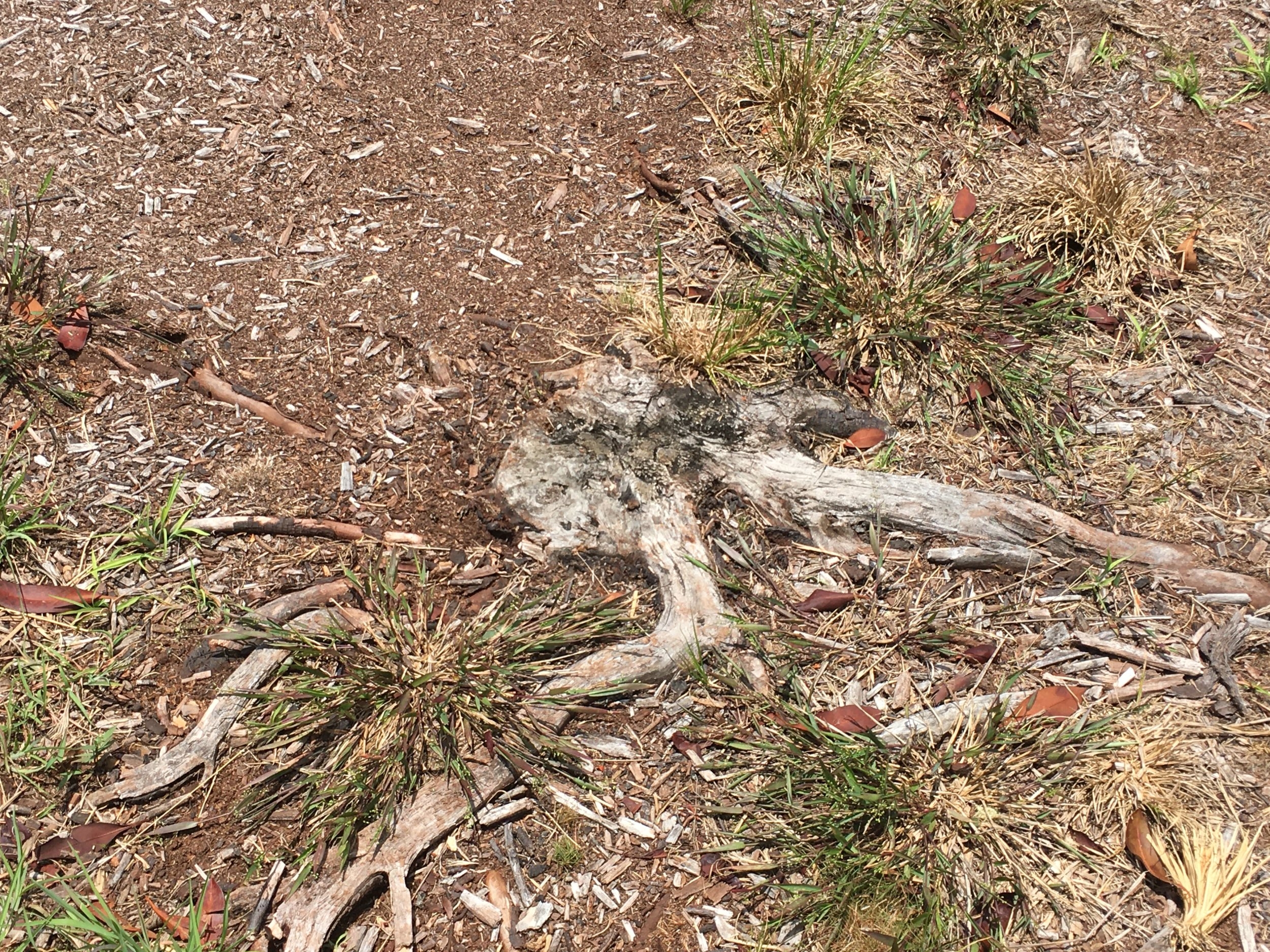

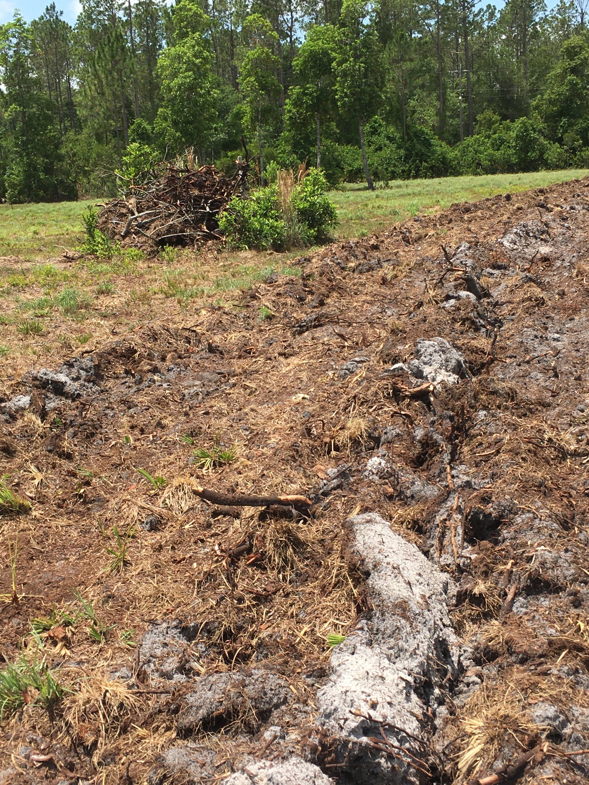

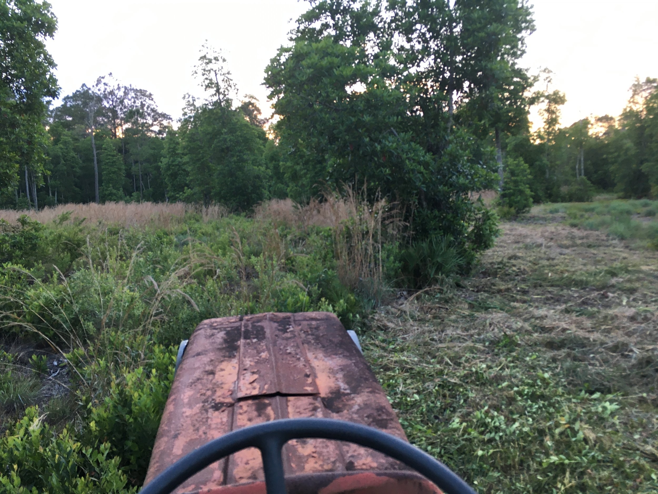

Hi - I’ve been running a seven or eight foot disk over for a couple weekends now. I’m surprised by how soft it is now that it is “opened up”. Still having a lot of sticks, etc but not fowling the disk nearly as often now that I’ve added ~200lbs weight on top it. Got it opened up enough that I think it will take the lime better. I’m looking for a piece of railroad rail or something similar to drag it and hopefully knock down the highest spots. I did have a local dirt works guy look at it to root rake and level (really needs some slopes pulled back and a lot of dirt pushed around to get the run off / grade correct). I’m going to get it as clean as I can by just picking up sticks etc. and as I lime it disc it a few more times before seeding. Thanks for all the feed back

Hi Paul - I’m only out here on weekends- last weekend was working on the new to me dump bed k3500 - there is so much roots and such that are in these fields and a bunch of dirt etc that needs to be moved etc that I bought a old Gainesville city truck. Today I made 1 pass longways loading the bed with debrei - then had to take over mowing xyz from the wife. It was a hot day! I think I’m just going to roll that old truck around and pick the roots etc that the disk dragged up - and next will be spreading lime. I’m in SE Alachua - I shore wish I could find a place to get a lime buggy - otherwise I’m going to use the broadcast spreader on the MF 165 and hopefully load it with the NH 33 loader. IFAS saws 1 ton an acre - I am thinking I’ll hit this first 5 acre with about 1k lbs an acre and then run the disk again wait a bit - then lime it again- and hopefully be able to broadcast sun hemp for this season - it’s getting late in the rain season so I hope it works out. The first disking (maybe 3-4 passes in the same direction) made a huge difference. I’m thinking after I lime it first time I’ll disk it more and hopefully figure a good drag - we’ll see how it goes
