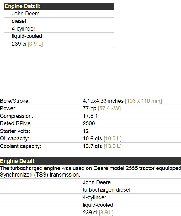

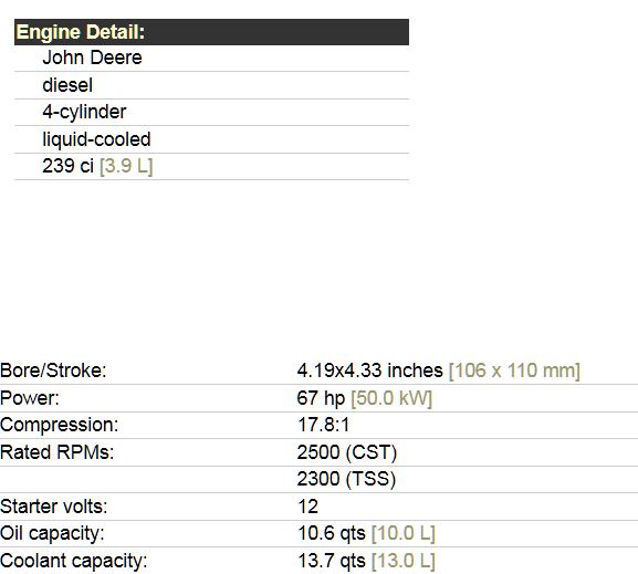

I don't know what brand engines you are referring to when you state turbo'd engines are lower compression than naturally aspirated but that isn't true on JD 239 CID(3.9L) engines as both types are 17.8:1 compression.

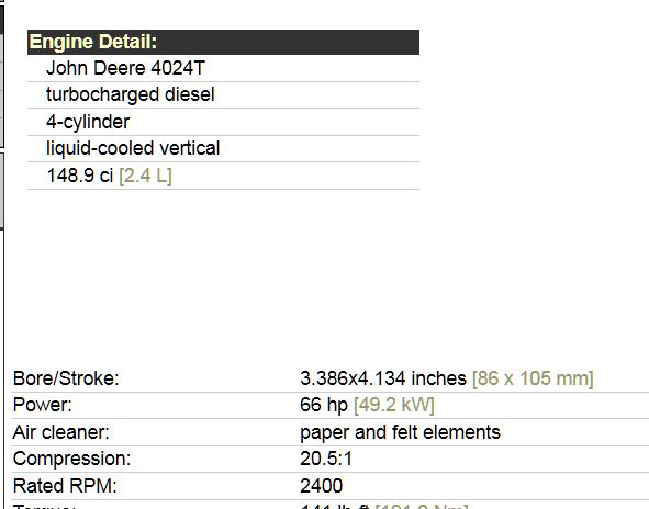

Your 4720 turbo'd is 20.5:1 compression

I was hoping I didn't have to get into the whole compression thing again, on this thread. Here's the quick, down'dirty explanation:
Published engine compression ratios are only a static snapshot of the cylinder volume. It's BDC vc TDC. Actual real "working gas" compression ratios may be very different, depending on many vaiables. Most influential, are valve timing, and turbo/no turbo.
My guess is that the tubo version of that engine has different camshaft(s), or a difference in their timing relative to the crank.

First off YOU ARE THE ONE that stated compression was lower on a turbo'd engine than a naturally aspirated engine not ME. I post 2 contradictory facts they aren't different and you start complaining. Camshaft & timing I'm fairly positive won't have squat to do with compression ratio but I need to do so research to be positive.
