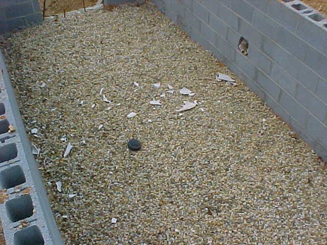

Better you than me, here is a picture of what can happen.
As I stated in my first post pvc can be safe for years but all it takes is one time for a failure. It's even legal for us to test pvc drain piping with air instead of water. Yes I've done it because of freezing conditions and lack of water on the jobsite. Quick 15min test at 5psi.
This is off the Charlotte pipe web site
DO NOT USE CHARLOTTE PIPE
PRODUCTS FOR COMPRESSED AIR OR
GASES
Charlotte Pipe and Foundry Company products are not intended
to be used for distribution or storage of compressed air or
gases. Use of Charlotte Pipe products in inappropriate
applications could result in product failure, serious injury or
death
Gordon
