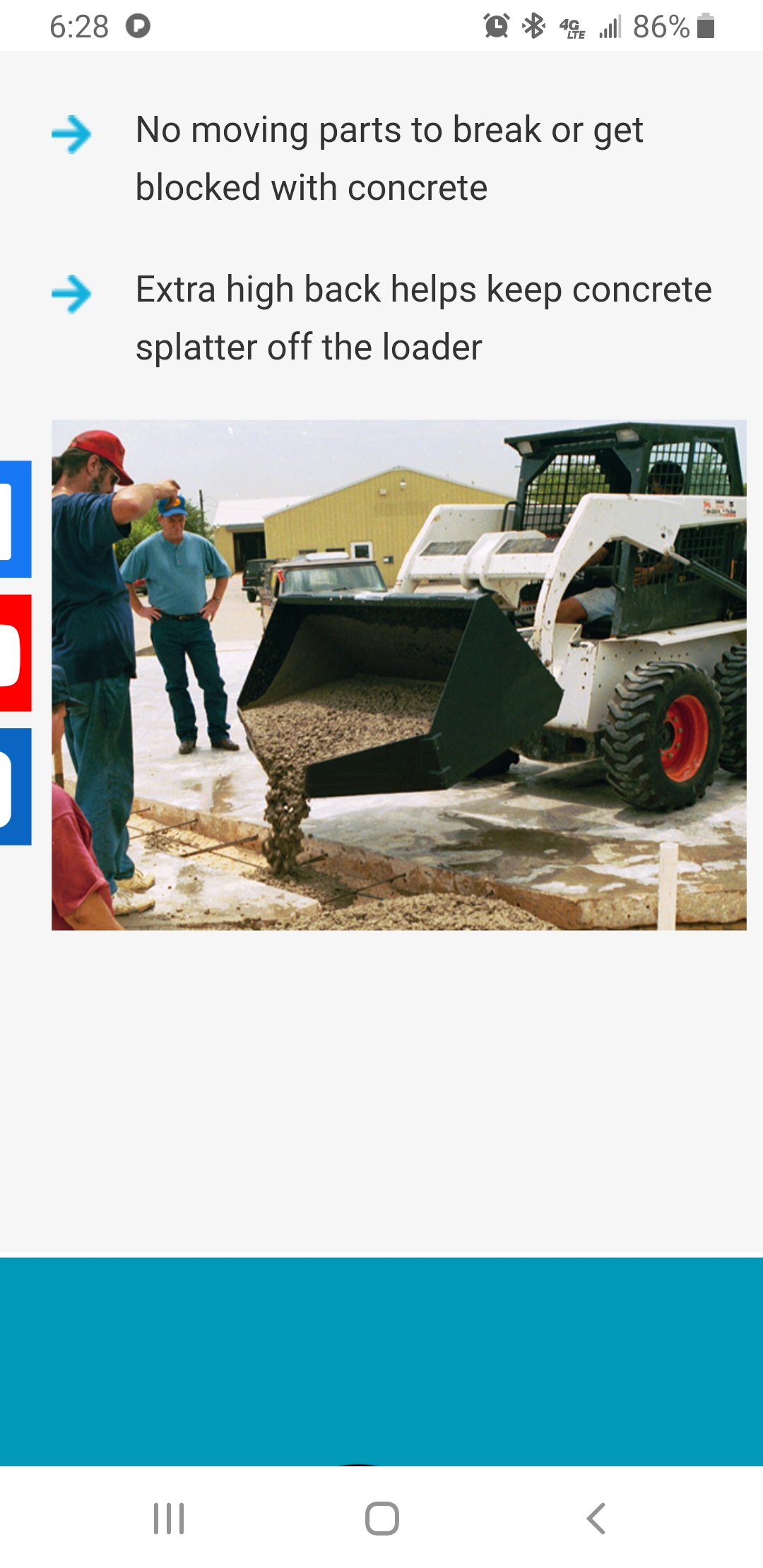

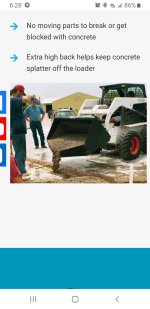

Anyone ever cobble one of these type of buckets up with useing there current bucket as the base?
I have 18 1'x6.5ft sono tubes to fill and can only get a cement truck about 700ft away. It's about $1000 in concrete bags. Last time I checked 3.5yrd of concrete from the truck wasn't $280 a yard.

Wet concrete is heavy. About 4050 pounds a yard. A yard is 27 cu ft. Not many small tractors can lift half that.
Concrete trucks charge a minimum, short load, and standby fees. Call your local batch plant.
Your going to need to make a pretty good road to haul liquid concrete in an open bucket without spilling a lot. Maybe you could just make that road good enough for the concrete truck?
/ Concrete placement bucket #3
You really do not have many options when you're out away from everything. You'll find that "delivery costs" can often exceed the cost of the material. Sounds like your best bet is mixing it on site. The cement plants around here have a minimum delivery of 5 yards, but your area may be different.
Hauling a bucket of cement 700' is going to be very time consuming as well. How much time do you expect it will take? You probably want a retarder to be included if you have the batch plant deliver it. And, don't forget to include a 10% "wastage" in your planning. Your 3.5 yards seems a little short to me. You really do not want to run out of concrete while pouring, I've been on a job where the boss didn't order enough. You can always return extra bags.
And one more thing, if you haul it in a bucket the 700', most likely you'll end up with separation of the concrete - aggregate on the bottom cement in the middle and water on top. Which means it will need to be remixed at the site before pouring into the sonotubes.

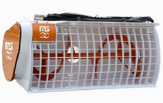

Instead of the bucket in your post, you'd be better off with one of these.

I dont need to haul half a yard at once. My tc40 has a 1500lb lift capacity at 20in. One sono tube will take roughly 5.5cuft and weight 700lbs, half that capacity.
I have alreaty ran up and down this road many time with the tractor and bucket loads of gravel, that's how I built it. A truck and a trailer also will make it up just fine. The issue is how steep the driveway is.
Yes my 3.5yrd estimate is short because that's what the quick calculator said and I would prob order another 1/2yrd and make a sidewalk or small slab form for the spare.
I sure would be if they where free how ever at $3k+ I would be paying someone to do the job before I would buy that and the bag concrete.

Those buckets are for doing small jobs like sidewalk slabs/blocks, where you are doing a small area at once. My local city has one of those buckets on a SS. I've seen it in use, but nothing bigger than doing sidewalk slabs. Most of the time, they just pull the mixer up and fill the square up and smooth it and move to the next.
Best option is to order a pallet or two of bagged concrete, get a cement mixer (tractor/gas/electric) and do it.

I have a concrete bucket on my skid steer. Aside from the obvious that concrete is heavy, it doesn’t dump very accurate. You really need a hydraulic controlled gate on a concrete bucket.
#16
Thank you. Would a second person on the ground with a shovel help?
