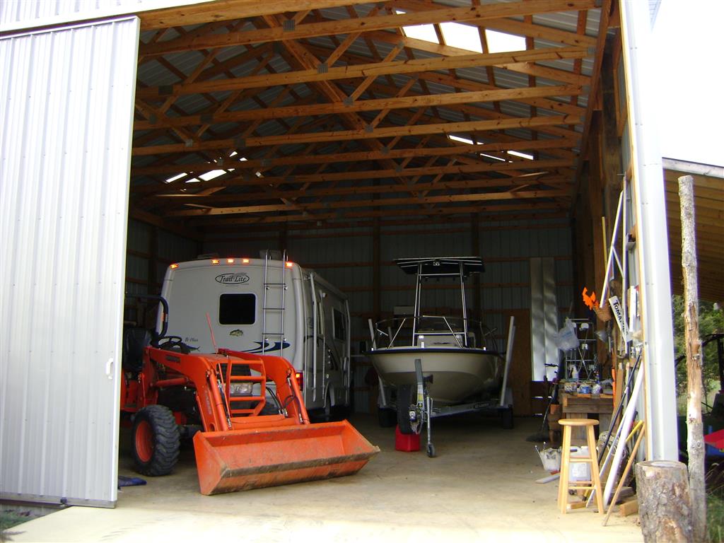

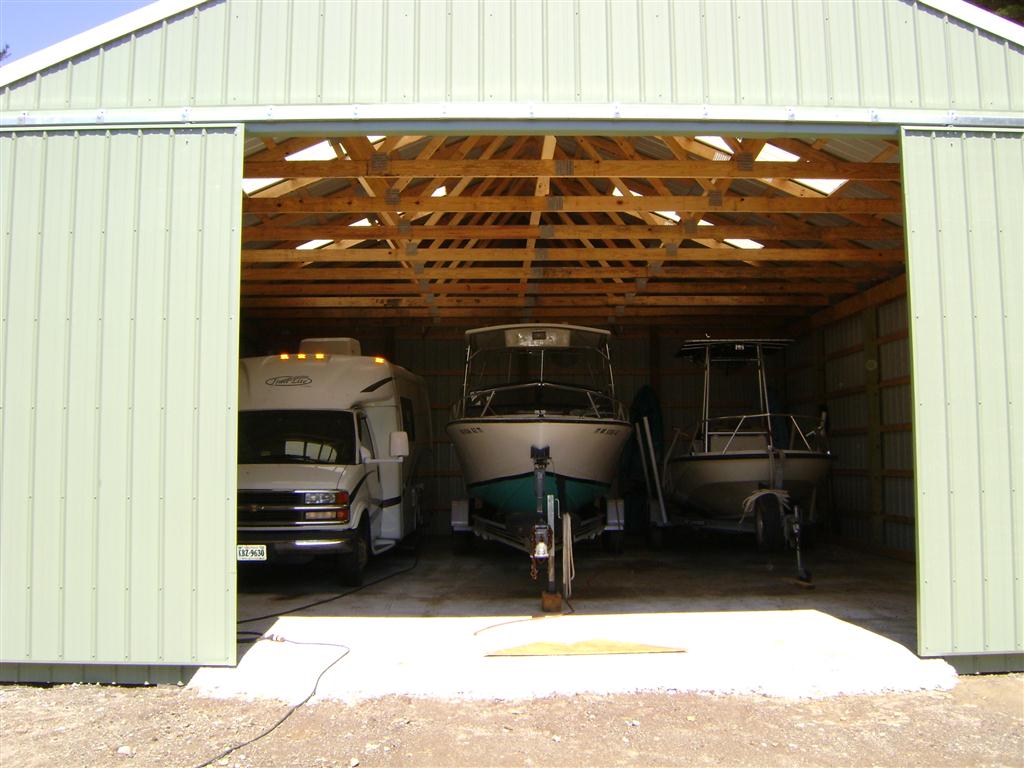

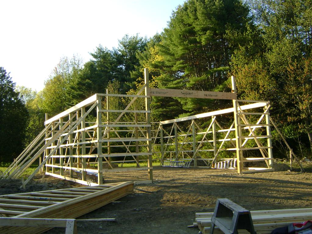

I built two pole barns, one in Virginia in 05 and in Maine in 2012. Bottom line with concrete slab was 20K. 40x32x12. Once the 6x6"s are planted, the framing goes quickly. Siding takes a little longer Maine 2012 019 (Medium).JPGMaine 2012 021 (Medium).JPGhome pics 2010 041 (Medium).JPG. I bought all the materials, hired 3 guys to help construct. The stinkin road to the barn in Maine was only 100' yet it cost 10K. Had to remove 3' of top soil, then replace with aggregate.Wouldn't stop rainingMaine 2012 013 (Medium).JPG

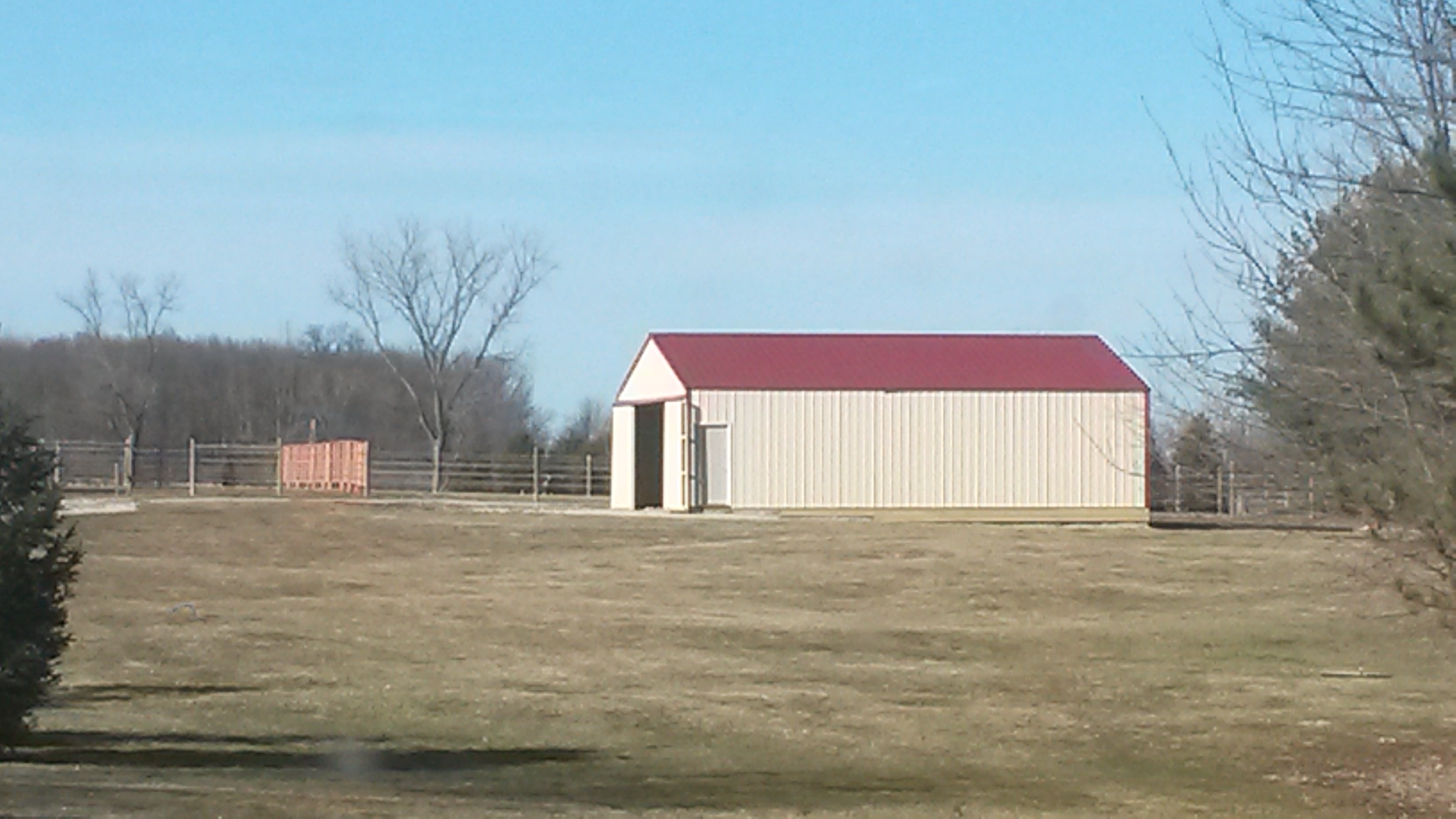

here's mine
