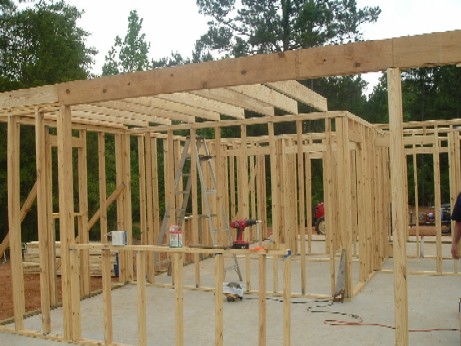

I ordered my metal roofing yesterday from Mueller Inc. Ended up with 26.4 squares plus all the trim in ivy green with a 10ft by 10ft tan roll up door for a little over $4K.
It should be delivered in ten days.
This morning I wanted to finish off the upstairs corner over the stairs. This is a scary area for me due to my fear of heights. I tried to climb onto the perlins and get to it that way, but it was too awkward.
If you look in the upper left hand side of the picture, you can see where I need to build up the end wall. If you look down, you can see my problem. /forums/images/graemlins/frown.gif
Eddie
/ Creating a Workshop & Home
#146
My solution was to find all the scrap pieces of wood that are 40 inches or longer and lay them down to create a platform. I screwed them down to lock them in place.
It was very solid, and worked out well.
Sometimes it takes me a little while to figure things out.
Eddie

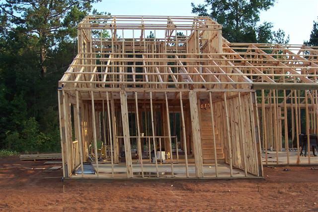

Had a little set back yesterday.
I had orderd my siding to be delivered yesterday morning, and had removed some of the support braces over the last few days. Didn't really think about it, just figured wiht the siding coming, I needed to be ready for it.
Well, around noon yesterday, with my delivery truck on the way, we got us a storm. Weather forcast was 30% chance of rain, which usually means clouds and nothing else. This time it meant extreme gusts up to 50mph!
Delivery truck had to reshedule due to the conditions of my dirt road. Wont be back until Tuesday now.
After it ended, this is what the workshop looked like. /forums/images/graemlins/frown.gif

Without the siding and any sheer strength, I really needed those braces. OOPS
Fortunately I have a little tool for straightening out this sort of thing. /forums/images/graemlins/grin.gif

These angle braces will hold it until my siding gets here. Lesson learned.

Eddie, I guess I am asking the obvious but don't the codes require sheathing under the siding down there?
Up here, before the siding goes on, plywood sheets are used to cover the 2x studs. Code here requires they be used only at the corners to keep the structure from "racking" the rest of the structure is coated with sheeting with thin insulating panels, but on many larger/expensive houses plywood is used to cover the entire structure. The plywood has extreme sheer strength and adds a lot of structural strength to the building, especially in heavy wind load areas.
/ Creating a Workshop & Home #156
Eddie, sometimes when we start thinking ahead....we just ...well, get ahead of ourselves. Hope you get that racked back OK. Use some plywood on those corners.... that will brace it up good. Try bracing from inside, so as not to interfere with the siding. Good luck, and nice project.
sassafraspete
#157
</font><font color="blue" class="small">( Eddie, I guess I am asking the obvious but don't the codes require sheathing under the siding down there?
)</font>
Where "Code" exists, you have to do the outside corners. Outside of city limits there is no code or regulations.
I'm going to use James Hardie "hardipanels" for the siding. They are up to code for sheer strength and according to their website and my supplier, don't require an under layment such as OSB or CDX plywood.
Normally I use plywood on the corners and fiberboard as a filler before putting up brick. This is a bit of an experiment for me using this form of siding.
Eddie
