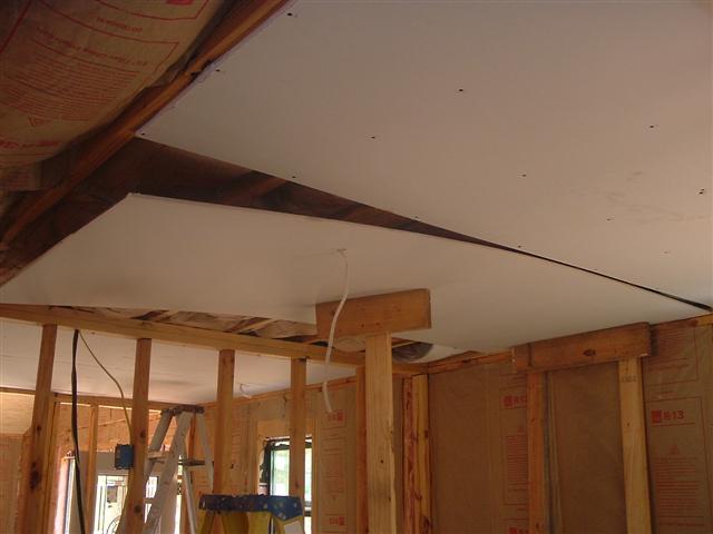

#271
Then I use another 2x4 with a board across the top that forms a T to hold it tight while I screw it in. I like to use screws for ceilings and nails for walls.

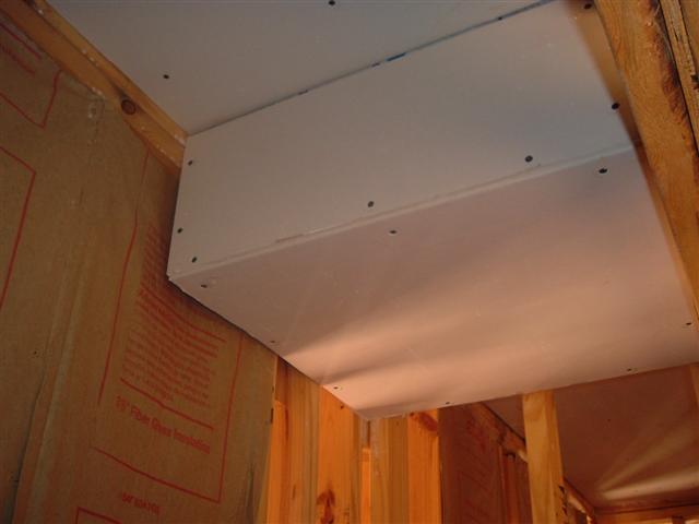

#272
Here's the AC duct in the master bedroom closet. It's just one of the delays that add to the time of everything. Closets are an added pain to do anyways, and this is just a bonus.

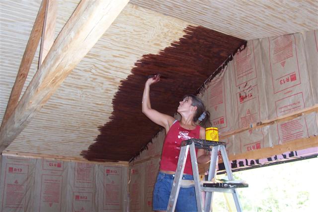

#273
We have planned to stain the ceiling and beams from the very beginning, but never new what color we'd use. It took 7 samples to find the one we liked. Red Oak by Minwax.
Here's Steph getting started on it.

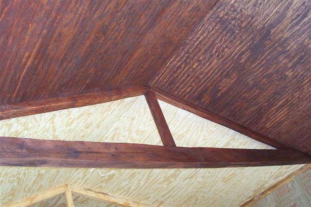

#275
Here's a good picture to show what the ceilings will look like when she finishes. The Red Oak brings both the oak beams and the pine ceiling together nicely.
