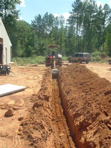

#283
While digging the trench, my front tire blew out. I mean it really blew out. I put a tube in it a year ago, and it just exploded, forcing the tire off the rim. It was so powerful that it ruined the bead of the tire and I had to buy a brand new tire. $81 for a tire, $10 to install it and another $4 for a valve. Oh well.
Here's the trench leading to the house. I only need to be a foot down, so it's pretty fast digging.

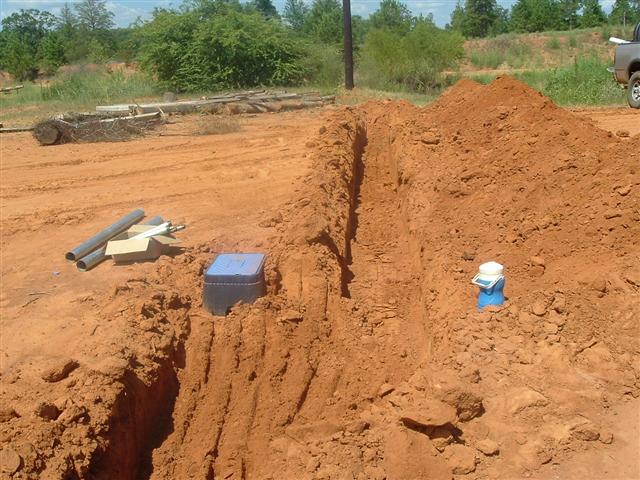

Here's the water meter. I've only seen them in the ground in a box, so it's interesting to see what one actually looks like.
The water district put the PVC fitting on it out of habbit and mentioned it to me after the fact. I need to replace it with a galvanized nipple for the back flow device.

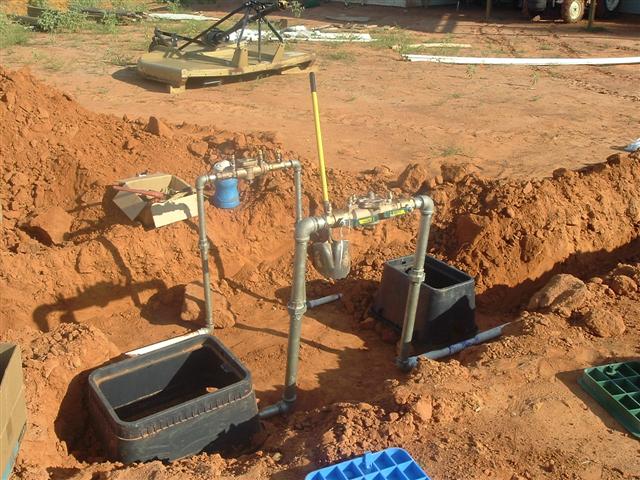

#285
Here's were it gets interesting. I'm familiar with residential construction and single family homes. No real experience with this bigger stuff and commercial applications, so things keep popping up that I didn't expect.
I knew I had to put a backflow device in to illiminate contamination back into the water mains. They do this for every customer. The one they want me to use is called a RPZ and must be installed above ground so it can discharge from teh bottom if there's a problem.
I have no idea how this happens, but understand that they want it installed in a certain way. No problem, tell me what you want and I will do it exactly that way. No thinking on my part. /forums/images/graemlins/grin.gif
The suprise came when I was told I had to have another RPZ for my sprinkler line "AFTER" the first one. Just because it doesn't make sense to me, doesnt' make any difference. If they want it, I'll do it. /forums/images/graemlins/wink.gif
The box on the left is for the meter. Then I went up an 18 inch nipple, a union and then a 12 inche nipple befor bringing it into the first 1 1/2 inch RPZ. I came back out the same way, then transitioned into Sch 40 PVC. I T'd that off down to one inch for the sprinkler line with a brass gate valve. That's int the box on the right.
The 1 1/2 inch PVC line continues to the house while the one inch line goes into another RPZ with the exact size fittings as the first one except one inch. It then crosses the road where it will remain caped until I get back to it.
Hope this makes sense. /forums/images/graemlins/confused.gif

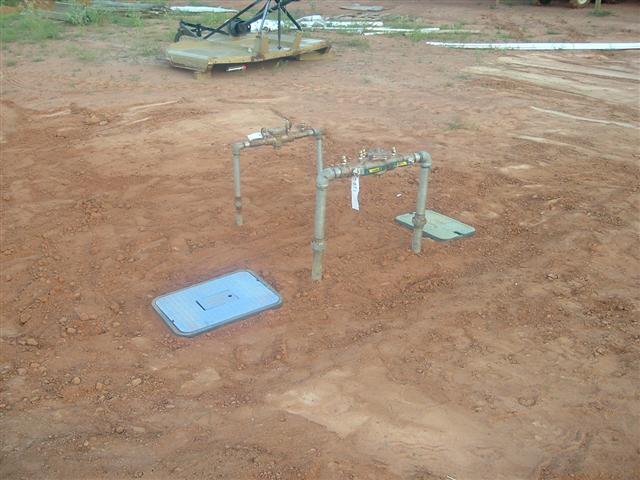

#286
I spent a little time on the tractor, and ALLOT of time with a shovel filling and smoothing. It's nice a pretty now, just needs to be tested and then I'll add building a doghouse to cover to my list of things to do. /forums/images/graemlins/frown.gif

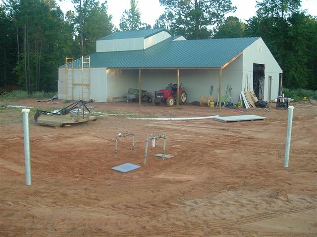

#287
To make sure somebody really wants to drive into it, I put in two 4 inch poles to help them know when they are getting too close.
I'll paint them bright yellow too. /forums/images/graemlins/grin.gif
