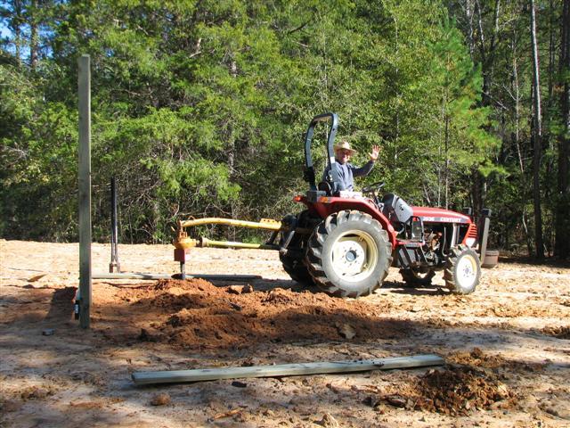

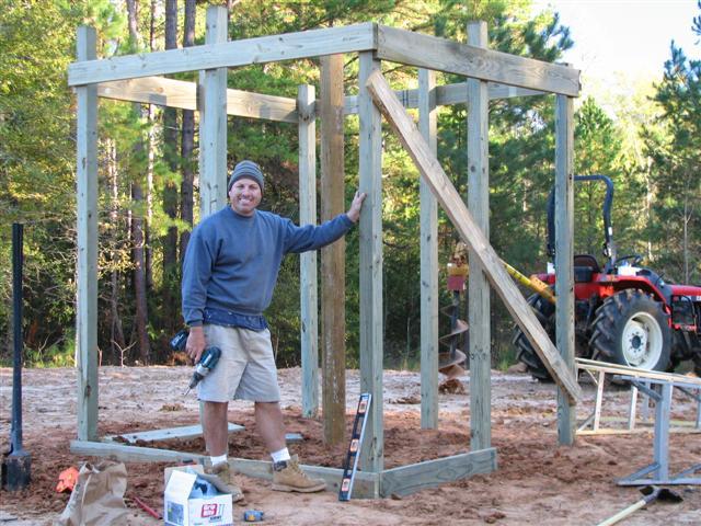

#26
We started building the deer blind by drilling holes and putting posts in the ground. This part of it will be build like a pole barn. I'm paranoid about this holding up and being able to handle any amount of weight from people filling it up when it becomes part of a kids playground when I open the RV Park. Because of this, my spans are all under 4 feet. The middle post is a 4x6.
It's a few hundred dollars more this way, but there is no doubt in my mind of failure under commercial use. That was very important to me in the design.
Eddie

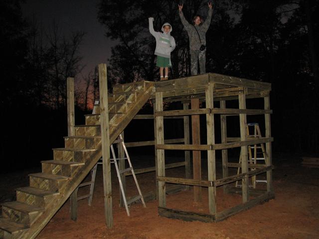

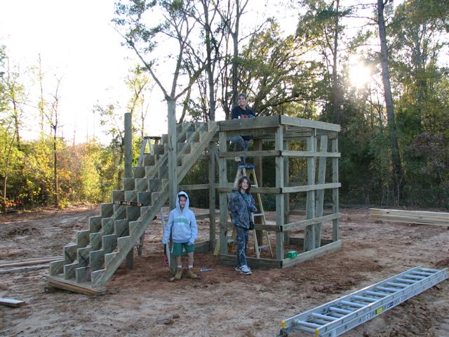

Today we put on the purlins, cut and installed the stairs, installed the floor joists and then glued and screwed the 3/4 PT plywood decking.
Eddie
