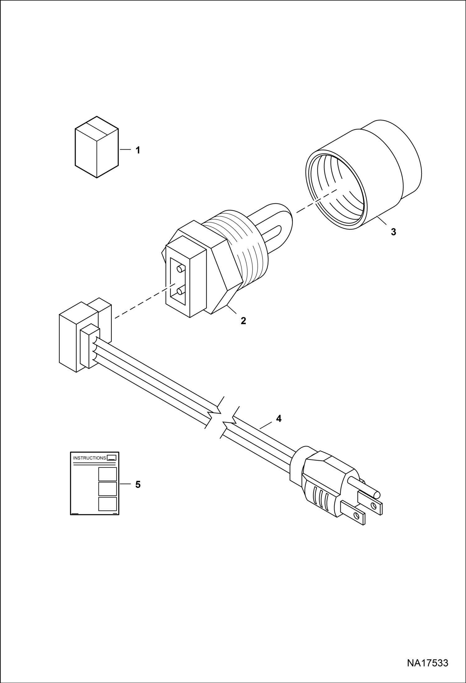

This is my 1st winter in Minnesota with a Bobcat CT2025 (diesel). I've had an old Allis for 40+ years but have no experience with diesels/glow plugs. In my area a lot of times a severe cold snap follows a big snow (e.g.- goes to -20 or so). I am worried my diesel won't start in my unheated pole shed when I really need it. Are the magnetic oil pan heaters worth $60-100? or is there something better? Thanks!

Probably best off with the block heater. My magnet will not stick to my CT 225 pan either I believe it is aluminum.

I am also in Minnesota and have never had a problem with my tractor starting. I had a block heater installed when I purchase it and I always use a diesel anti gel in the fuel.

I plan on getting the block heater by this winter. Mine does start rough in cold weather-lots of smoke-but it does start. In any other conditions, no issues. I think the block heater will be money well spent. Maybe around a hundred and a half $$.

I see part number 7388933, engine block heater, is more like 90 bucks or so, not hundred and a half.
Anybody know-any issues with item not staying in tightly or any such?
