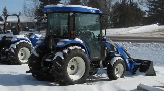

Bought the 3045, signed today! Delivered end of next week;)
I drove, the JD 3520, the MF 1635 and was in the Cab of two different Kabotas and for the money New Holland won hands down. I was really concerned with all the talk about the HST verse the CVT, that is why I started this thread. I tried all the relevant horsepower tractors, going back and fourth, turning while putting the loader up and down as suggested in other threads then did the same with the New Holland 3045 but did it last. I was really happy with all the suggestions on this thread and tried as many as I could, the 3045 was great! One post said that you had to come to a complete stop before switching into reverse but this is not the case. The dealer said to through it in reverse while moving forward as written in the glossy promo literature and I did just that. The tractor comes to a halt then starts going backwards just like reversing your foot on the HST. The only time I had to use the brake was when initially starting up, much like a car when taking it out of park, you step on the brake put the lever forward and away you go. Also the ranges are all push button, no levers to pull for four wheel drive as on the Massey. The 3045 is almost 2000 lbs heavier then the 1643. When shifting ranges on the 1643 MF I had to nudge the pedal to get it to changes ranges.
Anyway happy with all your suggestions and put my money where my ........
lol. I have attached a picture of the 3045, it will take a week or so to get all the addd toys that I am getting with it, I am looking forward to the end of next week.
