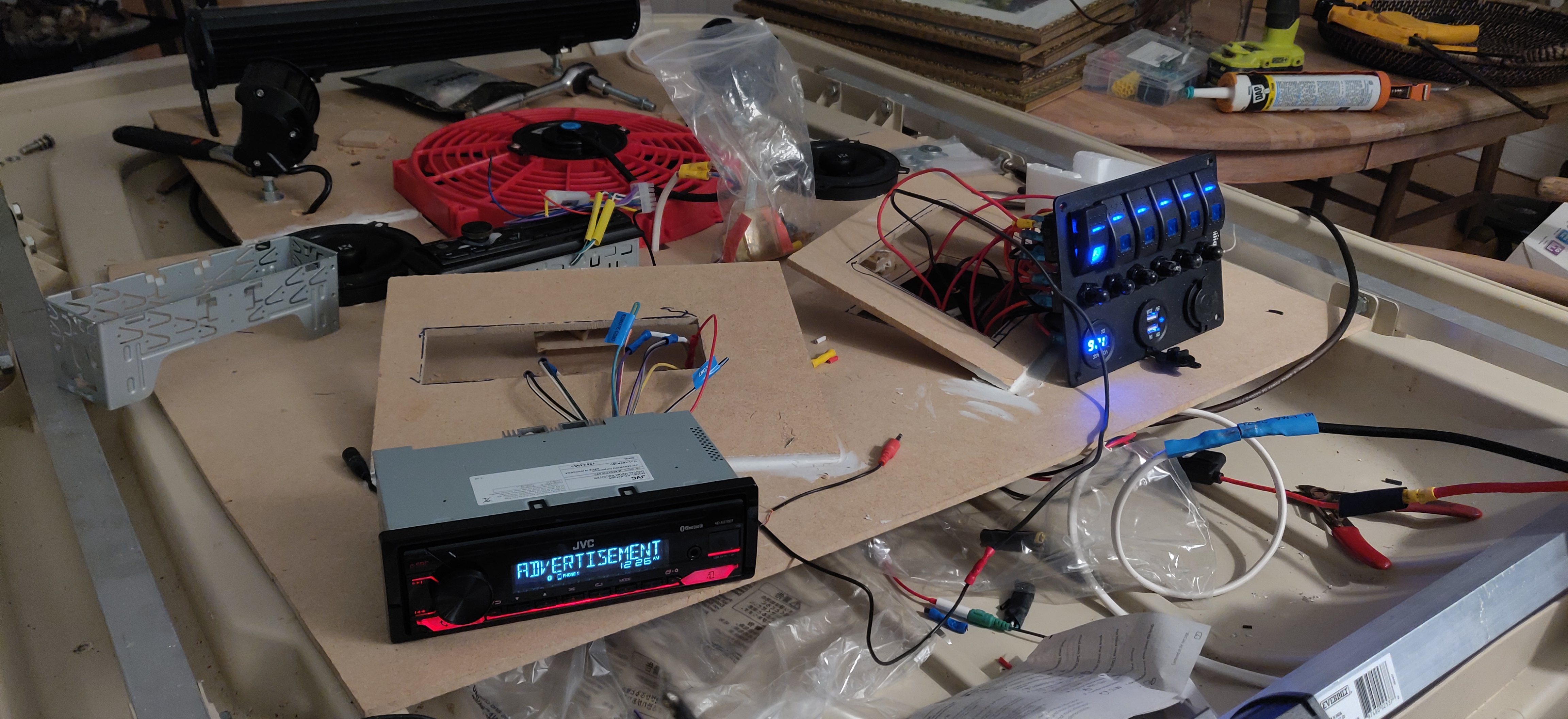

Have you thought about how your going to wire it all into your machine?
/ Custom Tractor Canopy
#22

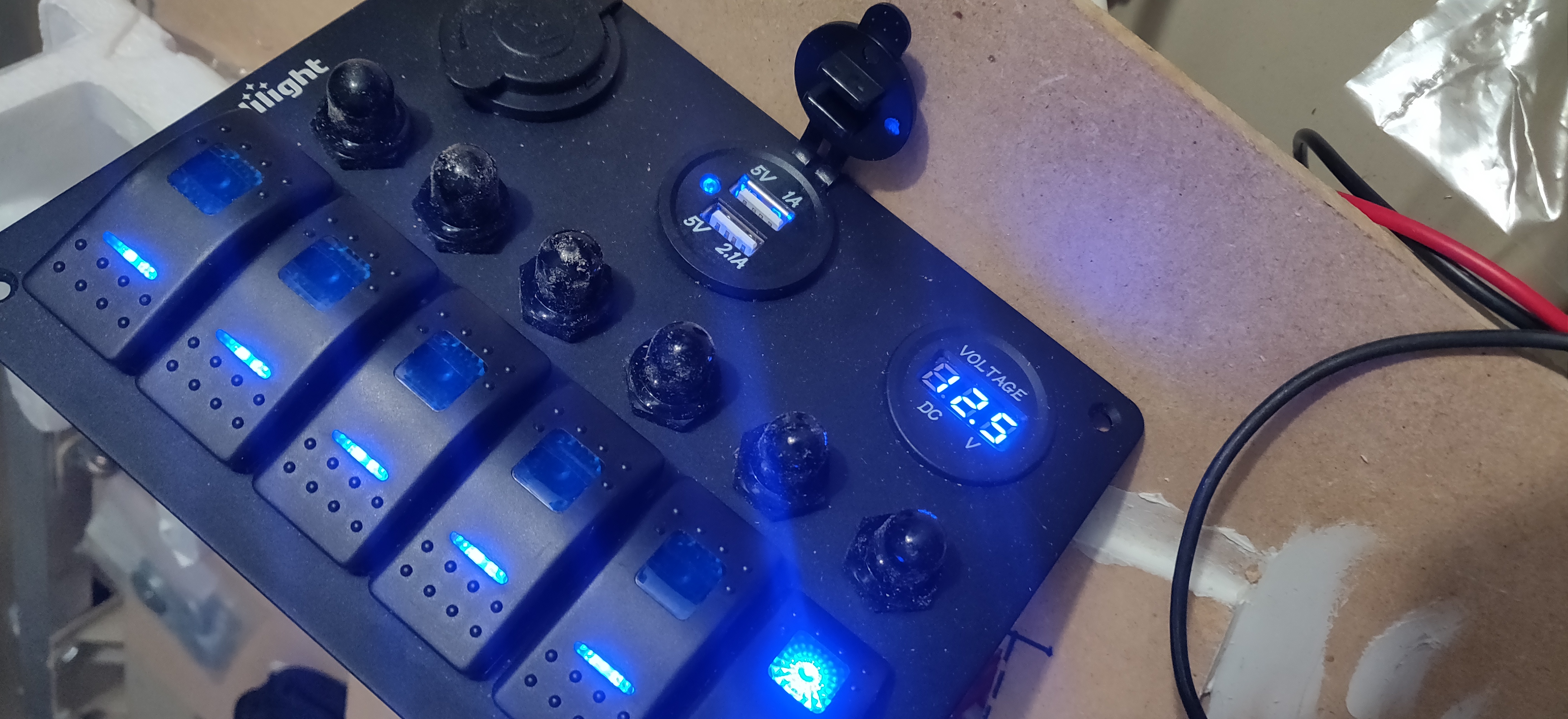

Running an 8 guage wire from the battery with fuse to the back to a toggle switch then to the main toggle panel.
I hooked everything up to a battery to test everything and stress load it. Everything ran good.
8 guage is probably over kill but don't want to overheat any wires or factory connections.
I like the idea of the kill switch so it won't draw juice when sitting.
/ Custom Tractor Canopy #23
I imagine it’ll work just fine. I don’t know Kioti wires there tractors but a few of us on here used the work light connection to power a relay and fuse block. Then everything’s tied to the ignition switch. No key no juice.
#24
I saw that... I may test that out before running it all the way to the battery. Good thinking ��

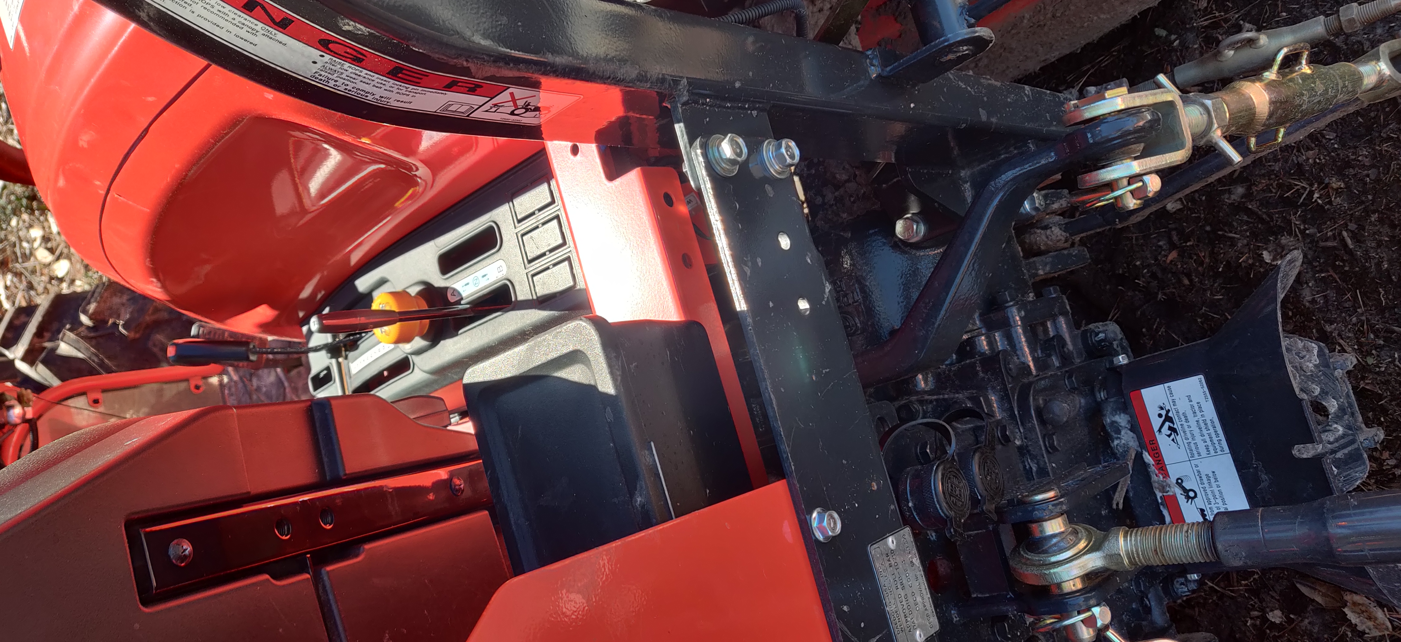

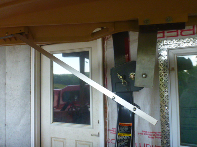

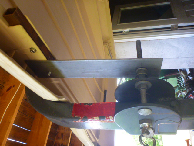

Fortunately, I was able to get some of the mounting legs from the golf cart, they ended up being the perfect angle to mount the canopy. I used some 2" square tube that is bolted to the ROPS, then the canopy mounts fit into them, secured with a couple of pins. These pics are the first mounting using just the u-bolts....
/ Custom Tractor Canopy #26
Here is one with the square tube mounts, you'll have to zoom in to see the details..... I thought I had a close up pic, but can't find it..... The square tube makes it an easy on / off if needed. These pics also show the mirrors I put on.... $24 bucks including the mounting arms. They are for "doors off" Jeep Wrangler.
I like the bent arms. I got to get the top out there and measure out the supports.

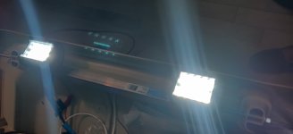

I built this ROPS canopy using 1" aluminum tubing I had lying around, angle clamps, some metal plates with bolts to attach it and a pool float to keep the tarp from rubbing on the bolts. I ordered a custom made waterproof canvas tarp from coversandall.com, a set of golf cart mirrors from Amazon and added some 12V light strips to the front with double sided waterproof tape and wired them to the rear light. It works great and shades both the front and backhoe.
Total cost was $50.00 - not including the aluminum which I had already.

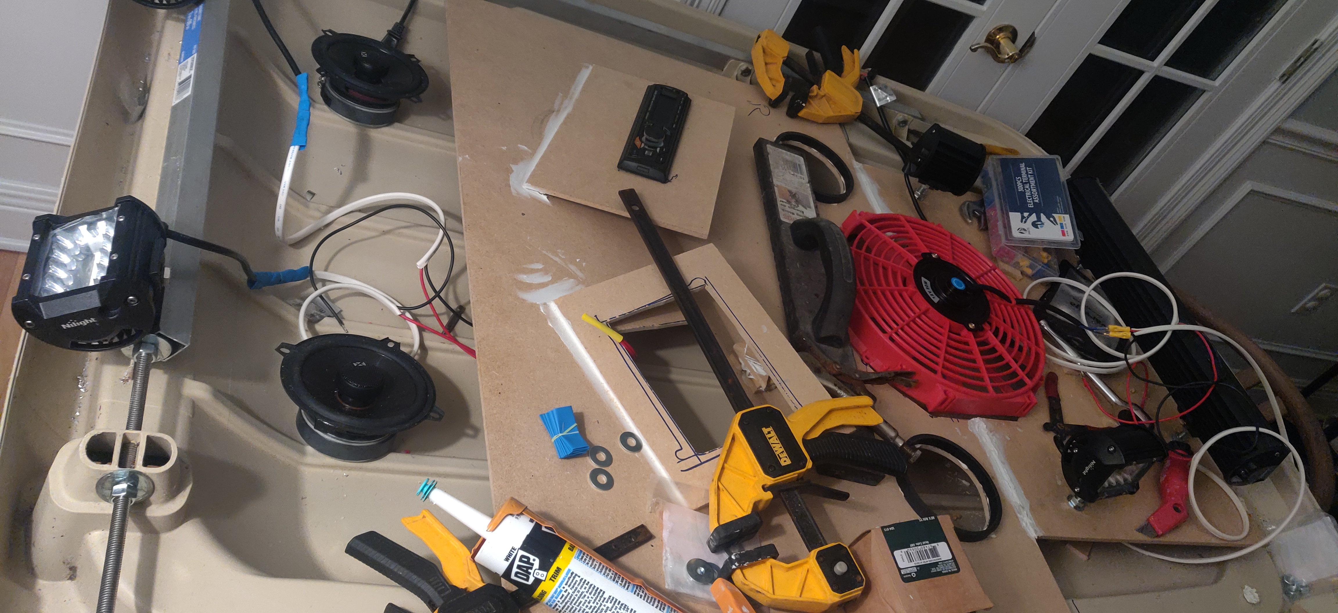

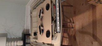

Haha! It's been fiberglassed and I need to do another coat before I Bondo it and paint.
Work has been non stop, spilling over to the weekends.
(Out of the dining room!)

Alright alright alllllright...
It's fiberglassed and now to sand it and sand it and sand it then Bondo and more sanding then bedliner spraying it. Depending on cost, I may have it line-x to add extra strength
