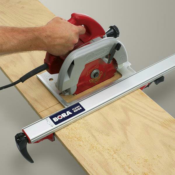

Use an edge clamp. Quick and easy. Mine does angles too. They go to 50"or more.
If you're tired of measuring make a jig to your preset measurements.

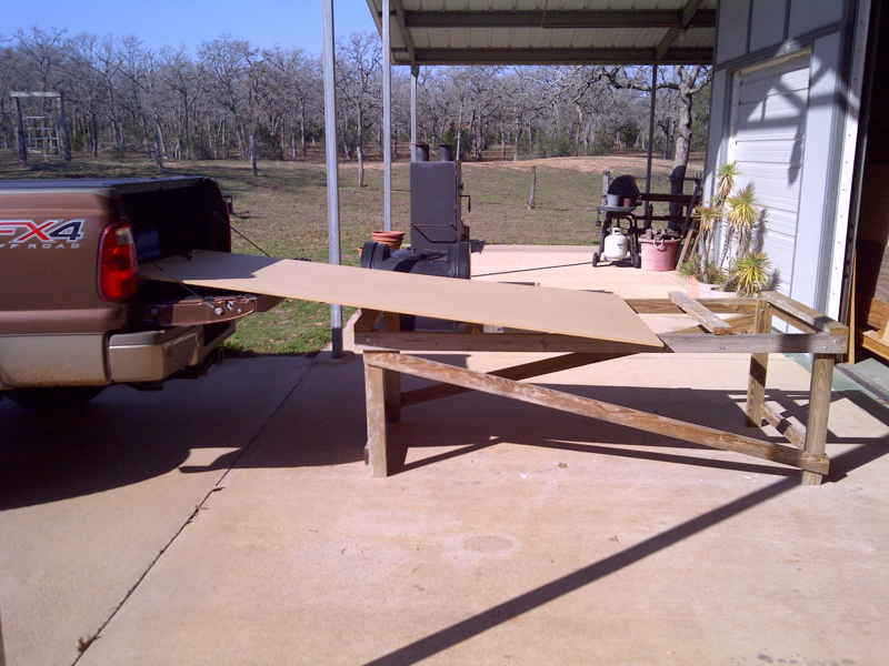

I built a sheet good cutting bench, out of scrap, so I can move full sheets easily from bed of truck to bench. I use a circular saw and cutting guide to get pieces to size I can handle on my table saw.
Here is my sheet goods storage cart.

Use an edge clamp. Quick and easy. Mine does angles too. They go to 50"or more. If you're tired of measuring make a jig to your preset measurements. <img src="http://www.tractorbynet.com/forums/attachment.php?attachmentid=454480"/>
They have them over 96", I have one for ripping full 8' sheets.

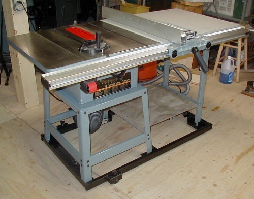

I used to do a lot of site built cabinets and bookcases. I used my Delta contractor's saw which I have had for 25 years, with extended table and special fence. See pic, mine is exactly the same. I put a 4 ft outfeed table and a 4 ft infeed table with formica top over plywood. Spread a little sawdust, your plywood will just about cut itself. That fence is highly accurate, with adjustable gauge, you can cut within about half a hair width every time exactly the same. That is not an exaggeration. I dunno what that setup costs today or if it is even available at the same level of quality. But that solved my 4x8 sheet problems completely. I preferred it over the Delta Unisaw because it can be set up anywhere, easy to take it apart into manageable components and transport where you need it.
I have the same setup. I have a same height catch table as well. Works great. Slide 1"mdf by myself.
