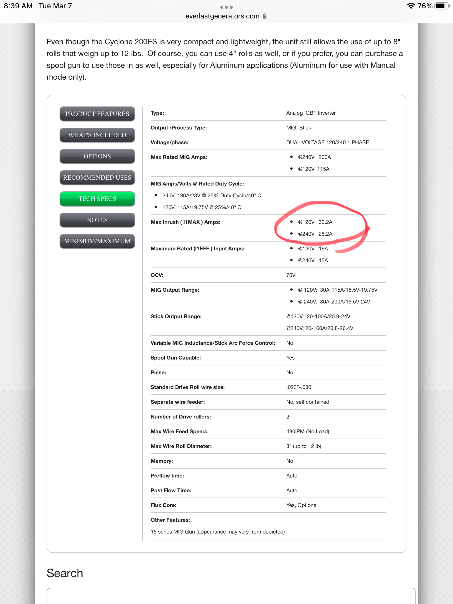

This was copied from the manual. So at 240V 15A input is minim?
Specifications
Product Specifications Cyclone 200ES
Construction Type Inverter (IGBT based, Digital Control)
Input Voltage 120/240V(± 10%) 50/60 Hz
Phase 1 Phase 50/60Hz
I1MAX Current Rating (Inrush Amps) 120V @ 30.2A 240v @ 28.2A
I1EFF Current Rating (Rated Amps) 120V @ 16A 240V @ 15A
OCV 70V
Processes GMAW/FCAW/SMAW
(FCAW requires purchase of optional drive rolls)

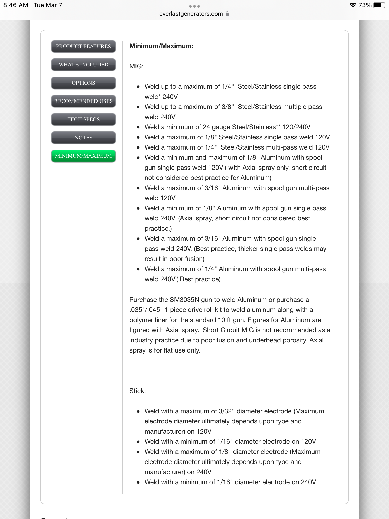

Lots of variables to this question. Depends some on if you want to run the welder at 1/2 or full capacity. I do a reasonable amount of 14ga tubing out in the woods at 16-18v on the welder running off a 6K watt inverter generator. If you want to weld 3/8 you will need 8-10K watts. Big difference between a generator and an inverter generator. You'll get a headache reading up on all the variables. Good luck.

1/4 inch is my max.

If it’s less like the ~ 50% less maximum rated amps, you’ll probably notice it every time you pull the trigger. Unless you are asking less from it. Looks like 1/4” is it’s maximum for single pass. So I’d want the most power to it. If it’s less, it won’t even be able to do that.

I1EFF=15A, is the minimum circuit size that should be provided. 240V/15A is 3600 Watts input (this equates to 5hp power input)
The inrush (surge), I1Max, at 240V/28.2A is 6768Watts peak input (this equates to 9hp peak input).
Again, the motor/gen you pick has to make that horsepower/watts at the rated rpm/frequency, the governor has to react and it has the torque to recover.
Going bigger only hurts your wallet.

According to welding site I frequent (Hobart) the wattage capabilities of the generator should be at least 50% more than demand of welder... The reason being is the rotating mass of rotor in generator is small enough that if welder bog down generator excessively (surge requirement when arc is struck) it drops out voltage and frequency of generator when it bogs down and can not recover needed rpm fast enough to maintain correct power demand of welder and may cause damage to electronics in welder...
IF welder (not surge) draws 18 amps at 240 volts that is approximately 4080 watts.... And if the 50% theory is correct that would dictate a generator that is rated at a little over 7000 watt capable.... Yes its the inrush demand the is critical not the maintained wattage once initial surge is over come... Of course these figures are for if welder is being used at maximum capability, if you are always below welder max, you can dial back generator needs some....
