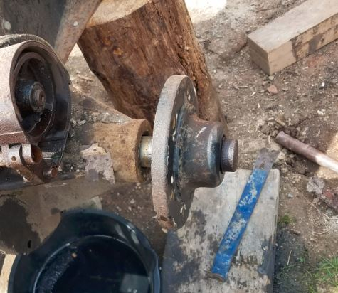

Hello all,
The purpose of this post is to help others. Information posted on this website saved my little tractor, perhaps I can help someone else.
I have a 1992 vintage Dig-It 198T. Purchased it from an estate sale some 5 years ago. 198T is just slightly bigger than Kubota BX25 and in my opinion is a perfect fit for a homeowner.
I've lent my tractor to a friend and received dreaded phone call: "engine runs, but it doesn't go".
My first instinct was a bad pump. However, on 198T the pump also provides power to the power steering pistons, and my steering was good.
Then I've removed the wheels and noticed a large gap at the hub, something was not right...
I've removed the cover, the hole on the left is for the shaft that goes to the differential. The finger points to where my axle has... snapped.
The way the differential works on 198T, if there is no resistance on both sides (for example, if you remove one axle...) no power to anything, the other wheel will NOT spin.

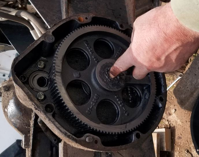

   / dig it 198t transmition problems #38
#1 points to two prongs. If you ever must push the tractor, shut down the engine, and press on those 2. They will depress about 1/8" and will allow you to move the machine.
#2 is your pump. This creates pressure
#3 is your hydro-static drive. This directs the oil
#4 is a mechanical shaft
#5 differential, splits the power to both wheels
#6 is your differential-to-hub axle, the brakes attach to it at the end (#7)
#6 engages a 114 teeth wheel, trading rotational speed for torque.
Another shaft goes from the center of the sprocket wheel to the road wheel.

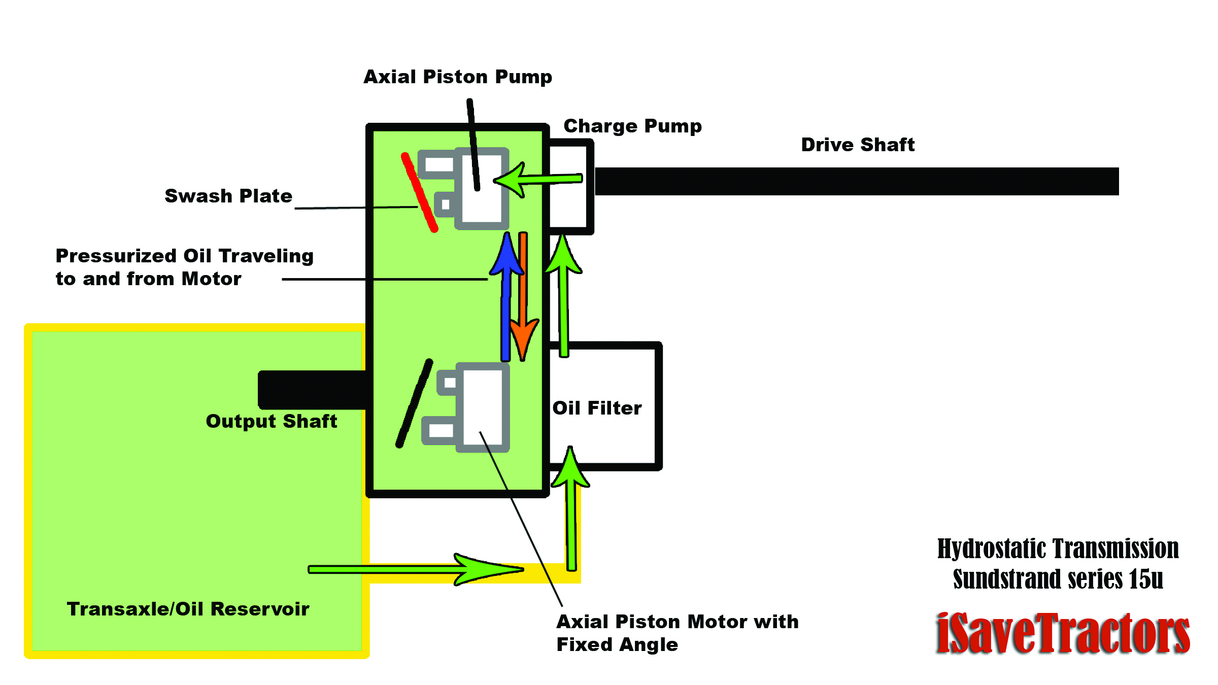

Another website, ISaveTractors.com has this handy diagram:

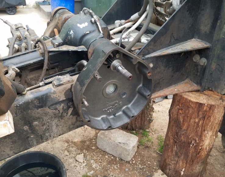

Call Adam at Mission Manufacturing. The number is (812) 385-5061.
Very polite and to the point guy. Have a copy of your user manual, back of it has all the systems break down and all the part numbers.
While removing broken axle... it kind of became a pretzel... I should have just cut off the parts with a grinder. Instead I've tried to push it out on a press. The housing cover (cast iron) cracked. New one was $200. Replacement axle was $130. Axle bearings are $30 (you'll need two). Everything said and done the repair was about $500 in parts. If that seems like a lot to you, remember that the Home Depot charges $350 to rent a backhoe for ONE day.
Adam also knows those tractors. My instinct told me that there should be a bearing in that hole under the differential axle (where the silver cap is), there is not. Also, few part numbers are wrong in the manual, but Adam knows all about that...
