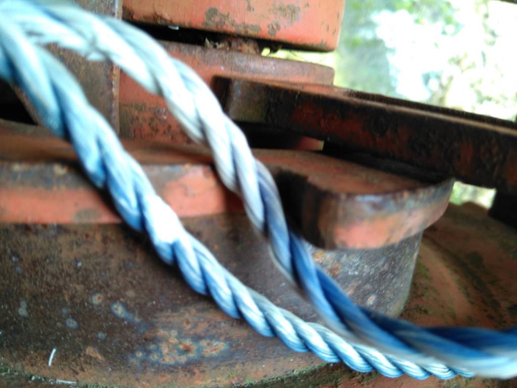

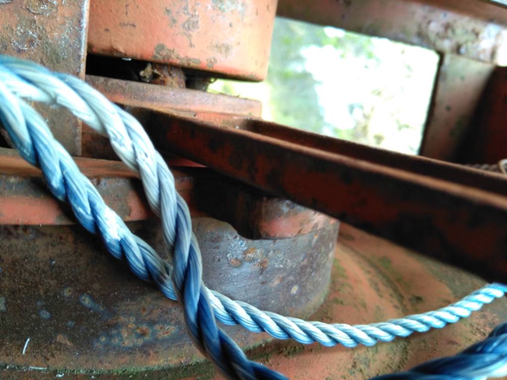

Just pins and holesIMG_20180321_121821.jpgIMG_20180321_121817.jpgIMG_20180321_121757.jpg

Well here's today's update.
Me and a buddy took the setup to the woodlot today for some testing
I feel the testing went well. One thing I cannot figure out is why I cannot get free wheel with the ramp set up. I have tried everything. I have started making a set of ramps on a piece of 3.5" solid bar that I had. The poor little HF bandsaw cut it like a big girl. Each slice is 5/8" thick. The hardest part so far has been to drill the 1" hole, I got them done but the chuck wobbles so bad on my Rigid drill press that I don't think they are perfectly round!
With the last set up with the ramps made from the Lovejoy connectors I had good free wheel of the drum. Today was a PIA having to pull the cable while not only the drum in turning but so is the clutch, chain and PTO shaft ugh!
I think the winch did OK other than that.
Here are a couple pics and a link to a video I made on Youtube.
Take of the day, firewooding. - YouTube

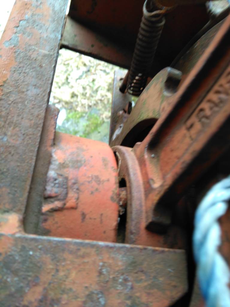

Update for today.
I tore the whole thing apart, found (which I had a suspicion) the shaft was not perfectly square to the front if that makes sense, the rear support (one facing tractor) had to be moved up and over a tad. I hogged the holes out with the plasma cutter and then once I got it all where I wanted it I drilled some locating holes in the pieces so now I can insert a couple of punches and it will be aligned.
Second issue I found was a bad bearing on the sprocket, there are two, the outer most one was sticky so I ordered two new ones from McMaster Carr. I think the reason for the bad bearing is two fold, one it was being pushed on by the little thrust bearings I was using but only pushing on the very center, I don't think these bearings like side loading. And two the DOM tubing it is going into is not perfectly round or proper size. I'll figure out how to deal with that when the time comes
Third issue I found was some galling on the thrust washer at the ramp piece and drum, I greased them but I guess not enough or because the ramp only exerts pressure in one spot it's not spread around. I hope to solve this by installing some high load bronze oil impregnated washers from McMaster. They come in two sizes for 1" shaft, I ordered the larger size, 2 7/8".
My thought here is it will transfer the pressure to the DOM and not the bearing and hopefully the new ramp I'm making will more equally distribute the pressure.
It is a learning experience for sure.
Stay tuned for more updates when I get the parts.
