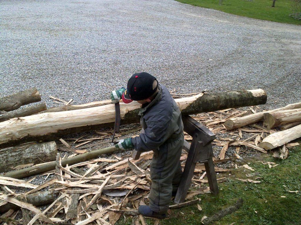

Hi,
Some years ago I built a play ground for the kids out of some oak logs that I collected in my wood. That was a major succes - the children loves it! But I didn't remove the bark and didn't treat the logs with anything, so now it's beginning to rot. Today I collected some new logs (pretty hard - I split some of the logs from end to end - about 5 meters and 40 cm thick - with my wood hammer and a couple of wedges...). This time I'm going to remove the bark, but my question is: what should I treat the wood with to preserve it best? I don't want something poisonous or something that rubs off, because it's for the children. any suggestions?

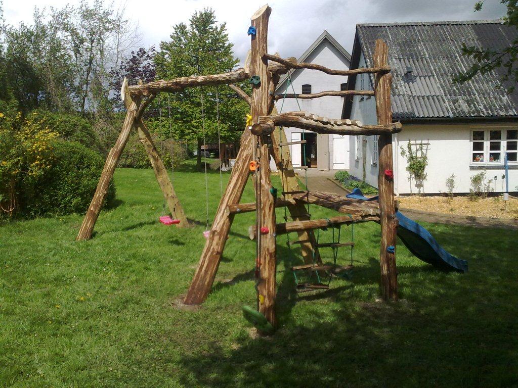

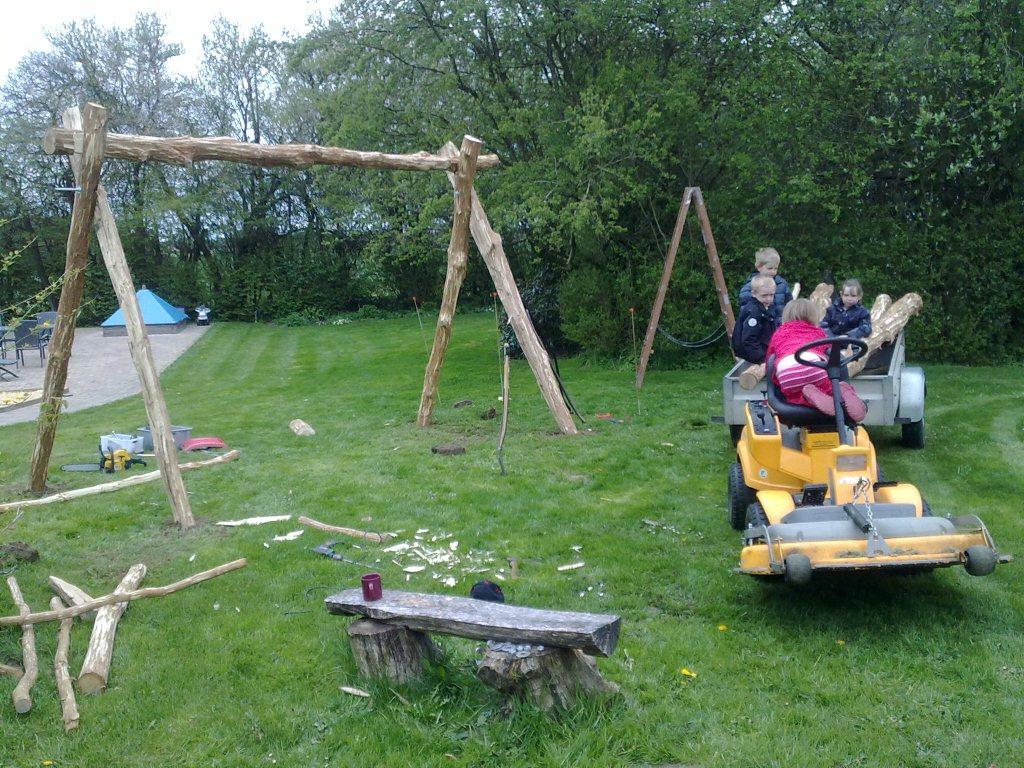

Done!
Now I'll let it dry out over the summer and then apply the oil/wax/turpentine before the autum sets in...
Added a couple of photos for inspiration...
N.B. just for fun I'll calculated the approximate weight - around 700 kg wood - pretty sure it will stay, even in the wind :)

That is a great look, and plenty heavy.
Well Done Sir !
Rgds, Dave.
